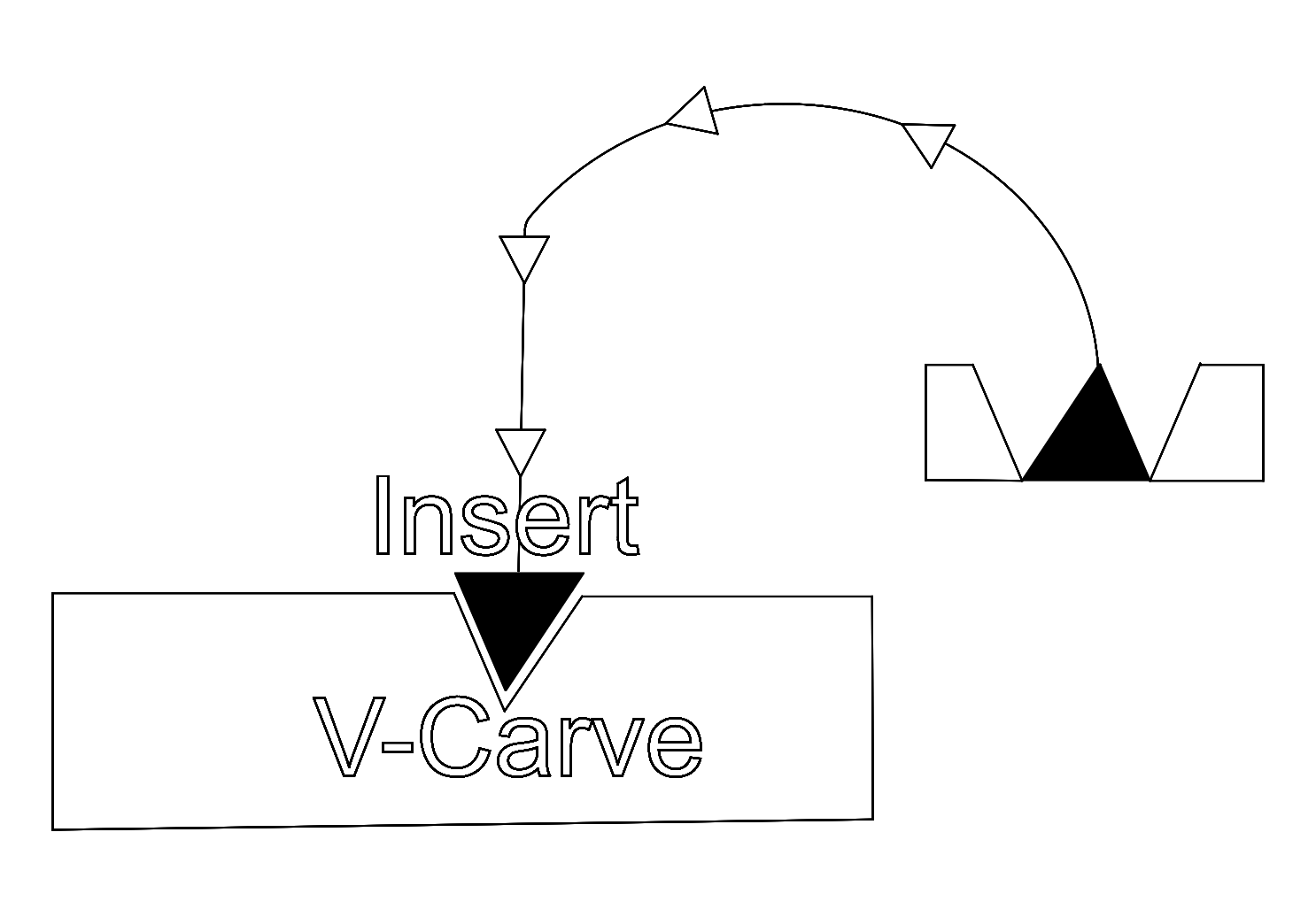

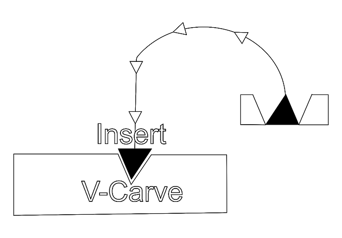

> [@Swayze](#):
> v carve inlays
Just opiniating here, but would not the v-carve inlay insert have to be cut upside down because you can not undercut with a V tool? I cannot even imagine the math to make “automatic” work.
 ![V-Carve Insert](https://forum.lightburnsoftware.com/uploads/default/original/3X/e/7/e7b1bc7dcf157ff8c42e524466179d296fde1223.png)
P.S. Graphic done entirely in Lightburn (MillMage has no “Fill”). 😂
