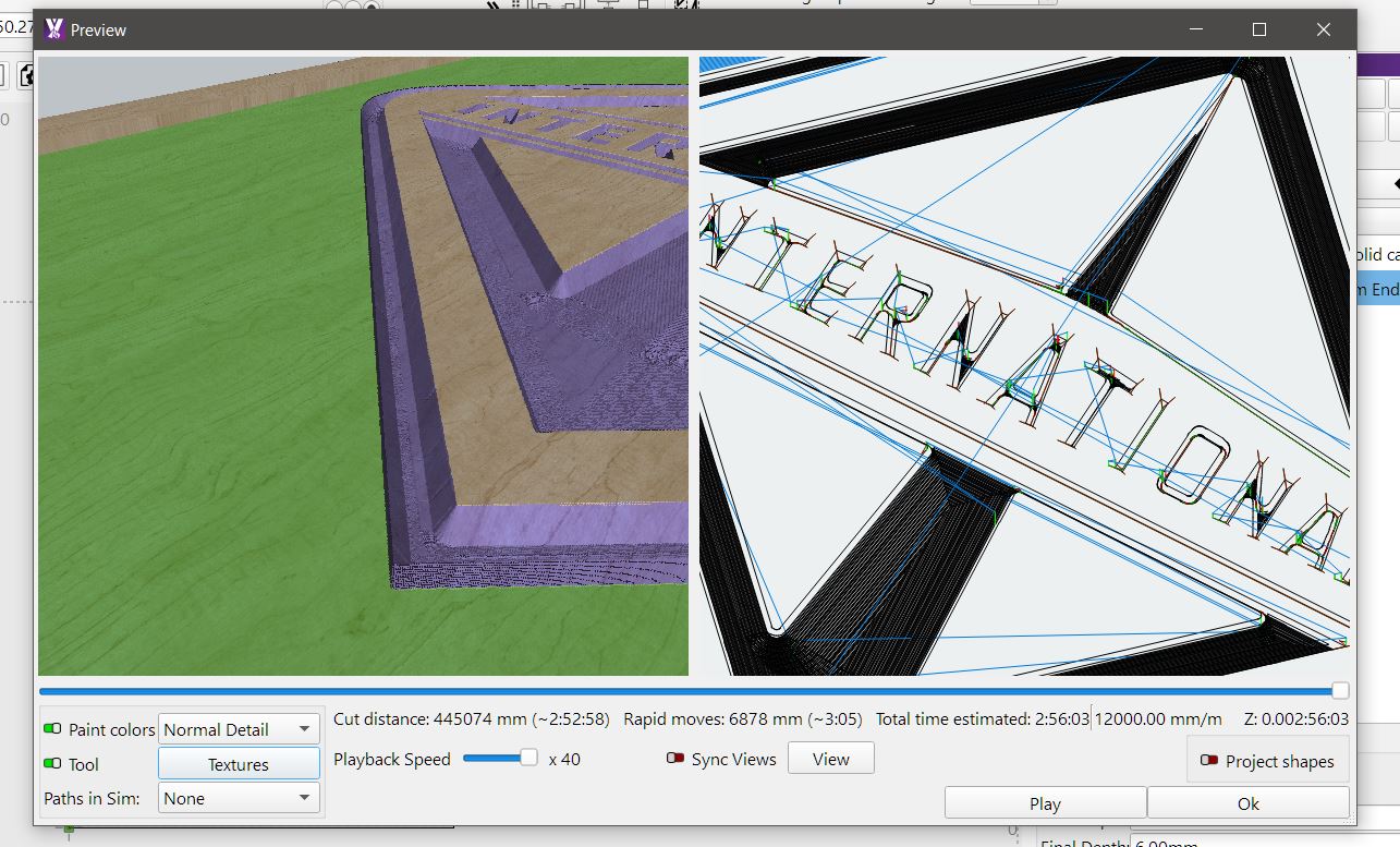

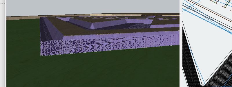

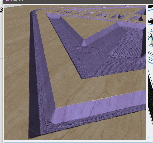

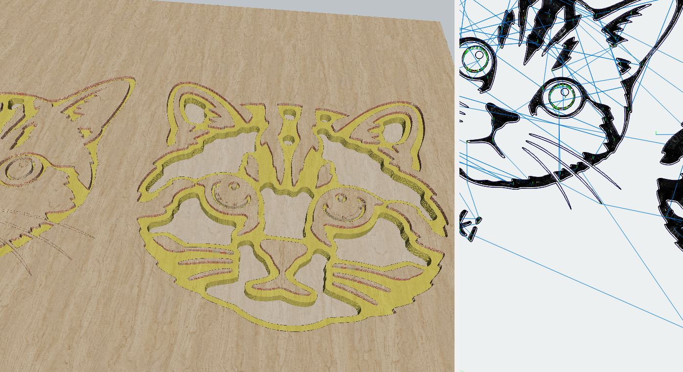

the above is someone that set up pocket operations before V carve, which i had a play with, did take me a while to get my head around what was happening
It was trial and error working out stock to leave to match DOC of V bit so it didn’t remove to much material , hopefully this helps you out
a wish list would be to be able to have a live preview open and edit tool parameters and watch it change , id hate to think what the logistics of achieving that would be, but never say never :wink:
