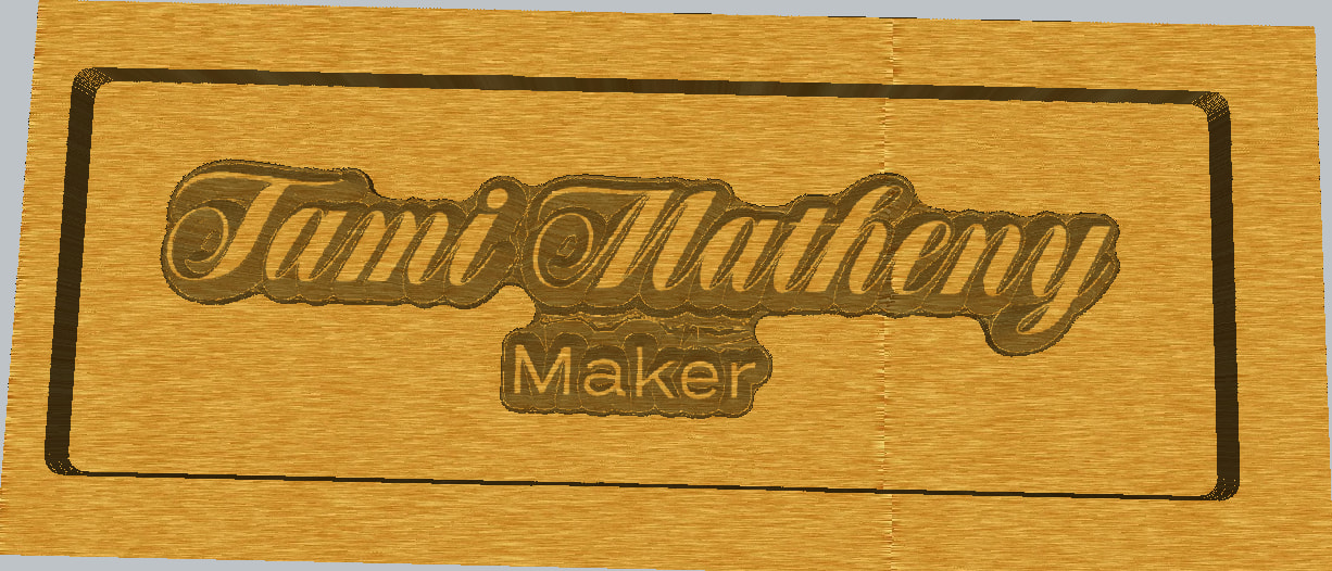

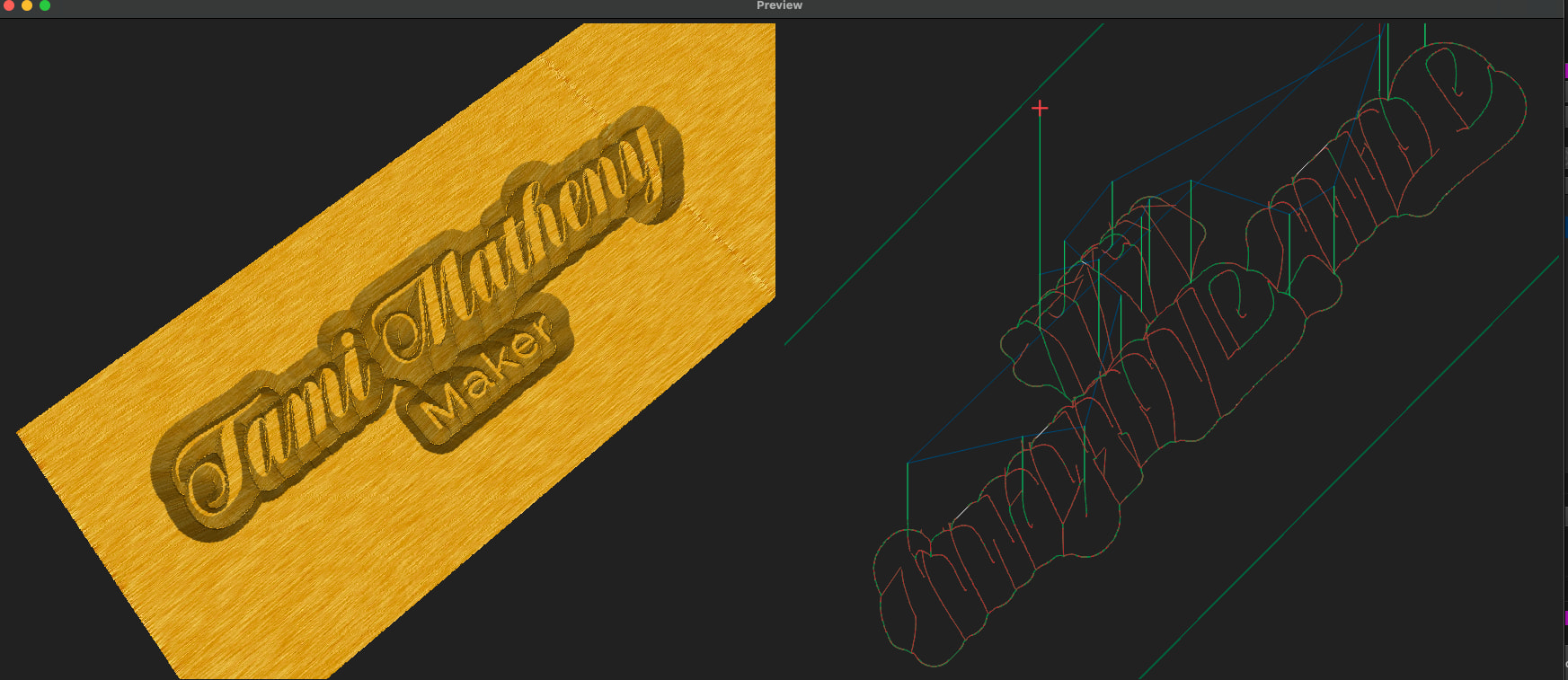

Two problems with V-carving in MillMage Pro 0.9.01:

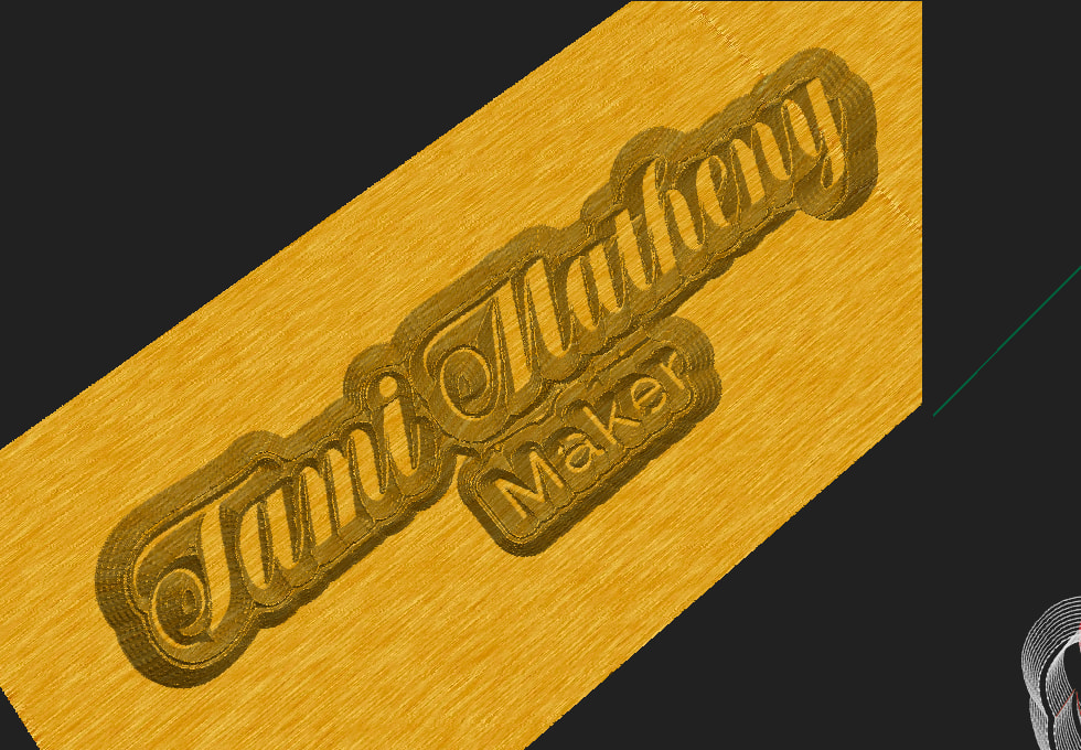

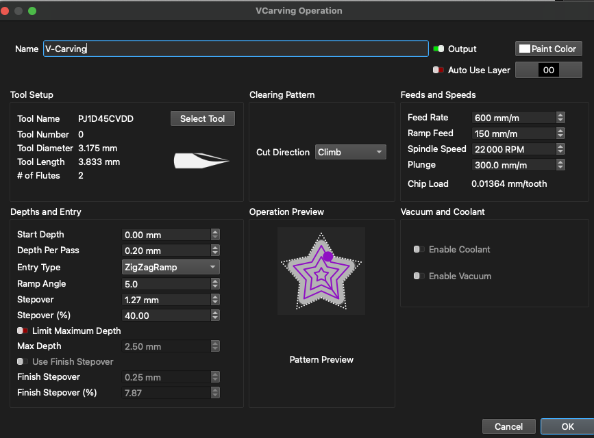

  1. Depth Per Pass ignored when “Limit Maximum Depth” is off. The V-bit goes straight to full depth.

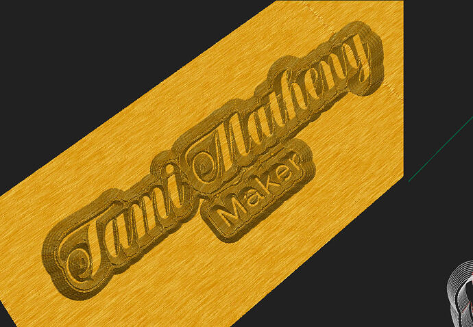

2. When Max Depth is on (in my case set at 2 mm), Depth Per Pass works, but the render and G-code are cut in wrong areas (see below letters truncated,T, a and e).
Paths are closed. File attached.
Is this a known bug? Any workaround?
Thanks in advance!

Both of these issues are now fixed, and should make it into the 9.02 patch tomorrow. Depth per pass is supposed to be respected, and it shouldn’t cut across your paths like that.
Thanks for the quick turnaround. Good to know both issues were bugs and not something on my end. I’ll test the 0.9.02 patch tomorrow and let you know if the Depth Per Pass and the toolpath cuts behave as expected.
