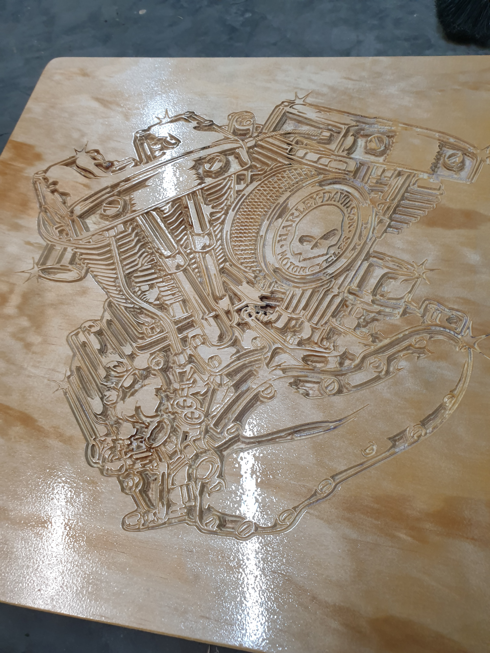

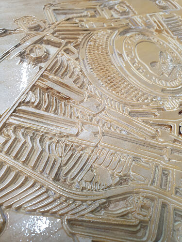

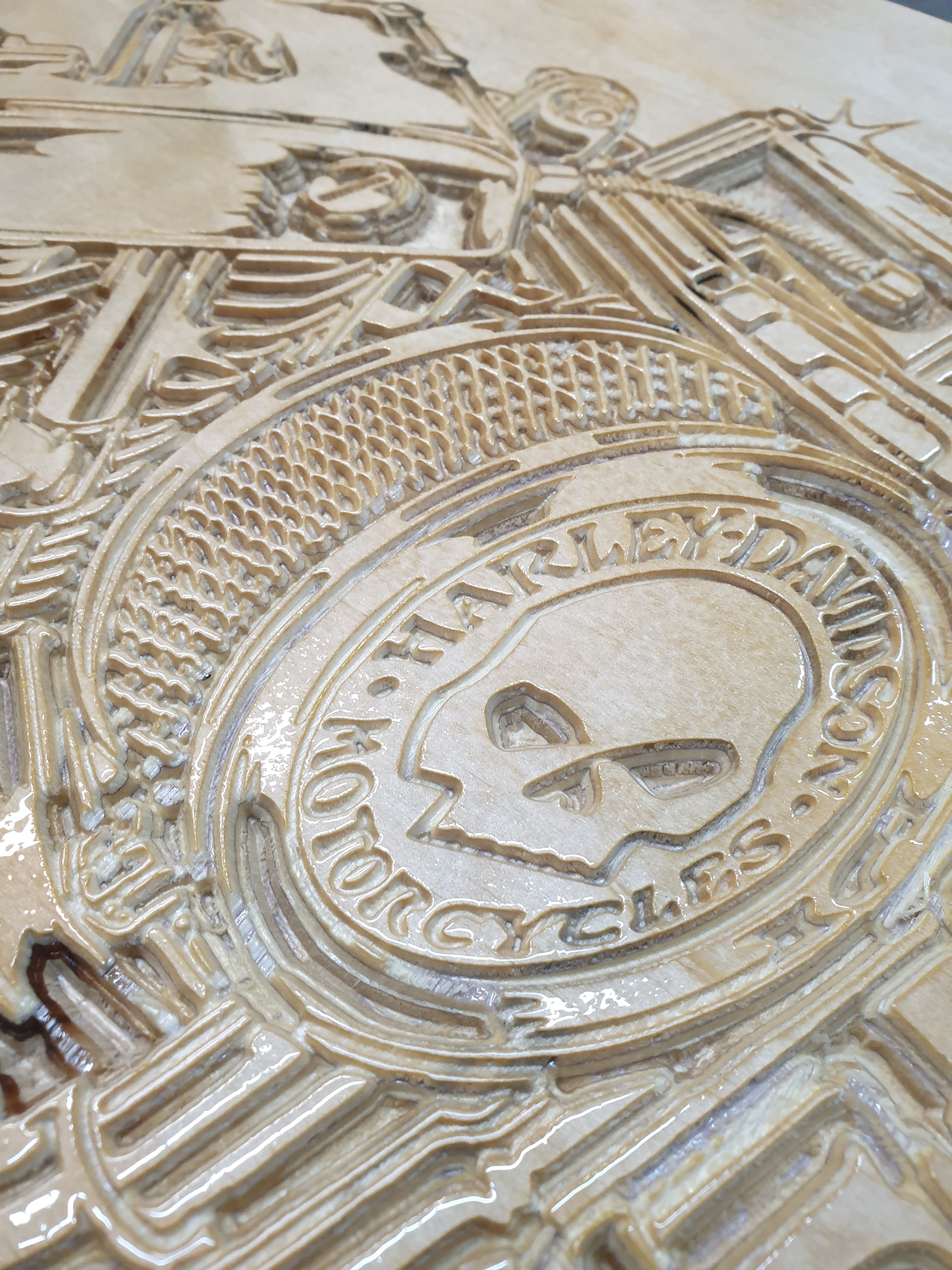

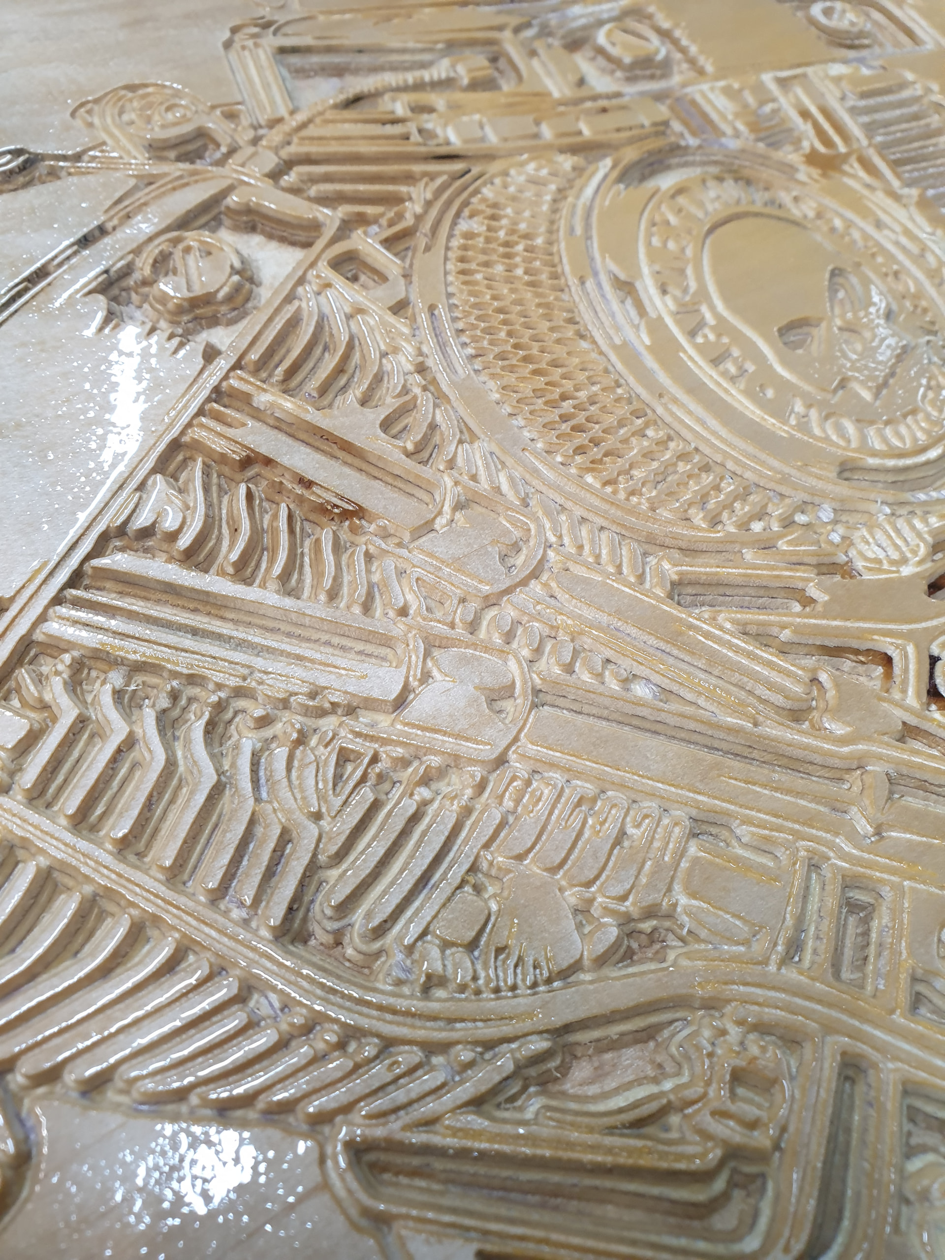

V carving detail is insane :)
probably not in the right section, but had to put this up
so stoked at the detail
3rd go at v carve the drawing is 400 x400 mm
took nearly 4 hrs with a 60 deg bit , the v carve never skipped a beat
going to air brush all the detail to make it pop

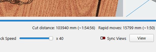

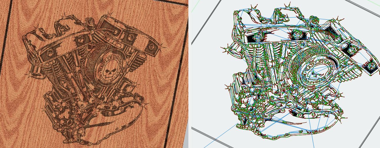

the one thing id like to get closer is simulation time, the one above said 2 hrs to do, it took 4hrs ?
i even clicked read from controller but doesn’t seem to change any numbers

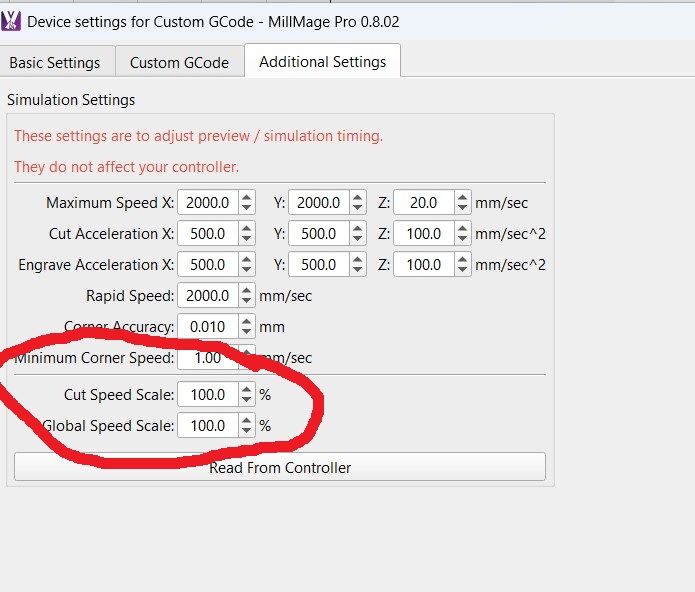

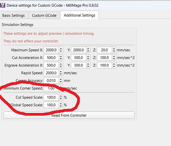

Try adjusting these little gems…
ok will give that a go
If you click ā€˜Read from Controller’ (and have a GRBL controller connected) it should pull the values directly from the machine and make them as accurate as possible.
My projects were estimating 20%-30% less than actual (reported at the bottom). I was underestimating ā€œlaser timeā€ in my billing calculations. Once I found those settings, my estimates (Preview) and total run times are within a few seconds. Call it the Sculpfun SF-A9 S/Nxxxxx Correction Factor.
I did try that but didnt see anything change , i have a v1 enginnering board running fluid nc grbl

great job is that chrome spray …looks so real
pat
no its a 2k wood sealer , sprayed it 1st before airbrushing detail , that way i can wipe off excess as i go as i reckon sanding would take off some of the detail
