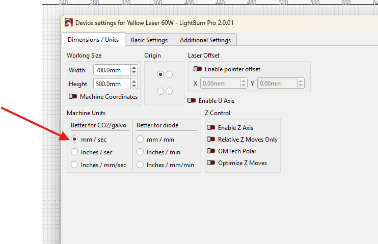

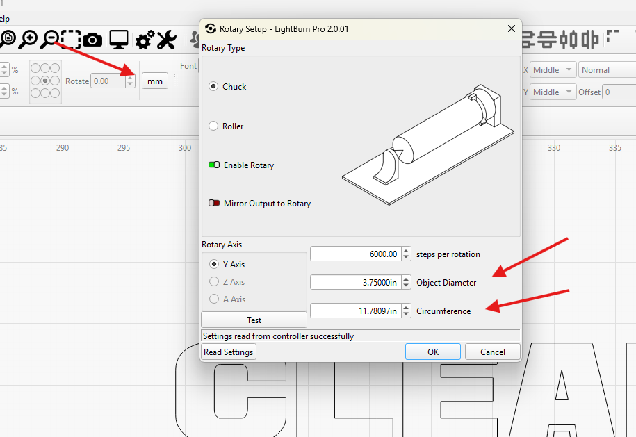

Since the 2.0 update the rotary settings on my c02’s don’t follow the unit selection (mm/in). The rotary menu is stuck in inches and wont switch to mm. Any thoughts?
I saw this as well I went into my galvo settings configuration and there is another spot for changing the units in there if you haven’t already found that.
So i tried changing this setting to mm instead of inches/mm and that changed the rotary setting back to just mm. Just weird because previous to 2.0 the in/mm selection button on the main page swapped it back and forth.. I wonder if the devs dissociated it on purpose, or if it was an unintentional change? No complaints really as I always use the rotaries in mm regardless if I’m designing in inches or mm.
I just received my CO2 and updated L.B. I no longer have that window. What do I need to do to select the chuck style rotary? Thanks
