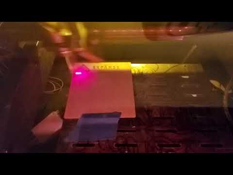

Sorry for my late response, been away from home for a bit.
I’ve done more tests, The GCODE is good, the servos/etc, are all good. The best idea I have is that somewhere between the gcode and the voltage leaving the board, there’s an issue.
Here’s a video of how it acts with Lightburn. Notice how the much it slows down whenever the laser is on. Also worth noting, it does this even when power to laser is completely turned off.
(Might outta mute before playing this, GoPro added some loud music.)
[![](https://img.youtube.com/vi/0kLF3hgC7yk/hqdefault.jpg "Lightburn speed change 2") ](https://www.youtube.com/watch?v=0kLF3hgC7yk)

Notice that everything is as smooth as butter.
I’m confident it’s not the grounding. I have a grounding block for the house connected to both earth and building ground, it’s about the best ground you’re going to find on a residential property.
It’s also consistent on a per-design basis. Every error repeats itself exactly every time you laser that design. The exception is that sometimes there is a line shift with Lightburn, but I think that’s due to the uncontrolled slow-down of the axis.
As far as connectors, the only connectors I have to move to change boards are the 4 connectors between the Lightburn board and the OEM board. The connectors are fine.
I think I’ve got a bad board. If there is any test you would like to me to conduct to confirm or rule it out, please let me know. Thanks.

What _image_ settings are you using? The board itself has no problems at all running 300mm/sec, but image processing requires massive amounts of GCode, and Smoothieware isn’t super fast at processing those. The stock, default, older firmware caps out at about 80mm/sec with the default image settings (0.1mm / 254 DPI). If you are running the new Cluster firmware, that increases to about 240mm/sec (3x faster).
So far in your posts you have only mentioned speeds, and nothing about DPI settings, image options, etc, and those absolutely matter. Higher DPI means more GCode commands to process, and the board maxes out (with Cluster mode) at about 2400 instructions a second, or 800 without.
