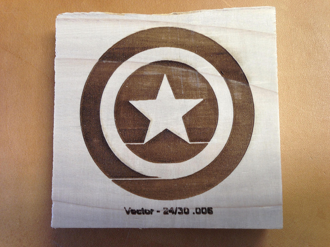

Hello,
I have a piece of vector art that I have brought into Light Burn as an image and as a vector. The image version burns perfectly but the vector version of the same art skips lines, and I haven’t been able to figure out what’s causing that.
I have noticed that it tends to happen in circles, almost like the start and end position of the circle don’t quite meet. Here are some details about the set up I am using:
Otur 20w, firmware v1.34, Light Burn 0.9.16, GRBL-M3 “1.1e or earlier” profile
That looks like you’re using ‘Flood Fill’ and when it moves to complete the other side, your Y axis is a bit loose, so it doesn’t quite make it. Turning off ‘Flood Fill’ or resolving the mechanical looseness will fix the issue.
