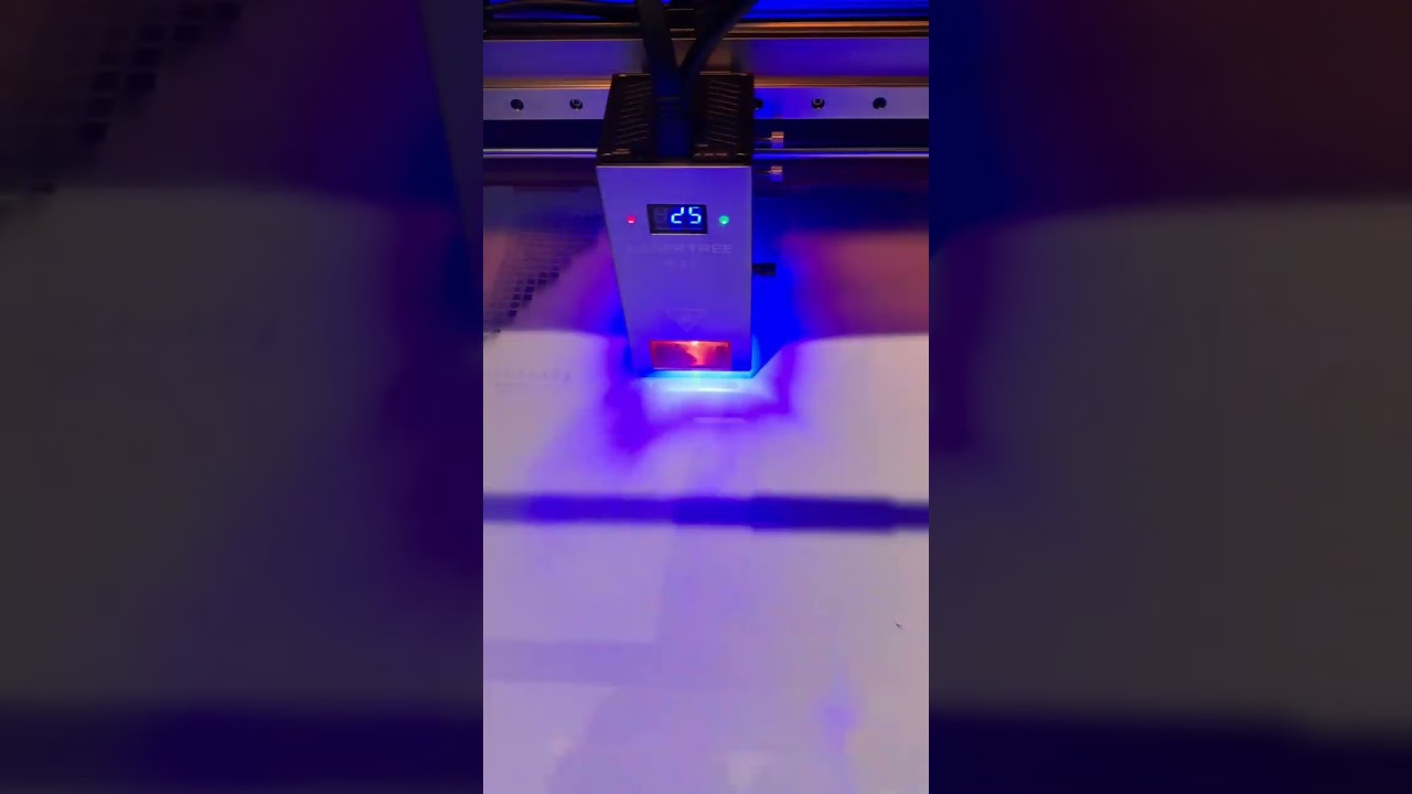

Hello, I recently acquired a Lasertree K1 30Pro, and during material testing I observed an issue: the machine seems to pause slightly whenever transitioning from one vector to another.
In LightBurn, the progress bar remains frozen until the current vector is fully completed, only updating once it moves on to the next. This behavior creates noticeable pauses between vectors, which not only affects the smoothness of the operation but also results in longer actual processing times compared to the preview estimation.
For reference, I also own an AlgoLaser where this behavior does not occur. Could you please clarify if this is expected behavior on the K1 30Pro, or if it may indicate a configuration/firmware issue?
I also have a short video to better illustrate this issue if needed.
Thank you in advance for your assistance.
EDIT: After redoing some tests, I noticed that the issue doesn’t actually happen when switching between vectors, but rather when switching between layers in LightBurn. If I have 10 vectors using the same layer settings, everything runs smoothly. But if it switches to a layer with different settings, that’s when the delay occurs.
