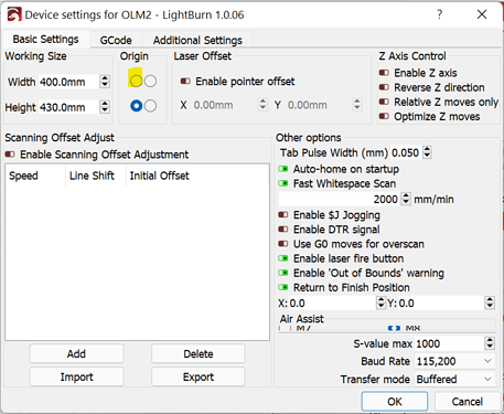

Does your Atomstack A10 Pro home to the front left (close to you and to the left) of your machine? Then likely you need to set machine origin to front left in Edit->Device Settings. Should match this:
Please check and confirm. If you change this, you will need to “fix” any designs that were done previously. However, the machine should now move “correctly”.
Check jog controls in Move window. Left should go left, right should go right, etc.

Let’s take this one step at a time as I’m having a hard time following. And the machine translation isn’t working well. Please try to write clearly and simply to make it easier. Please reply to each question.
  1. Can you confirm location of homing? Is it front-left?
  2. Have you set machine origin to front-left in Device Settings? Please send a screenshot.
  3. Do you jogging controls work in Move window? If not, please describe exact behavior. What do you do, and what is the reaction?
  4. In laserGRBL, do jogging controls work as expected?
  5. in laserGRBL, do burns come out in correct orientation?
If this works in laserGRBL, it should be easy to get this to work in LightBurn. The only change should be in Origin setting in Device Settings.
