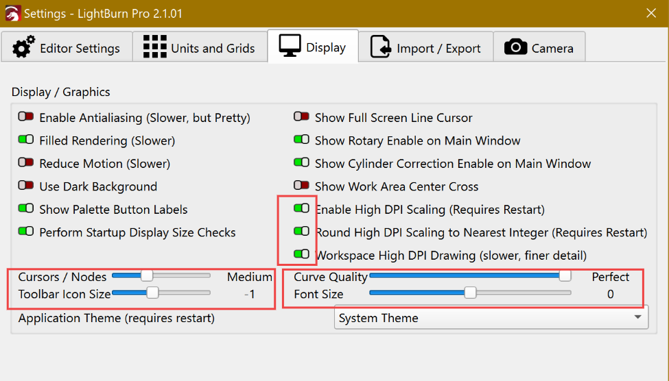

You have here a few options that you can try:

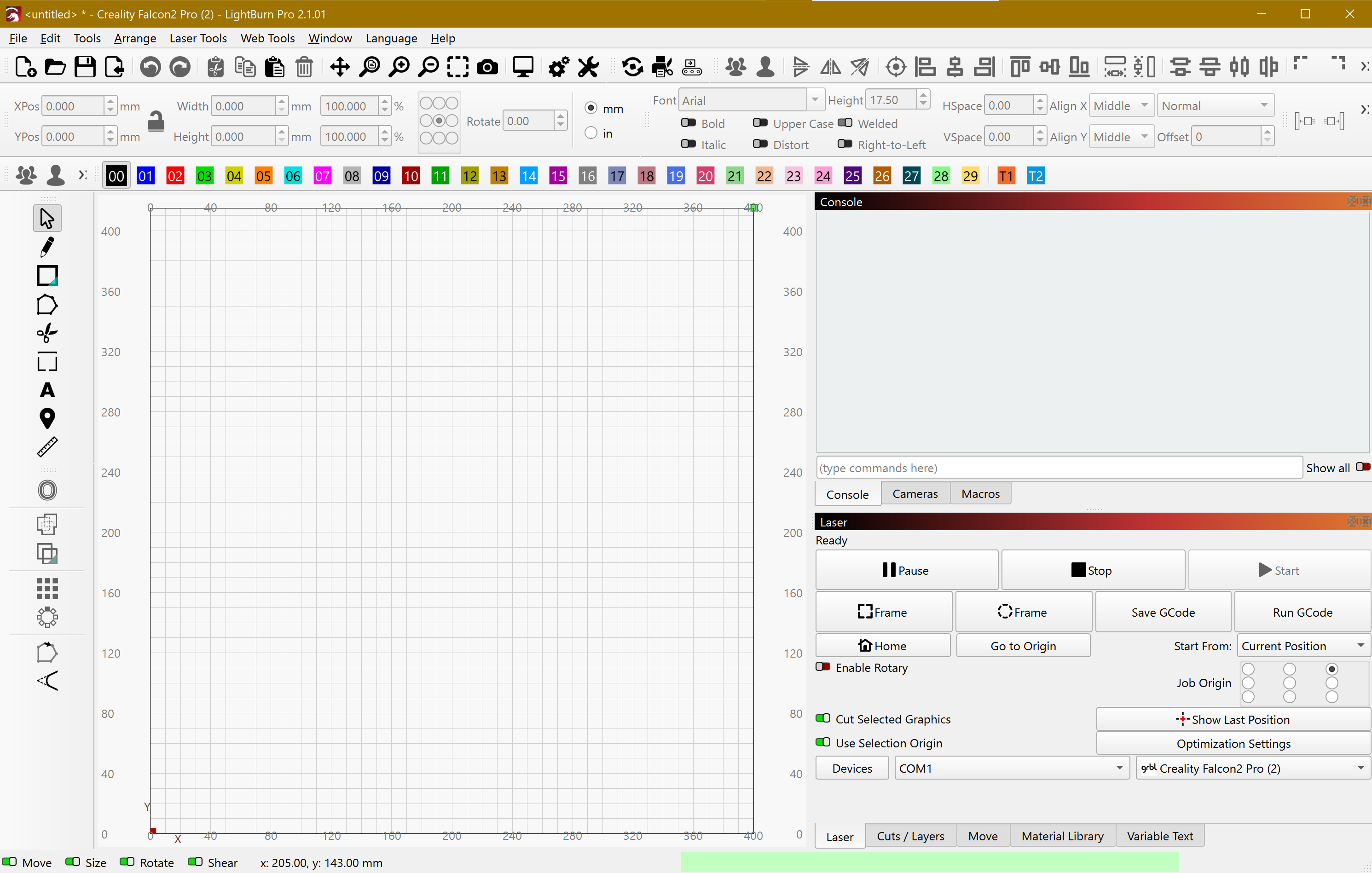

Many thanks for the response, I re-upgraded to 2.1 and your suggestions appear to have helped. But I have uncovered another issue in that the Pallette colour bar at the bottom the screen will only show if window is full screen and not in a window any help with this would be good too?
What is your screen resolution? It may be getting cut off if your resolution is too low to display it in windowed mode.
On Windows, right-click the desktop, choose Display Settings, and look under Display Resolution. On a Mac, click the Apple menu, select System Settings, and click Displays.

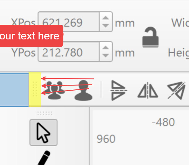

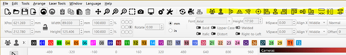

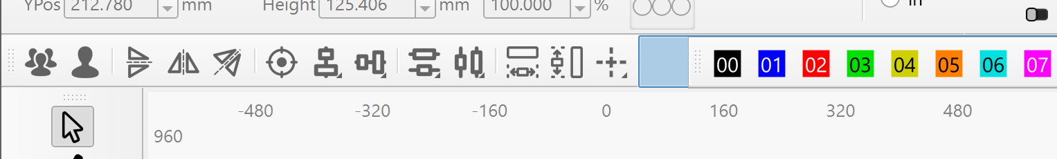

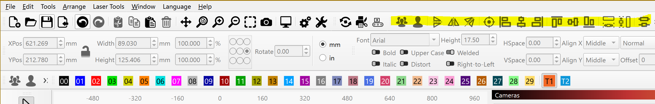

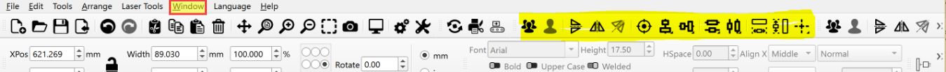

While this doesn´t solve your resolution issues it´s way faster to use the Pallette:
Select Arrange and Arrange (long)
Grab the dotted bar and dock the Arrange Bar against the Lightburn Window border
Dock the Pallet Bar next to the Arrange Bar
Grab the Pallet dotted bar and push the Arrange Bar until it ≈aligns with the right border of the Create Tools Toolbar.
Now you have Arrange (long) Bar in his place, one more place to easily check Group/Ungroup and a faster way to use Lightburn.
What does this do to the switches and status messages at the bottom of the workspace window?
They’re still there.
