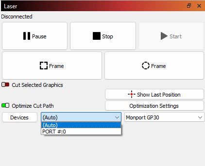

Waiting for connection... Monport GP30 Fiber Galvo
New computer (Beelink Mini PC with an AMD Ryzen 5700U, Windows 11), with a fresh install of lightburn. All drivers are working and up to date, the laser itself works fine with EZCad2, however Lightburn will simply not connect to it.
I believe this is a USB port issue with Lightburn. I have included a few screen shots for my setup.

Any ideas? I tried excluding USB ports in the lightburn preferences, but not sure if im doing it right.
The BJJCZ driver is for Ezcad not Lightburn.
Try going through the installation process again as detailed in the Docs
The following may also be helpfull.
