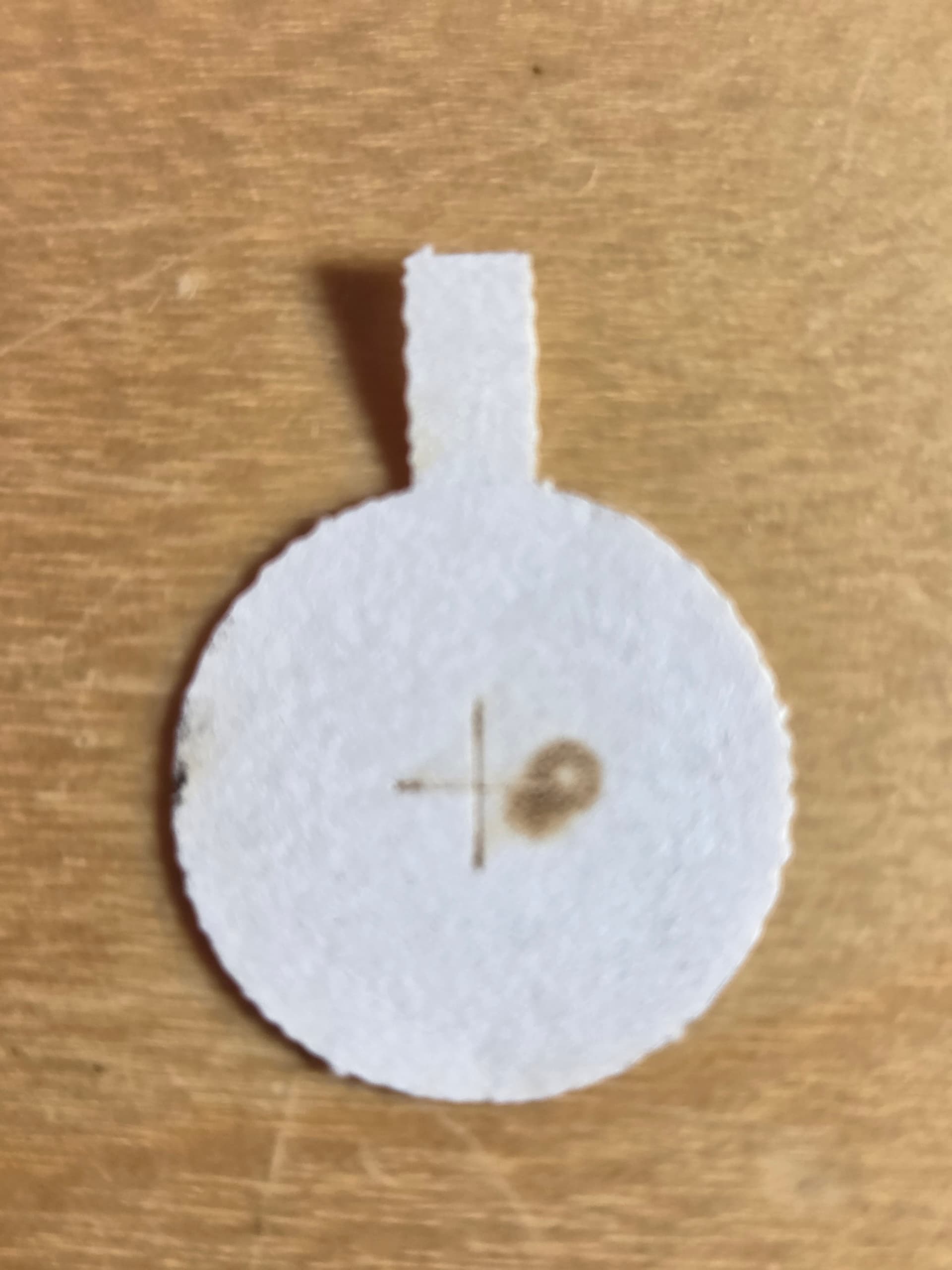

I have a 45W machine, currently and make targets for alignment. Although it’s out of TEM00 mode, here is a target so you can see the marks I made on them with the co2. The targets are lased using watercolor paper.
It should work, but will be very sensitive to power adjustments and will be close to the tubes low power end, which could limit you. Most of these won’t lase below 10%, so the lowest power is likely about 3W. Most K40 machines are 30W, not 40W machines.

I tried that on Tyvek (which is basically spun polyethylene) with poor results:
Some tests on posterboard definitely thinned the paper (on the upper tags), but left visible results:
Other folks have similar results with very heavy paper using a diode laser.
However, a laser removes material by burning it, which generally leaves a discolored residue. Burning a layer of paper without producing ash seems very difficult.
You must test this with the specific combination of laser and paper you intend to use, because a laser is likely the wrong hammer for watermarking paper.

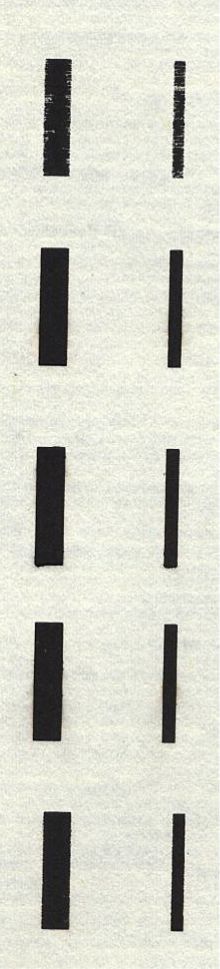

Applying this 254 DPI grayscale PNG test pattern I used for some power measurements in Pass-Through mode:
To some old letterhead that’s as close to cotton paper as I have, in a 60 W CO₂ laser …

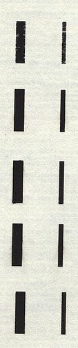

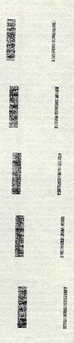

This column shows variations around ChatGPT’s settings:
The right bar is the 1 mm marker in the image. The left bar is the darker part of the grayscale.
This column uses settings around 400 mm/s, with the top pattern at Max=11.0% and Min=10% (the others have slight variations):
Bottom line: a CO₂ laser doesn’t have much dynamic range against paper …

AFAICT, the Min value keeps the corners from fading away:
That’s with Min=7.1% and Max=7.5% and the coolant at 20.7 °C.
Running the same test with the same power levels and the coolant at 20.5 °C drops out on the corners even worse:
So, basically, screwing around near the bare minimum power to fire the tube turns the laser into a sensitive thermometer. :grin:
