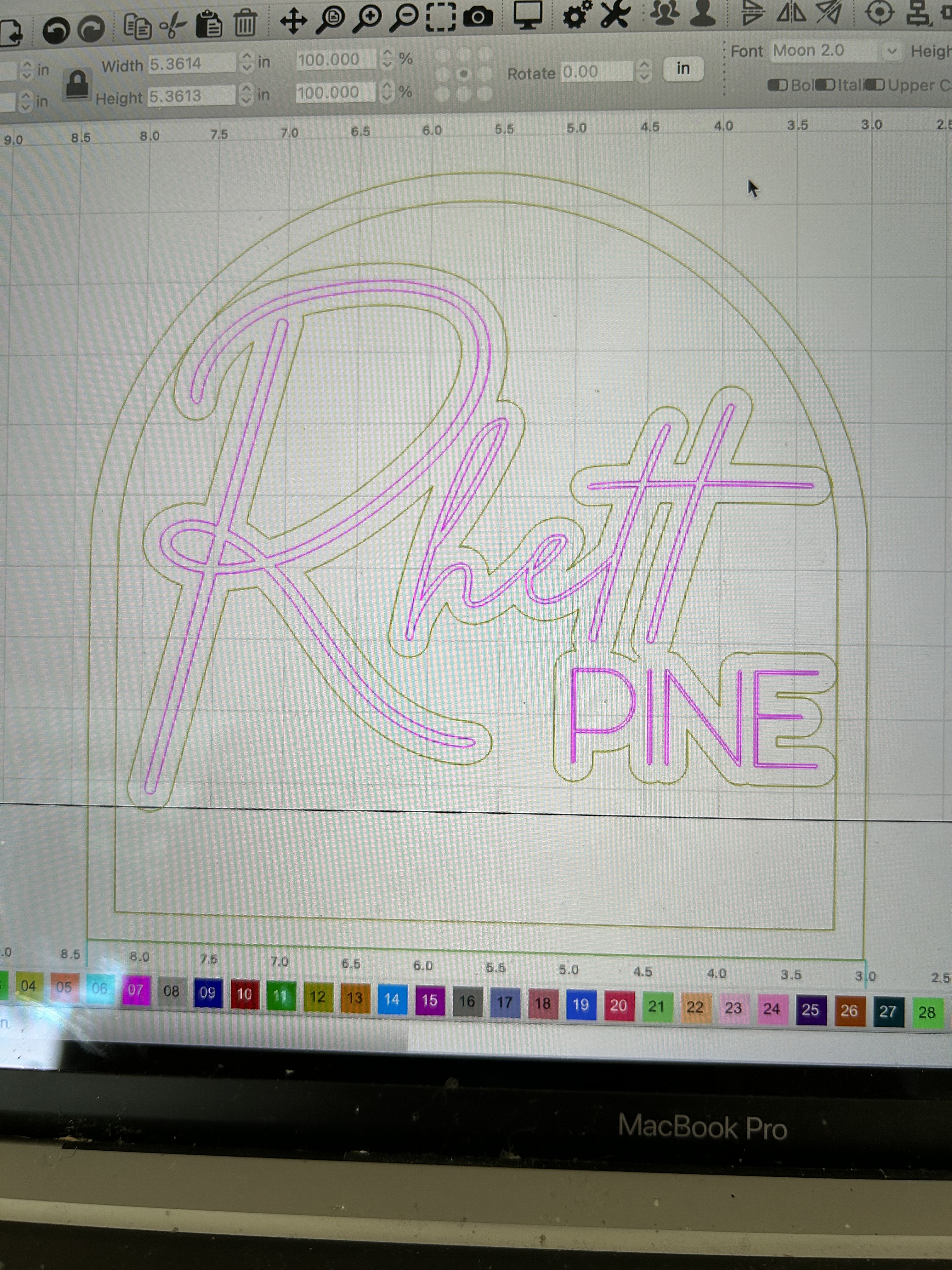

![IMG_0509](https://forum.lightburnsoftware.com/uploads/default/original/3X/b/8/b88a0712bfed42b7e895230899d8fd19577f0e83.jpeg)
 ![IMG_0352](https://forum.lightburnsoftware.com/uploads/default/original/3X/2/e/2e086ffdbb50aeb49ff5fa89957aacc908f65494.jpeg)
Hi,
Is there a way I can weld or mesh the offset around my font, with my arch shape? I want those yellow lines to be cut lines … but when I select them and weld, the offset lines around my font just disappear. I really want to have my laser cut around the font… but also for it to be welded to the arch shape and “hold together” for a cut like the other pic.

1. Group the 2 outer shapes that make up the arch shape
2. Select arch
3. Add text outline to selection
4. Tools-\>Boolean Union

Thank you!!! It worked perfectly. 🥰
