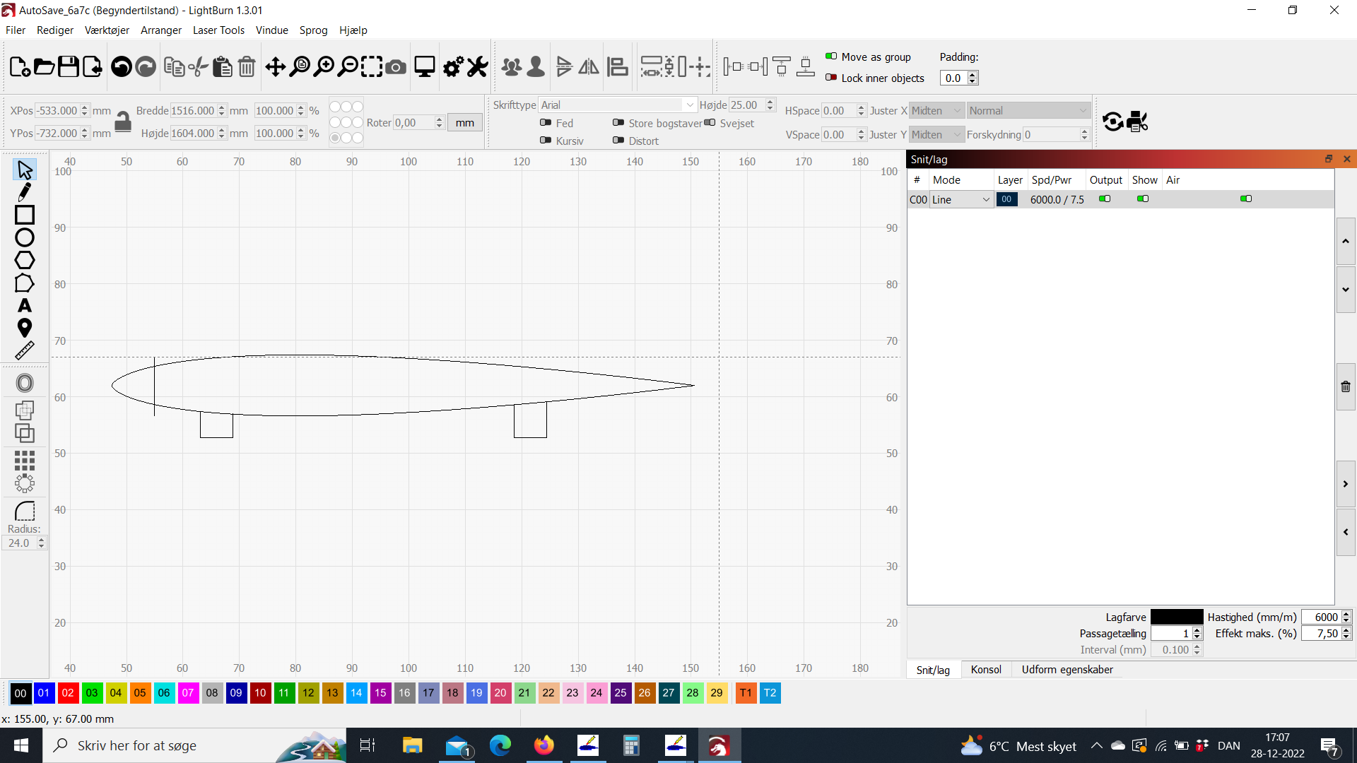

Welding is not working for me
I have a new problem. I have read the instruction about welding. Drag from left to right so
the items that should be welded together are all selected and then just press weld. It just does not work in my case
I attach a scr.shot. I want to weld the two building tabs on the bottom to the profile
I’m going to guess that the shapes at the bottom are not closed shapes. Weld will only work with closed shapes.
The items must be closed and overlap slightly.
