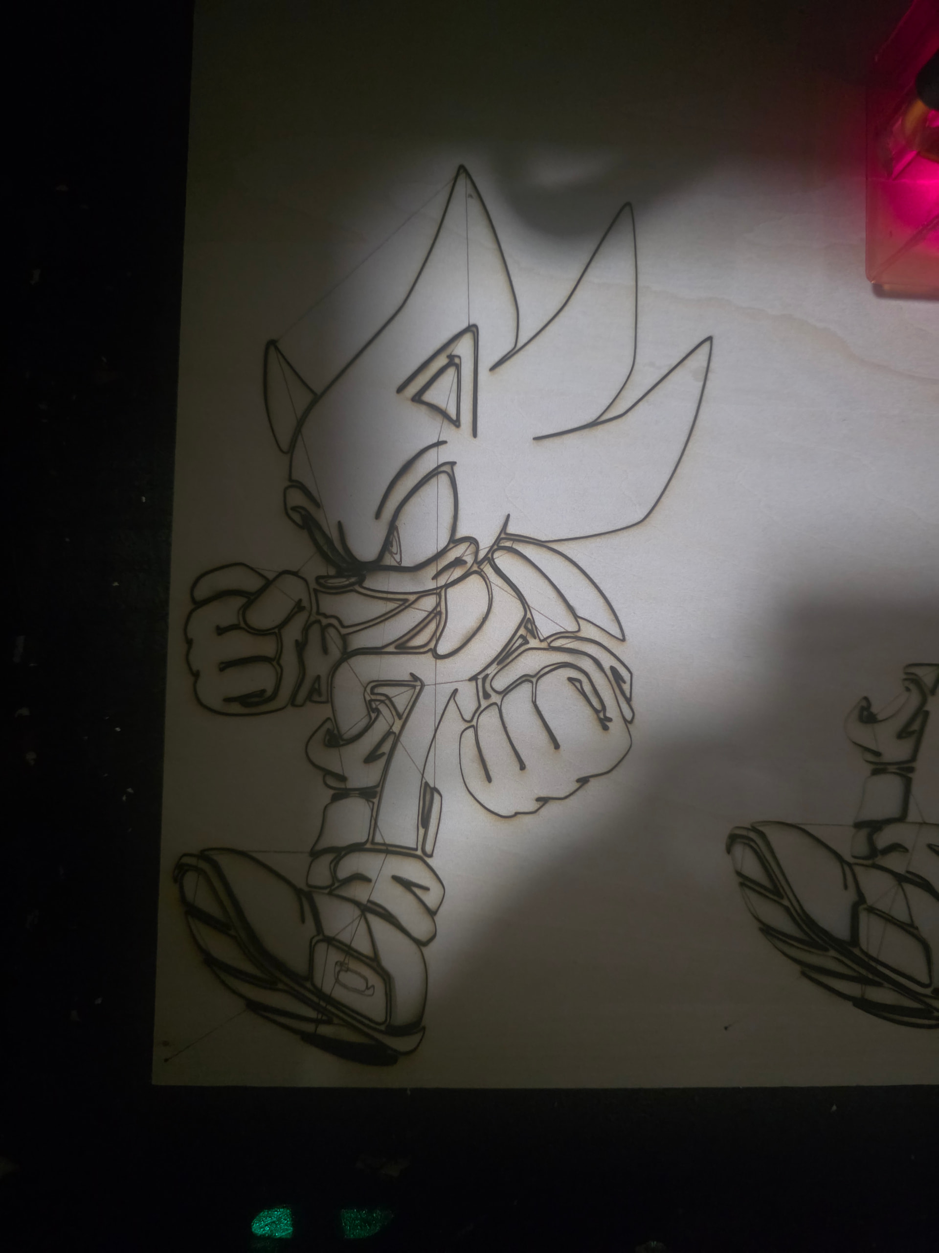

What did I do wrong?
just apart my A20 Pro laser to clean it all out. I installed the newest lightburn and its making these lines to each cutting pattern. How do I fix this?
That looks like what happens when ‘laser mode’ is not enabled in the firmware ($32=1 in the console)
