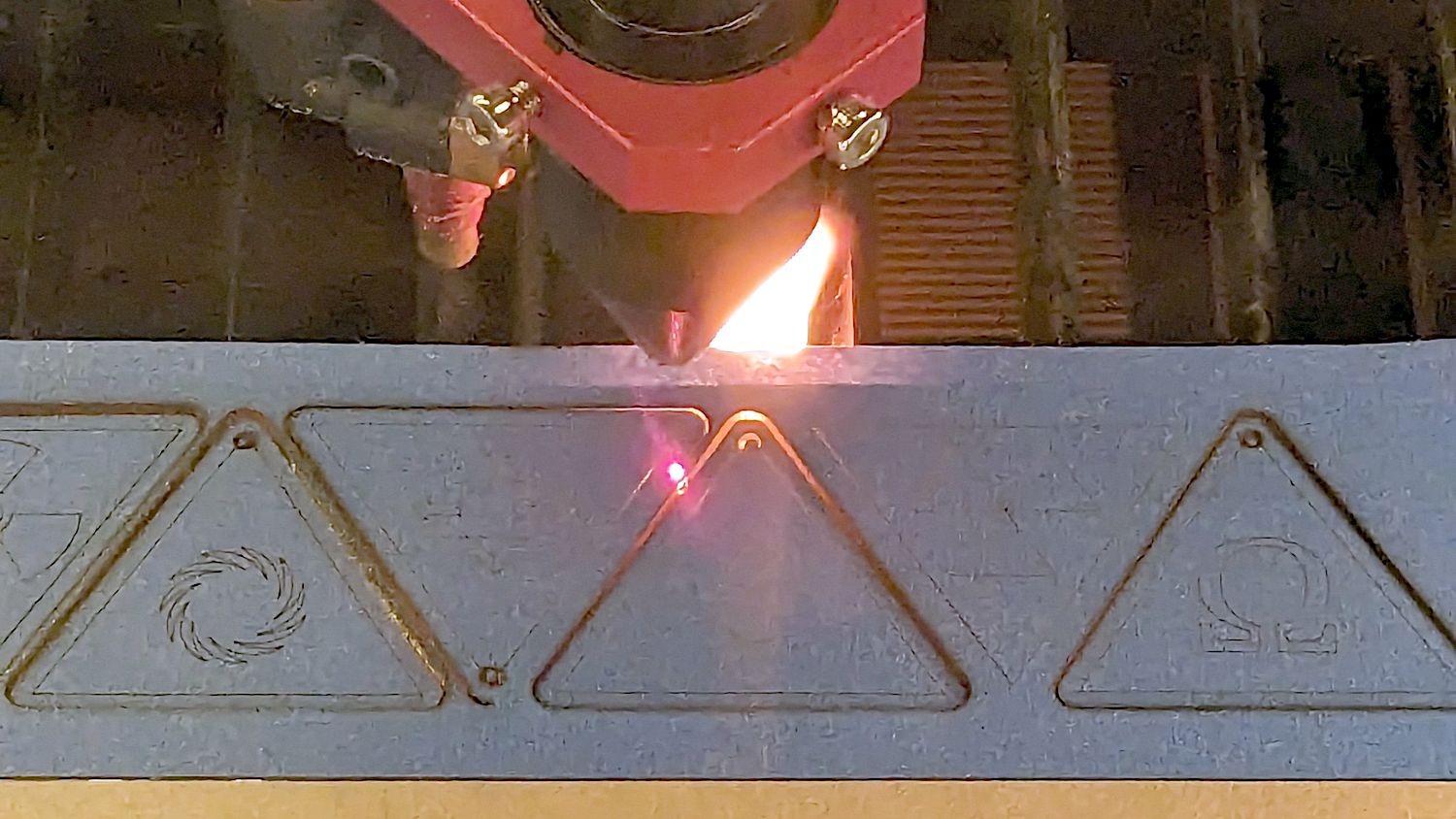

> [@deemery](#):
> What do I do if the material catches fire?
Grab the water spray bottle prepositioned at the machine, open the cover, and extinguish the smallest of flames.
If the spritz fails, [grab the CO₂ extinguisher](https://softsolder.com/2022/12/13/laser-cutter-fire-extinguisher-brackets/) prepositioned at the machine and smother the flames. In my case, there are _two_ CO₂ extinguishers near the laser, but that’s just me.
If you’re across the room doing something else and only notice a problem after flames punch through the enclosure, then your insurance agent will not be sympathetic at all.
Some flame seems inevitable, which is why _paying attention_ is so important …
[Plywood raised on punk spikes](https://softsolder.com/2023/09/29/laser-cut-plywood-flame-vs-assist-air-flow/):
[![](https://softsolder.com/wp-content/uploads/2023/09/pxl_20230924_160554338-laser-cut-plywood-flames-c.jpg) ](https://softsolder.com/wp-content/uploads/2023/09/pxl_20230924_160554338-laser-cut-plywood-flames-c.jpg)
[Acrylic on knife bars](https://softsolder.com/2023/06/12/danger-zone-earrings-more-scp-warning-labels/):
[![](https://softsolder.com/wp-content/uploads/2023/06/pxl_20230611_185007178-scp-earrings-black-on-yellow-cutting.jpg) ](https://softsolder.com/wp-content/uploads/2023/06/pxl_20230611_185007178-scp-earrings-black-on-yellow-cutting.jpg)
Oh, and occasionally [the machine just falls apart](https://softsolder.com/2022/09/15/never-ever-run-your-laser-cutter-unattended/) and you must intervene:
[![](https://softsolder.com/wp-content/uploads/2022/09/pxl_20220911_145216840-detached-laser-lens-holder.jpg) ](https://softsolder.com/wp-content/uploads/2022/09/pxl_20220911_145216840-detached-laser-lens-holder.jpg)
