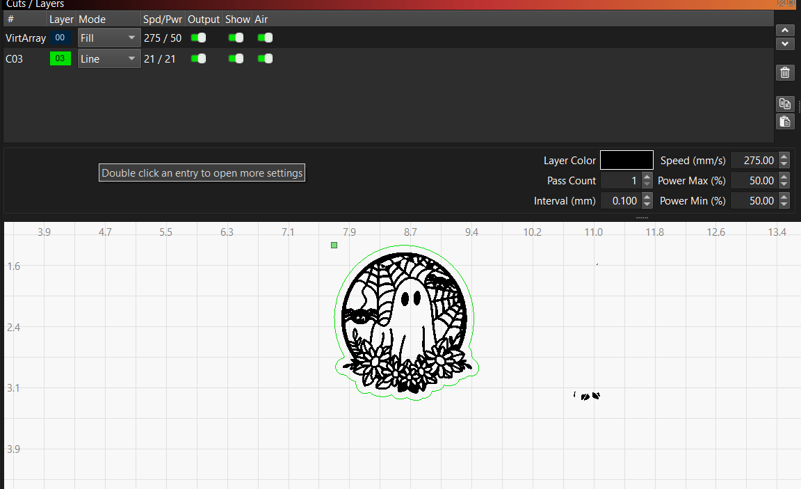

My laser has started making this screech sound when I run it at slower speeds and lower power. I have a video on a engraving to cut that I did with mirror acrylic. 15/38/38 noise is non existent. 15power 38speed 38min speed. omtech 50W 3 years old.

What are your minimum settings? , please specify the units correctly so we’re talking about the same thing,
I don’t know what that means.

Up to the 12th second, the ammeter shows no activity or only short pulses…, It’s hard to judge without seeing the file itself.
the first half of the video is the engraving part, then at 12 second the cutting starts and so does that screeching sound.

it used to never make this noise at all thats why I am concerned about it. The laser beam its self will dim as well.
See, that’s an important piece of information that you didn’t mention before. If your Laser starts to have variations in its output power and sounds strange, then it could indicate either a faulty power supply or a faulty tube.

To me, the sound seems to be coming from the power supply, a voltage leak from the flyback to the case. I’ve had similar problems; in some cases, it was the old tube, which generated very high resistance, and the power supply had a tendency to leak current to the case. It could also be the power supply. I have a machine operating with a similar noise, but without any visible problems. The strangest defect I’ve had that caused something similar was the tube’s negative wire breaking internally.
