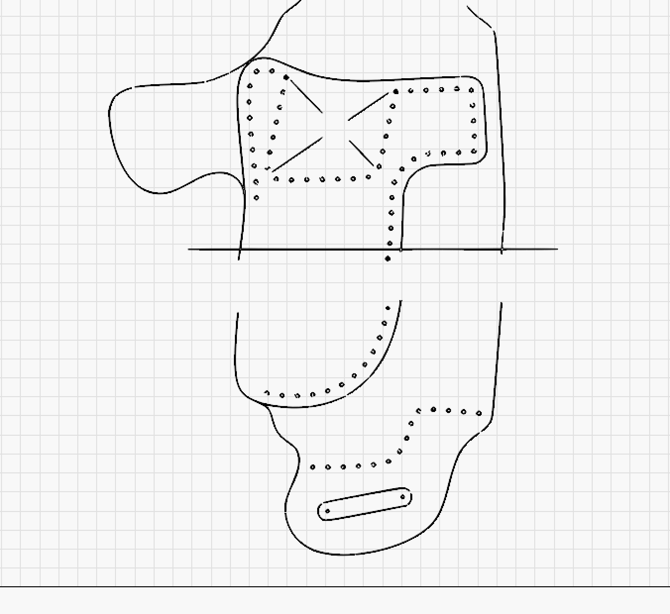

I am trying to lengthen a pattern. I need to add an inch on all lines. What would be the correct process to achieve this? Attached is the pattern.
I meant add an inch on the lines bisected by the straight line.

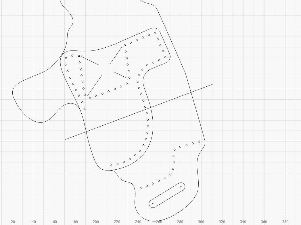

I will rotate the shape up on the line, insert nodes, break them and pull the bottom part down the number of mm that I want. Then I will add the missing holes and connect the shapes again.
OOOOh right I get you. Thank you very much.
