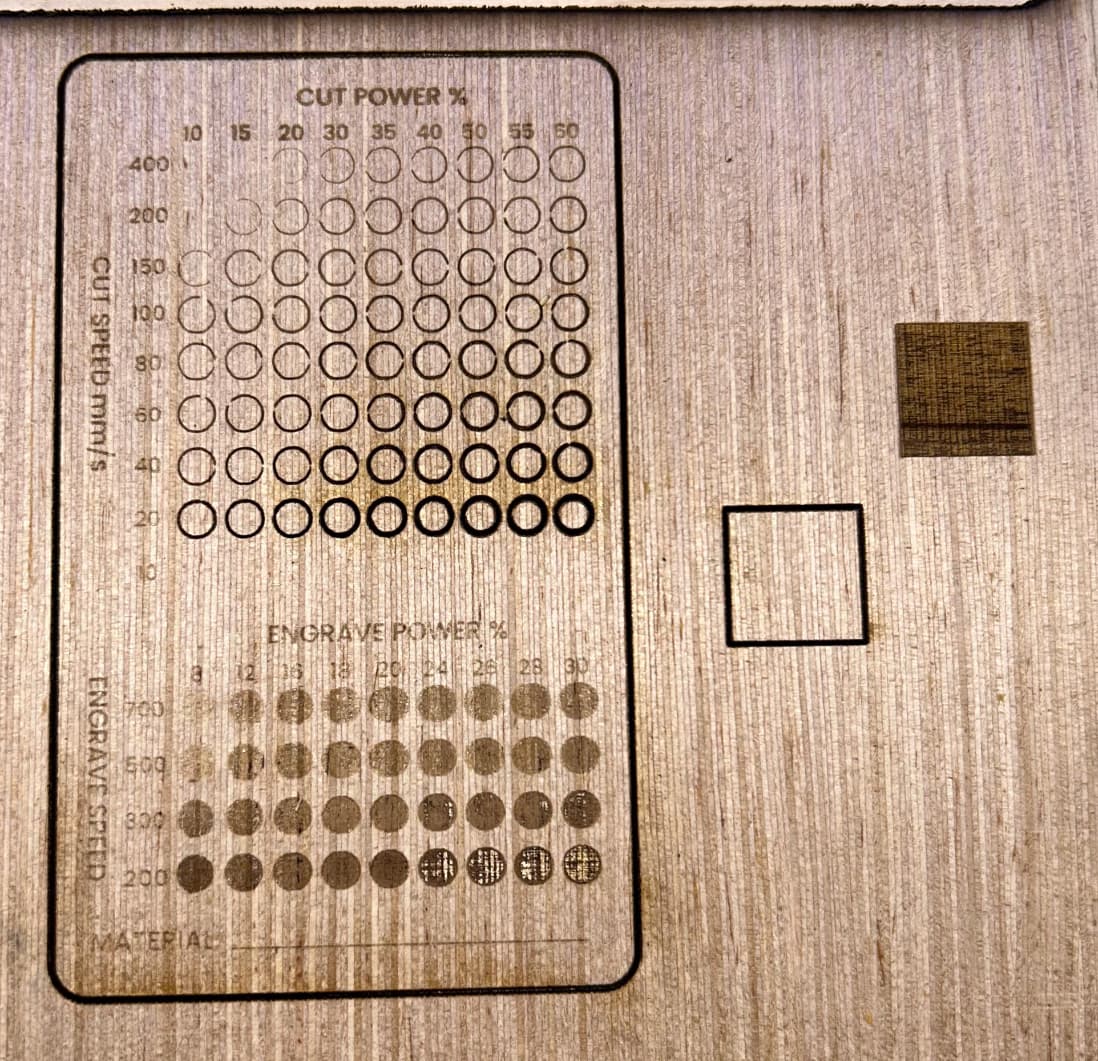

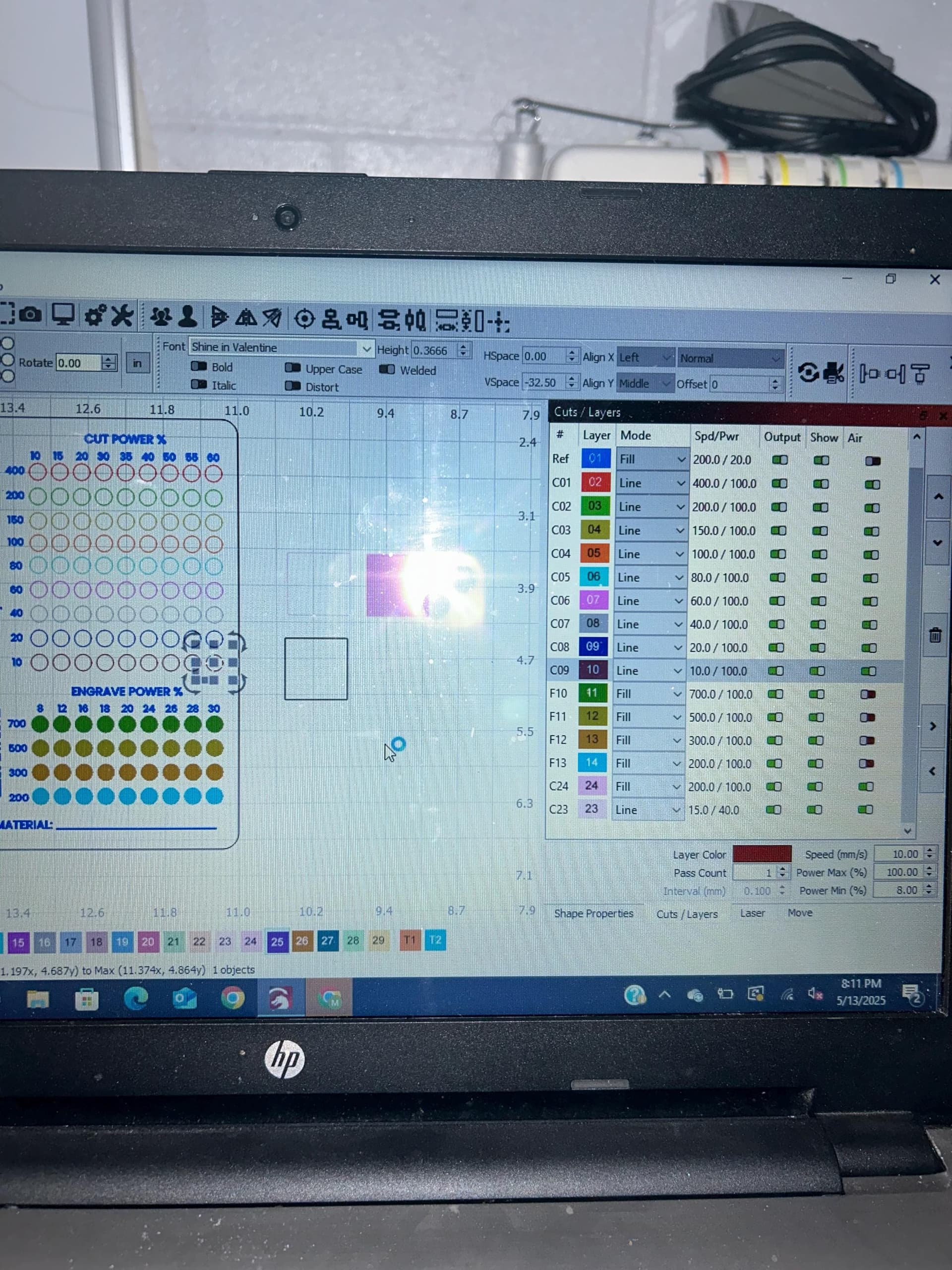

What settings do I use with this file I downloaded?
I have purchased this test file to use on my materials. I plug in power and speed that shows on the material that will work best for the result I want. But once i use the settings on my main piece, it doesn’t cut at all. Is there a setting I am missing somewhere??
80-100W-Material-Test.lbrn2 (897.5 KB)

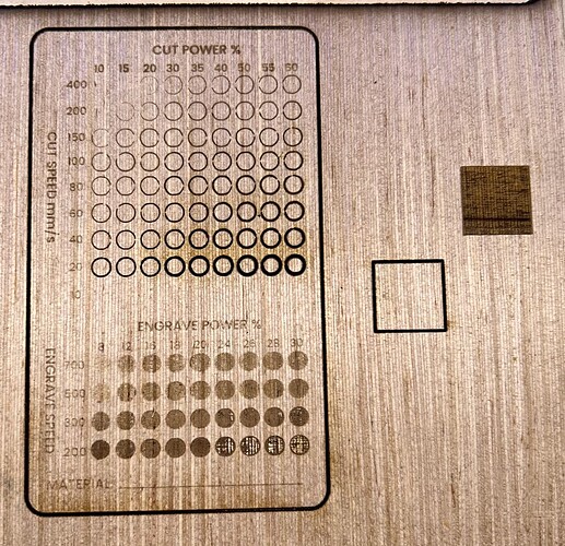

Here is what the test material looks like
Where do I find the s setting?
First of all, you don’t need to buy material tests, LightBurn will generate them for free.
Next, be aware that such tests are not very meaningful. Those circles are very tiny. If you command the tests to run at high speeds, the laser will probably never reach them before the shape is done.
Use fewer tests but bigger objects. I think those circles should have a diameter of 20mm or more, ideally.
