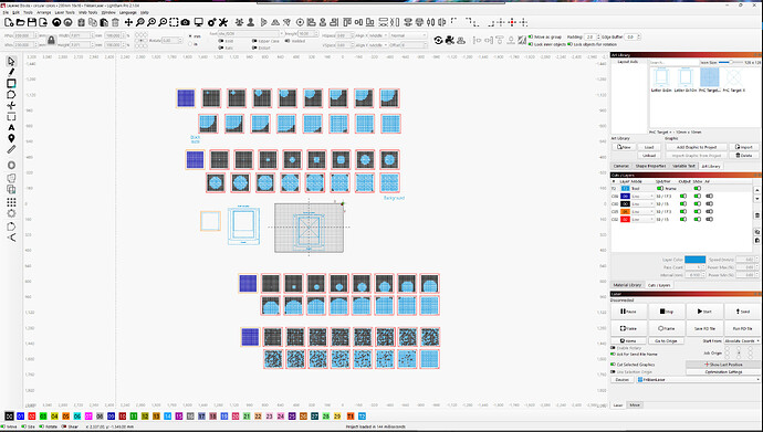

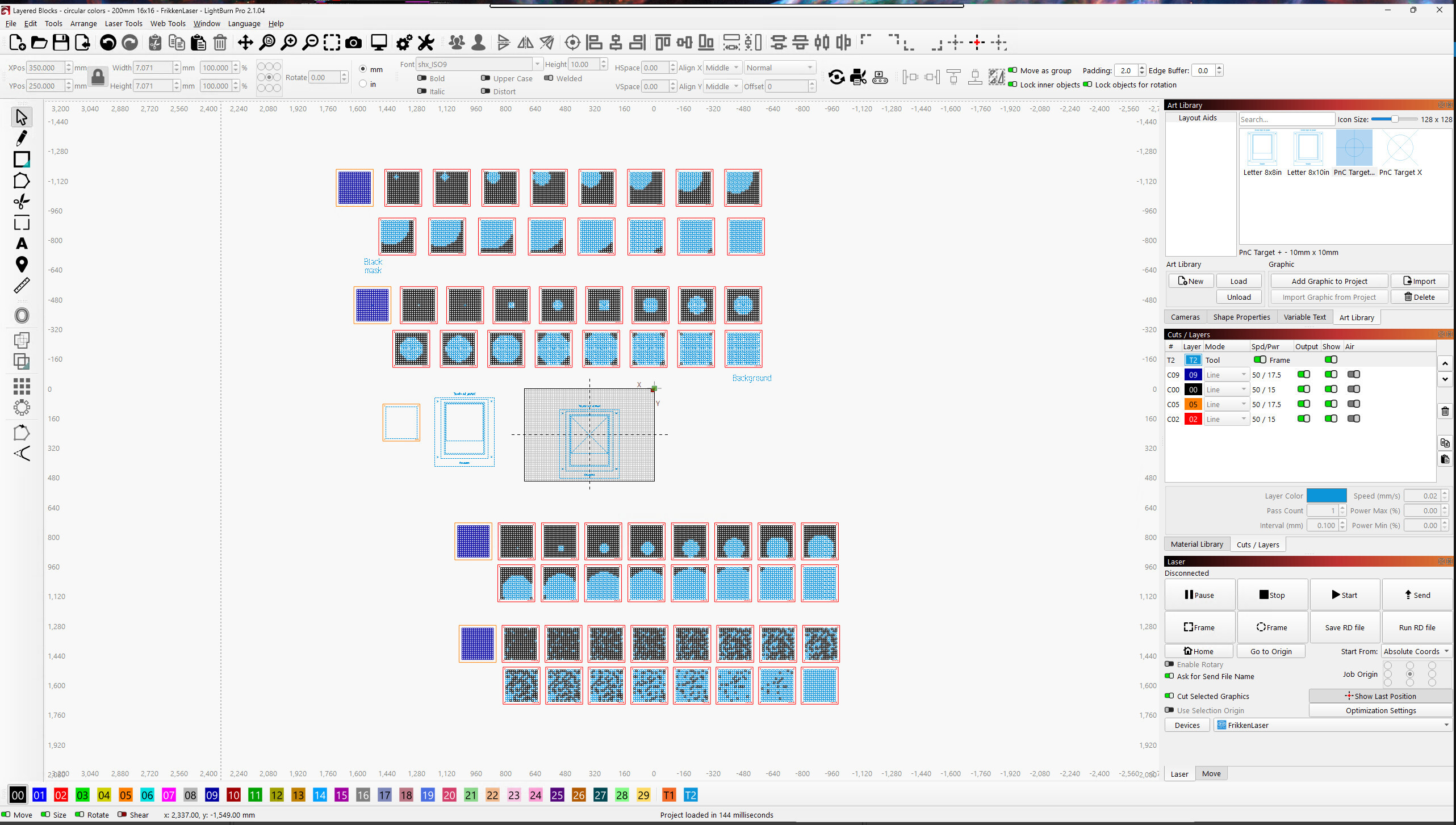

Not necessarily every _burn_, but certainly every _project_.
Within that file, stash the intermediate layouts you made along the way, so you need not start from scratch to make a change. The grid in the LightBurn layout marks the machine platform, but the blank space around it can hold plenty of design pieces:
 ![LightBurn - stashing designs](https://forum.lightburnsoftware.com/uploads/default/original/3X/7/0/705b42ac9d4469dbaad4803d6c8a9a396c222814.jpeg)
The distinct clusters accumulated the layouts for [some layered paper designs](https://softsolder.com/2025/08/07/layered-paper-svg-generator/), along with the template corresponding to the [fixture holding the Letter paper sheets](https://softsolder.com/2025/03/26/laser-cutter-letter-page-fixture/).
If you set up the fixture & template properly, you can select the next thing-to-burn, hit Ctrl+D to duplicate it, hit P to slam the duplicate into the middle of the platform, then Fire The Laser.

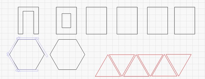

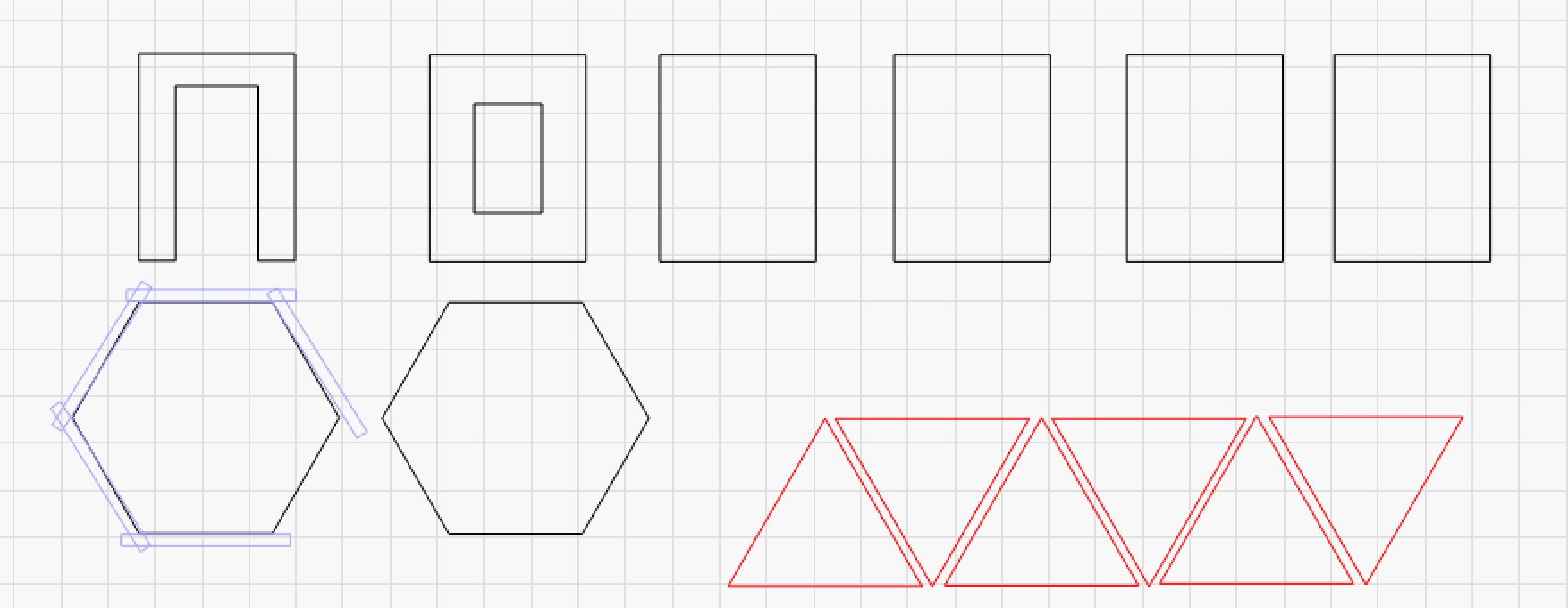

Accumulate the layer settings for each material in the [`Material Library`](https://docs.lightburnsoftware.com/latest/Reference/MaterialLibrary/) so you can refer to _named_ values when you want to do The Same Thing again:
 ![LightBurn - Material Library](https://forum.lightburnsoftware.com/uploads/default/original/3X/4/e/4ed8c1379aa05df6f9f9a844b273c046b4248d19.png)
The library settings may not be _exact_ for a new batch of “the same material”, but they’ll be much closer than whatever you remember they were. 😁

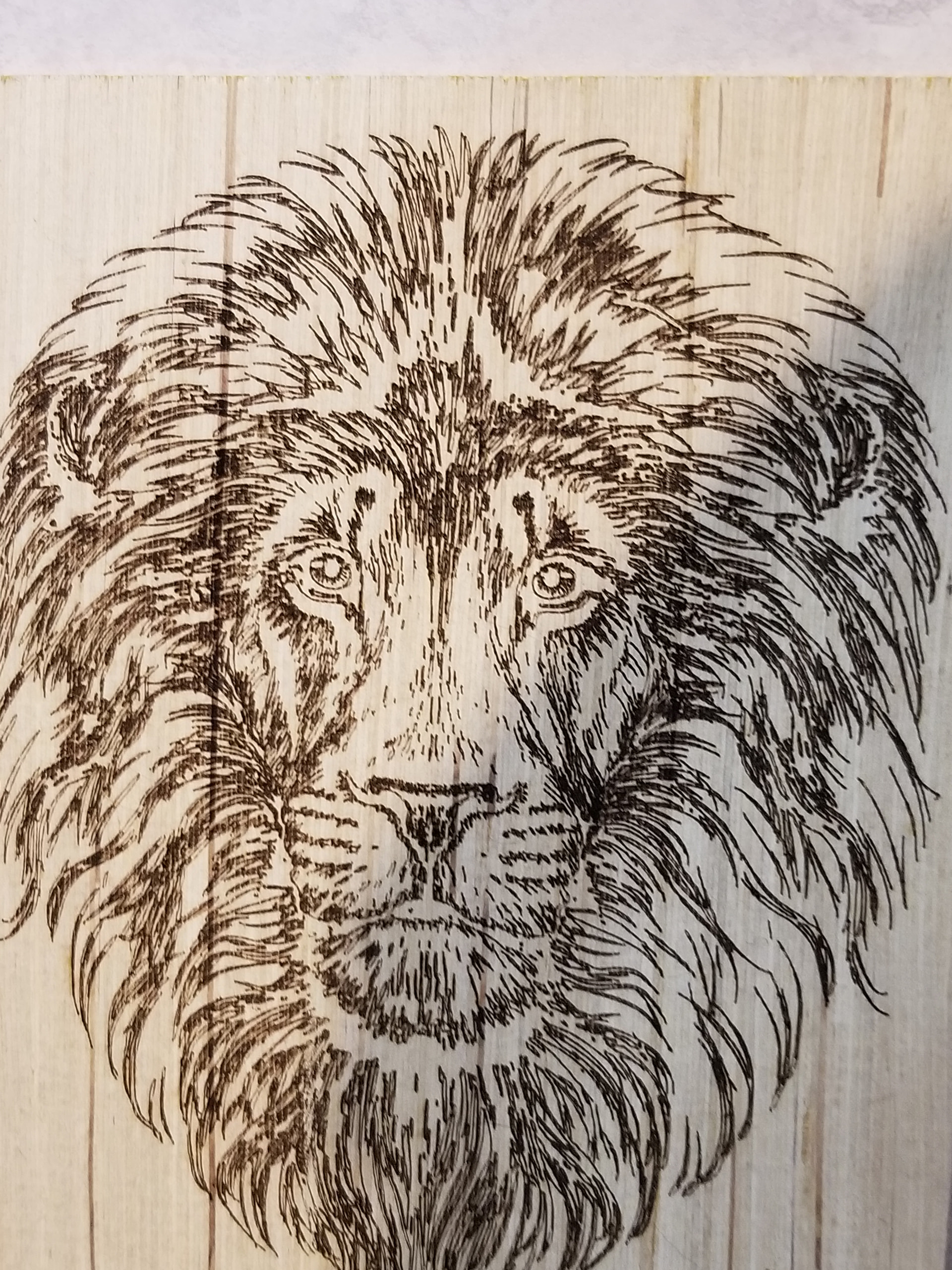

If you try to learn everything before you do anything, there is no point to buying a laser. This hole is as deep as your physics will take you.
Try some basic shapes, such as this lion on 5mm sub flooring… cheap material but pretty tough and plain line drawing are plentiful on the Internet.
 ![crop-best-lion](https://forum.lightburnsoftware.com/uploads/default/original/3X/1/4/14ebe80c55d6c256412f85b4e38cdd8e6b63b0ee.jpeg)

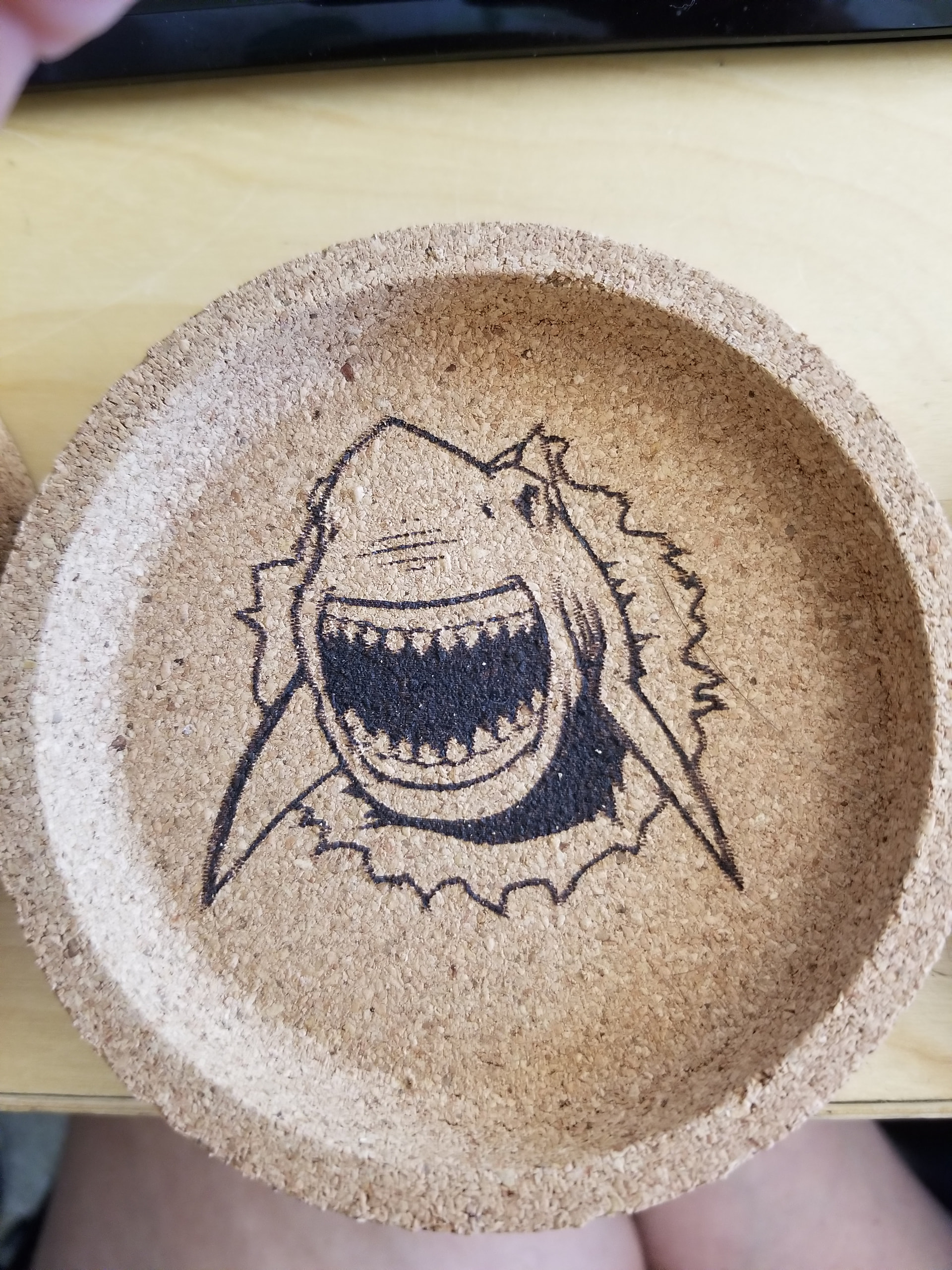

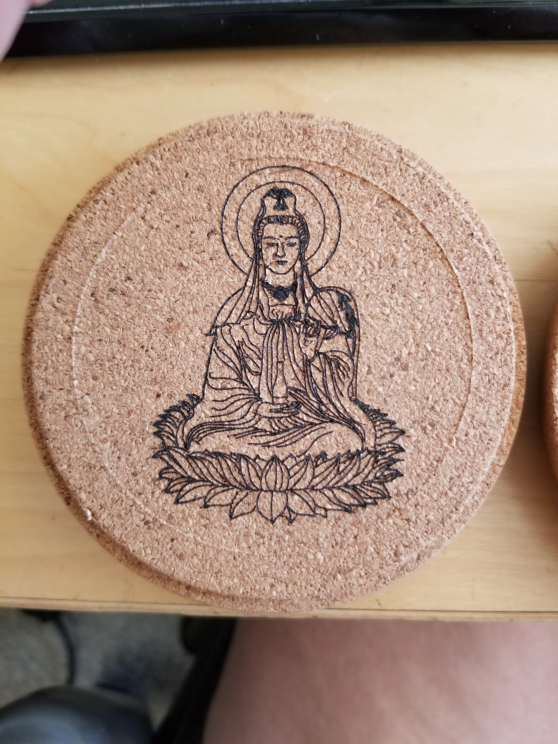

These on cork
 ![cork-shark](https://forum.lightburnsoftware.com/uploads/default/original/3X/6/4/64d51e6f65a463c183af48e5cbe2db8d1e243502.jpeg)
 ![cork](https://forum.lightburnsoftware.com/uploads/default/original/3X/4/0/4053a18f97c701ab9cc05b1412450b6731643770.jpeg)
These are all simple designs using vectors, so you don’t have to worry too much about any kind of grayscale or shading.
These were done years ago. However when I moved to the co2, I just made simple, but larger ones, same thing with the fiber.
When you want to do something and you don’t know how, add that to your repertoire.
Having one of these are for fun, not so much about learning details… you’ll get there… When you learn the details, it will come over time. Don’t get in a hurry.
Have fun.

I’m not sure what I’d learn by burning a line drawing. Is it tuning the laser to get a better result? It’s certainly not designing for the laser. Now if you could provide some advice on what to look for in a burn, and then what to correct based on those observations, I’d find that helpful.

This is totally determined by what you like. Some users like light brown engravings. I prefer burning into the material so the recipient knows for sure it was not something ink stamped in a Chinese factory.
Listed or posted settings are used to get you in the ballpark, but it is up to you to decide what is acceptable for you or any potential customers.
The one thing that gets mentioned time and again for various reasons is to **focus the laser**. If you get unacceptable results, assume the manufacturer did not get it right.

Yes, “Tuning to get a better result” would be a good way of looking at it.
You can learn to get a good line with everything set just right and have all that done relative to the specific material you’re using at that time. This will save time and materials ‘When it matters’…that’s artisnal smarts.
Then there’s the outcome when you attempt something like the buddha above, How will those nice lines look when they are combined into a complex pattern in terms of heat dispersion, blurriness…depth of mark etc.

There is always something to be learned. Line drawings will show up mechanical issues and speed limitations, resulting in wavy lines at direction changes.

4. measure/verify the laser kerf, then configure my own first project, so that the parts are docked with the laser kerf gap. Burn that and see how the result looks.
 ![Screenshot 2026-08-27 at 11.38.32](https://forum.lightburnsoftware.com/uploads/default/original/3X/9/2/92ac3680ddfbb82c705f5798fd50bbd24940807b.jpeg)
(That’s a hex shape HO scale telephone shack, with openings for styrene door and window castings, and a peaked roof. I should calculate/add formers for the roof. Eventually, I’ll cut the walls from wood clapboard panels, and the roof from plain wood or plywood.)
My primary intended use, at least initially, is cutting out shapes. I’ll want to learn effective engraving, but that’s secondary to precise production of ‘chunks of wood’…
