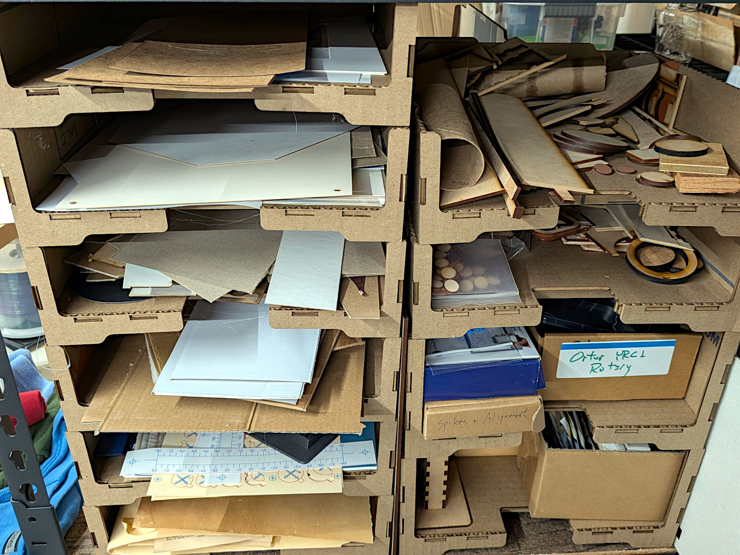

Practice on cardboard to minimize the cost of the surprises you’re about to have. If you _haven’t_ been saving tissue / cereal / food boxes, now’s a good time to start:
 ![PXL_20260827_161115240 - Letter Paper Tray Storage](https://forum.lightburnsoftware.com/uploads/default/original/3X/b/1/b10958173d1972500a8ec4043b944b2c49ef1a9f.jpeg)
Oh, yeah, [cut some storage trays first](https://softsolder.com/2025/04/01/laser-cutter-letter-paper-storage-trays/), because those surprises will be even more instructive. 😁

Nice! But my laser is a closed box, too small to cut your pieces. Still, a design in box cardboard for something like this is something I’ll think hard about. I’m sure I can come up with some useful workshop/storage idea.
A friend took some of my shop/storage ideas and cut them in Masonite/hardboard, and sells them. They’re some of his most successful products.

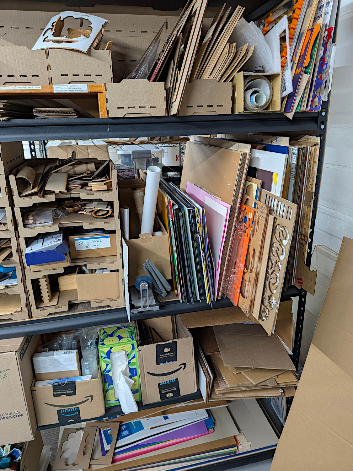

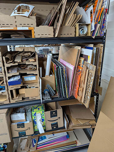

They tell me not to store stuff on edge, but sometimes ya gotta do what ya gotta do:
 ![PXL_20260830_202102666 - Laser material sheet storage](https://forum.lightburnsoftware.com/uploads/default/original/3X/c/f/cf81135daa023a7ee494f6ccb849c3411dfb71c5.jpeg)
What’s not obvious are the plywood slabs (sawed from the crate the laser came in) between sections of those vertical acrylic / plywood / chipboad sheets on the middle shelf. The two or three inches of sheets between pairs of plywood supports have no reason to develop a bend, so it works out well in practice.
The bottom shelf holds large sheets that either don’t fit vertically or are material like paper / EVA foam that laugh at restraints.
The cardboard sheets serve as both raw test material and airflow blocking covers for the honeycomb in the machine.

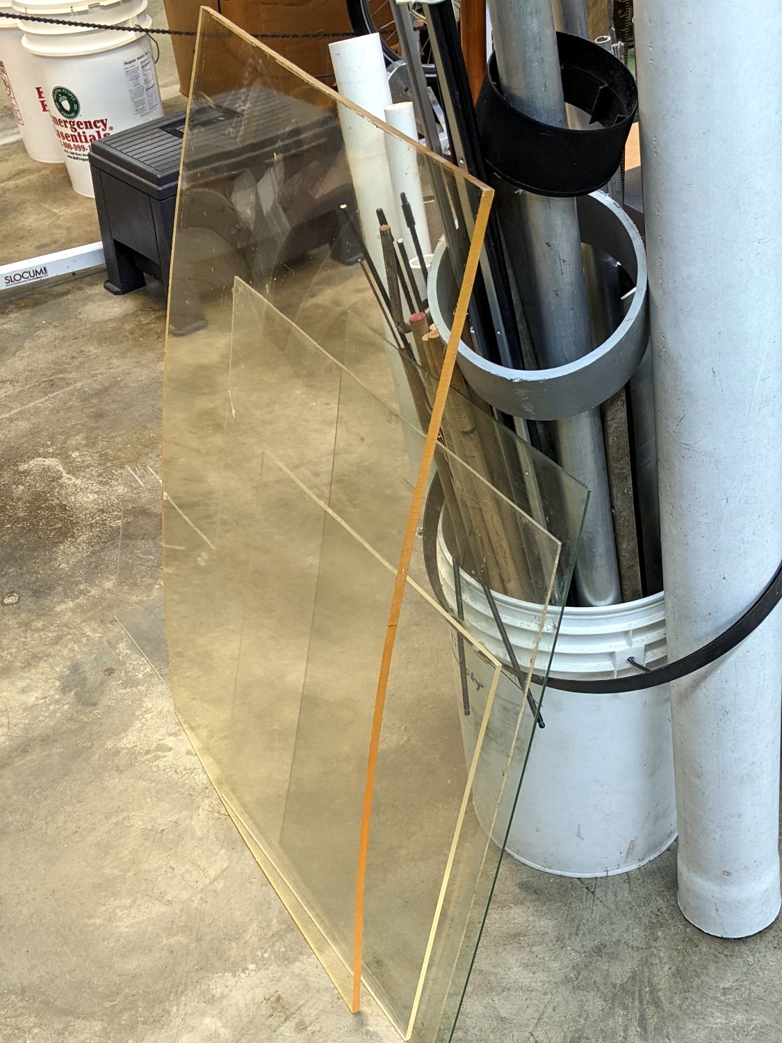

**Edit:** If you _don’t_ support the sheets, you get [something like this](https://softsolder.com/2022/10/06/vintage-acrylic-unwarping/) after a few decades:
[![](https://softsolder.com/wp-content/uploads/2022/03/pxl_20220313_155047180-acrylic-stockpile.jpg) ](https://softsolder.com/wp-content/uploads/2022/03/pxl_20220313_155047180-acrylic-stockpile.jpg)
The thick yellow edge is 3/8 inch “clear” acrylic with an inch of warp in the middle.
