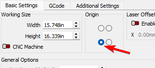

When I have image on work space and look at it in preview ever thing looks fine, when I burn it it comes out as mirror image. Whats wrong?
4this has happened suddenly. It has worked fine up until now.:joy:
Hi Jack
Navigate to Edit > Device settings
Make sure the Origin is set to Front Left
It worked. Thanks
