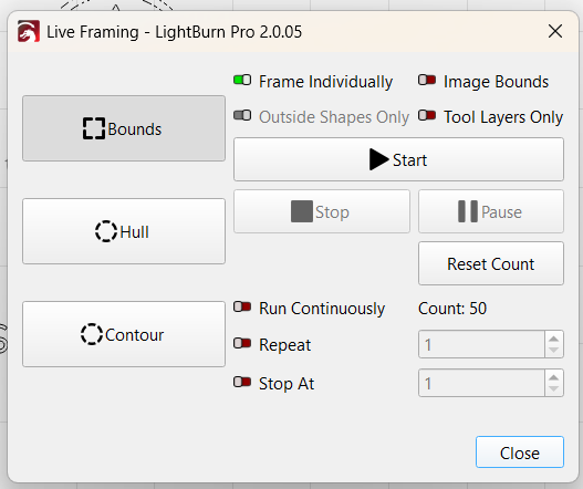

When I press the frame button my laser immediately etches. This has always been the way my LightBurn - Laser has worked.
Using Light Burn Pro. 2.0.05 (windows 11). Monport Gpro 30W Mopa fibre laser.
Ref. Image below. As soon as I hit that start button in the Live Framing pop-up, etching commences.

Just to clarify, is the laser marking as soon as the Live Framing window opens (“When I press the frame button my laser immediately etches”), or only when you press the Start button in the Live Framing window (“As soon as I hit that start button in the Live Framing pop-up, etching commences”)?
If it’s the former, can you share a screenshot of your IO Port settings under Device Settings > Ports and Laser Settings? If you have the Start Framing port configured incorrectly it could trigger the laser to start marking instead.

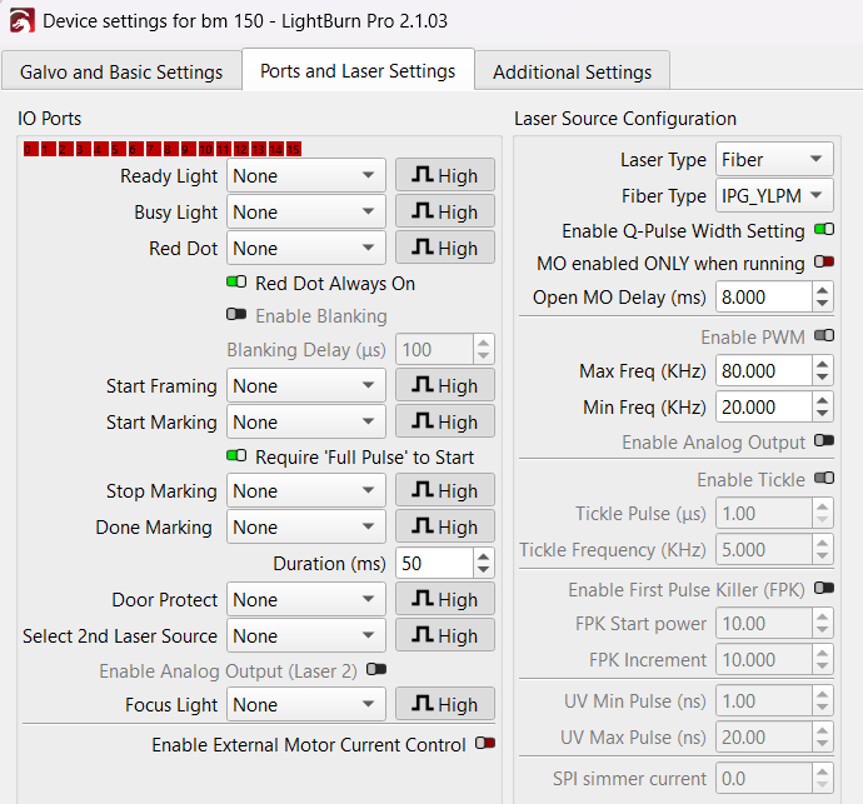

Hi JTR.
Please see the settings image as requested.
Your support is most appreciated. Please let me know if you see anything in these settings that may cause the problem.
To confirm it is when I press the start button that the etching commences immediately, even when I am in framing mode. Ie… i am unable to frame.
Thank you.
Thanks for this. Since you have no ports set, there is nothing in those settings that could cause the Framing button to trigger marking.

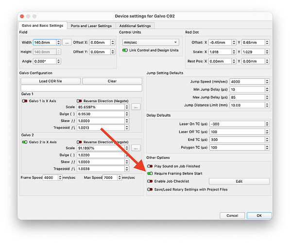

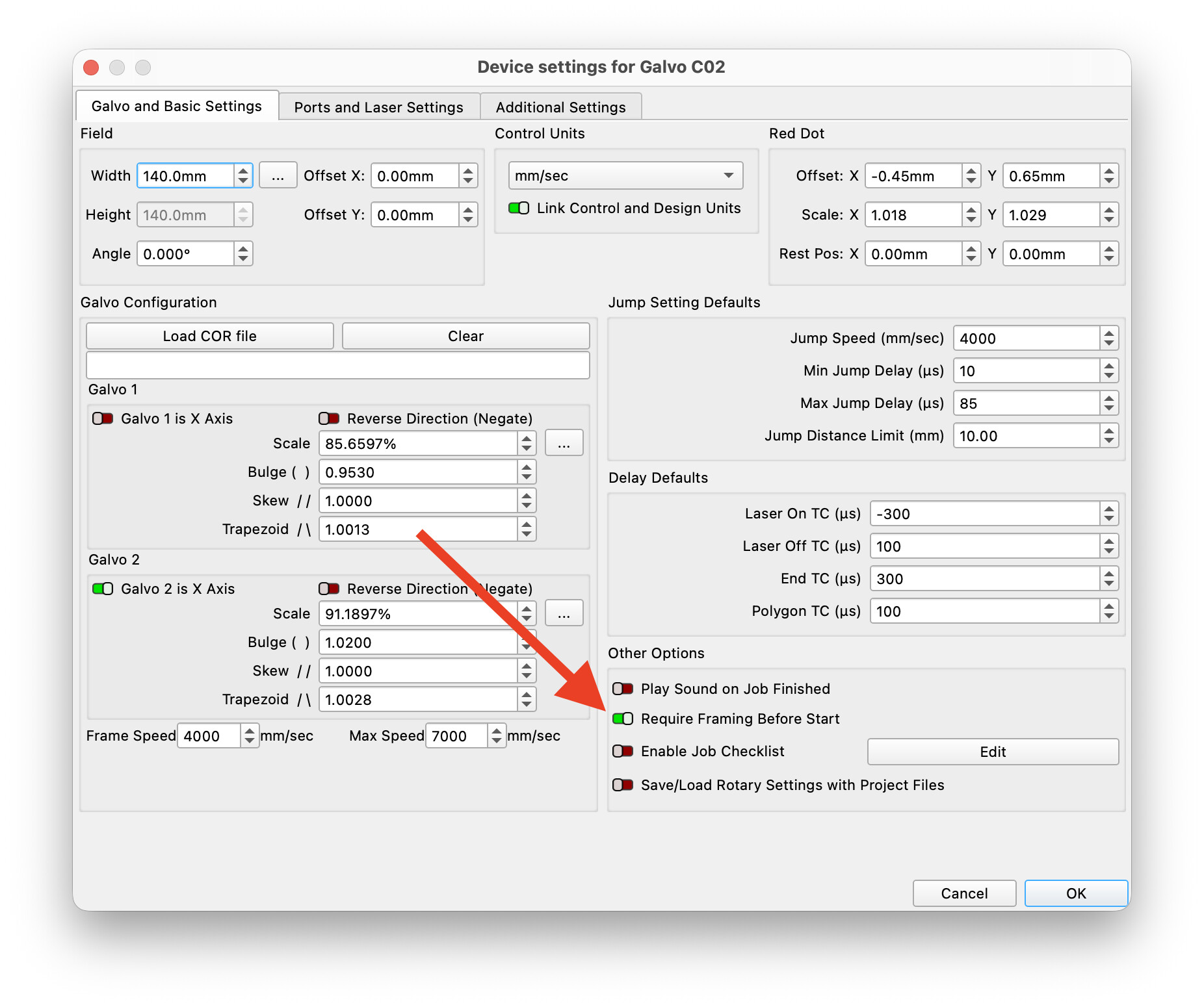

  1. When you press Start, does the Framing screen open? If not, that part is an easy fix - go to Laser Tools → Device Settings and make enable Require Framing Before Start.

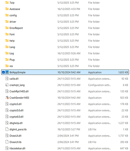

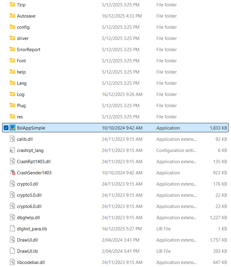

I checked the Monport USB. It doesn’t contain a markcfg7.cfg file because the machine uses BSLFibre (BslAppSimple) rather than EZCad2.
It also came with a factory LightBurn Param File.ibdev. Does that change your thoughts on why Frame immediately starts engraving instead of framing when using Lightburn?
I had another guy reach out to me through the forum. He is experiencing the same framing (or lack of) issue.

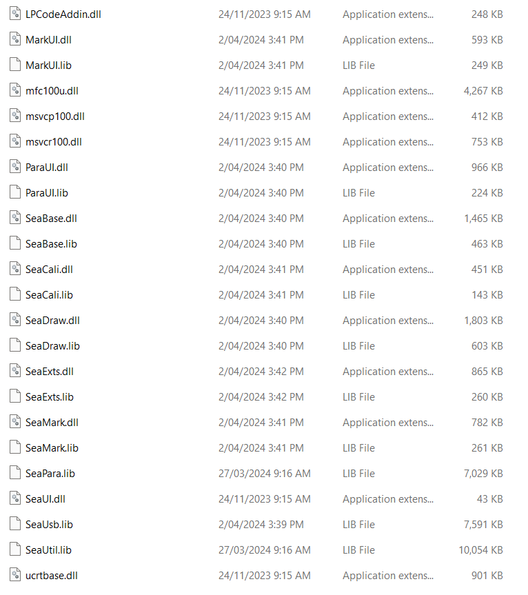

Below is what is on my thumb drive:
Thank you for this very technical support.
Yes, rather than the markcfg7 file, you should be looking for a BslCAD.cfg or LmcPar.cfg file in the “config” folder you see on your thumb drive. I would hope the .lbdev file Monport provided eliminated the need to load the .cfg file, but given the issue you’re seeing I think it’s best to make sure you try loading it.

When I press the frame button, the “Live framing” window appears. I then press start and the laser immediately etches. I believe it should frame at this point.
I checked the USB and can confirm it contains both BslCAD.cfg and LmcPar.cfg. My Lightburn installation doesn’t have an option to import the .cfg file - only to load a COR file.

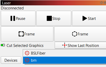

I have two lasers available within LightBurn. BSLFiber and bm.See image:
BM is the laser that is configured and the one that I use. I did a trial by changing to the BSLFiber laser, and when I pressed frame and then start the laser did not immediately etch but it did not frame either. Nothing happened.
So I am still unable to frame.
Also, I’m not sure if this is what is supposed to happen but I have a red laser that remains on at all times when the laser is turned on.
Your ongoing support is appreciated.
When the Live Framing window opens, the laser should begin framing. Pressing Start should cause it to fire, as you’re seeing, so that part is correct.
You will need to click Devices in the Laser Window, then double-click your “bm” device profile.
Click Next to keep the device type as BSLFiber, then click Import SEACad Config, and load the BslCAD.cfg file, then click Next and finally Finish through the rest of the wizard. Be sure to click OK to close out of the Devices window at the end. If you click Cancel or X-out, the changes will not be saved.

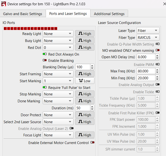

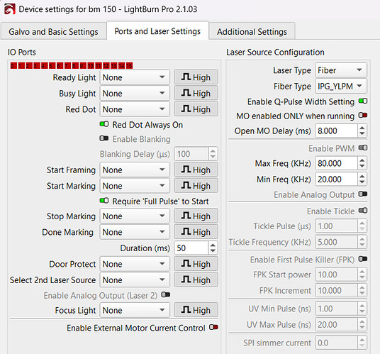

The below image is the port and laser config, after I uploaded the LmcPar.cfg. When you said instead of. the ScICAD.cfg… what I did was…edit my laser (which had the ScICAD.cfg imported to it already and then imported the LmcPar.cfg over that profile. Is that correct?
After downloading the LmcPar.cfg file the laser did not work, the framing did not work, there was no sound.
The below screen shot is the BM 150 laser with the ScICAD.cfg uploaded and in this configuration there the laser does not frame or etch and there is no sound.

The first screenshot, with the LmcPar.cfg file imported, looks the most plausible to me because it has actual port settings (and 0 is a common Red Dot port for BSL-based lasers).
Obviously it’s a problem that it’s still not framing or firing with that configuration but I suspect that’s getting us closer to correct.
With that configuration loaded, can you try disabling Red Dot Always On and see if that helps?
One other important question - with that configuration loaded have you verified you’re successfully connected to the laser? You should see “Ready” in the Laser Window if so.

With the LmcPar.cgc file imported the laser will not connect (I previously didn’t notice that). When I switch devices to the alternate unconfigured laser it automatically connects to that one but loses the connection every time I switch back to the BM 150 configured device. Device setting screen shot image is below.
Could you please let me know how to enable this connection? Thank you.
Once I am able to connect, I will disable the ‘red dot always on’ tab under that profile and run a test.
Thanks.
The first step is to check the serial port dropdown menu and make sure you have the correct COM port selected when you are on the LmcPar.cfg device. You can find that in the Laser Window.
