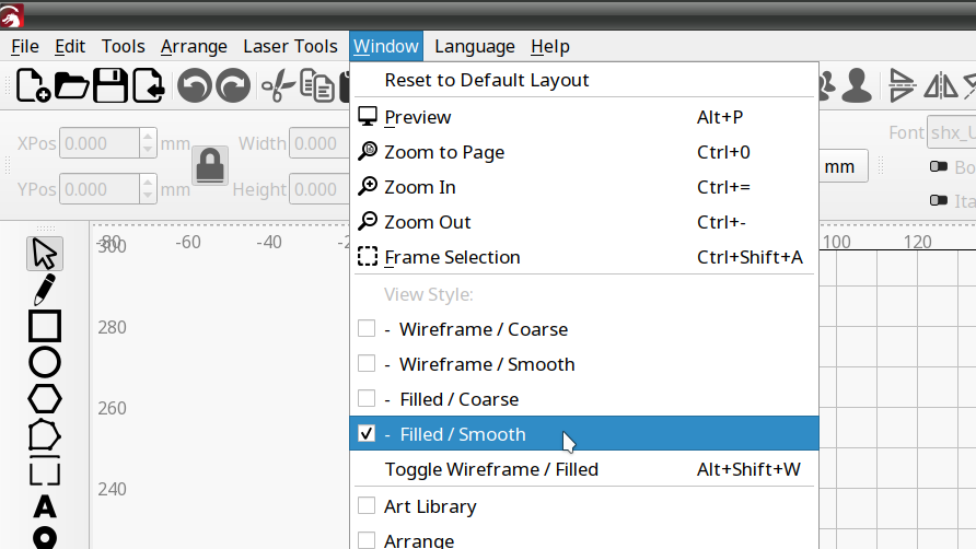

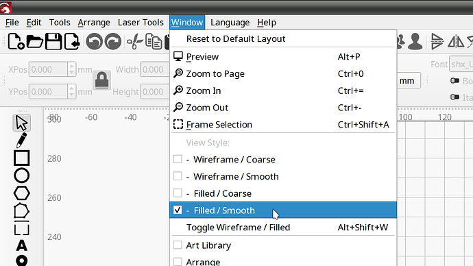

When I select "fill" it does not show up as filled on my project or on project preview. However, when I do the actual burn, it is filled
Perhaps this will do what you expect:
