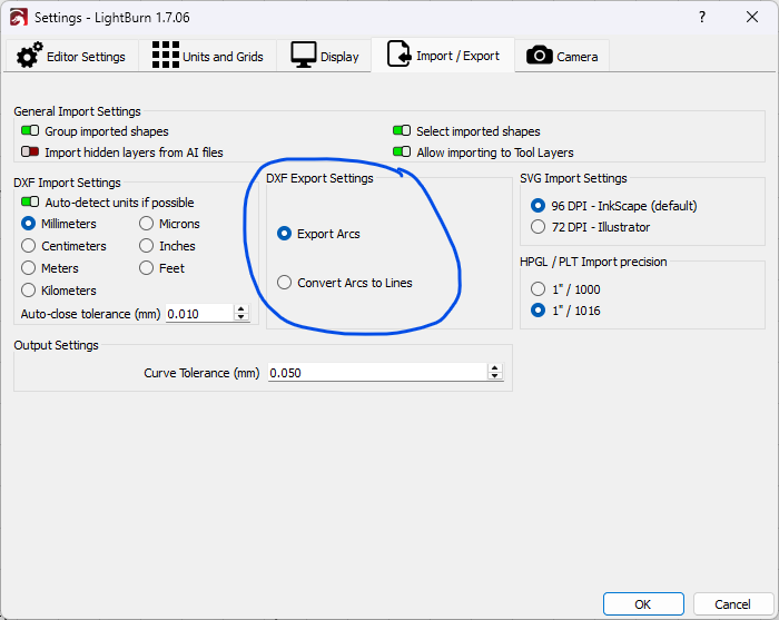

Just to be on top of things, check the settings for Import/Export. Mine is set to arcs, but the other option is Convert Arcs to lines.
Check this setting:
One word is worth a thousandth of a picture, but I used words instead of pictures.

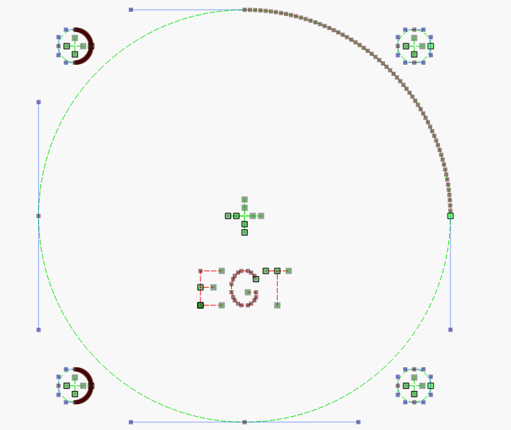

If you create circle entities in LB with the circle tool and don’t convert to path, and export to DXF, LB exports DXF circle entities regardless of whether the DXF export setting is set to export lines or arcs. The setting s/b set to “Export Arcs” if you don’t want too many short line segments representing arcs. The problem happens when you arcs in LB are bezier curves. LB has to approximate them, and does so with short line segments that are polyline shapes. If you draw a closed shape with the straight line tool, and use the radius tool on the square corners, LB does a pretty good job exporting DXF arcs, but will break some of the arcs up into 2 arcs, which is typical for graphic programs like Illustrator and CorelDraw.

Here is an example of the issue.
The circle has one quarter of it (o degrees to 90 degrees) as multiple polylines while the rest of it remains fine.
The drawing was created in Lightburn, Exported as a DXF, and imported back in to Lightburn.
Have you checked that arcs are selected instead of line segments?

Hello. Yes “Arcs” is selected.
You are not drawing perfect circle entities in Lightburn. Lightburn exports perfect circle DXF entities if you draw perfect circle entities regardless of “Arcs”
