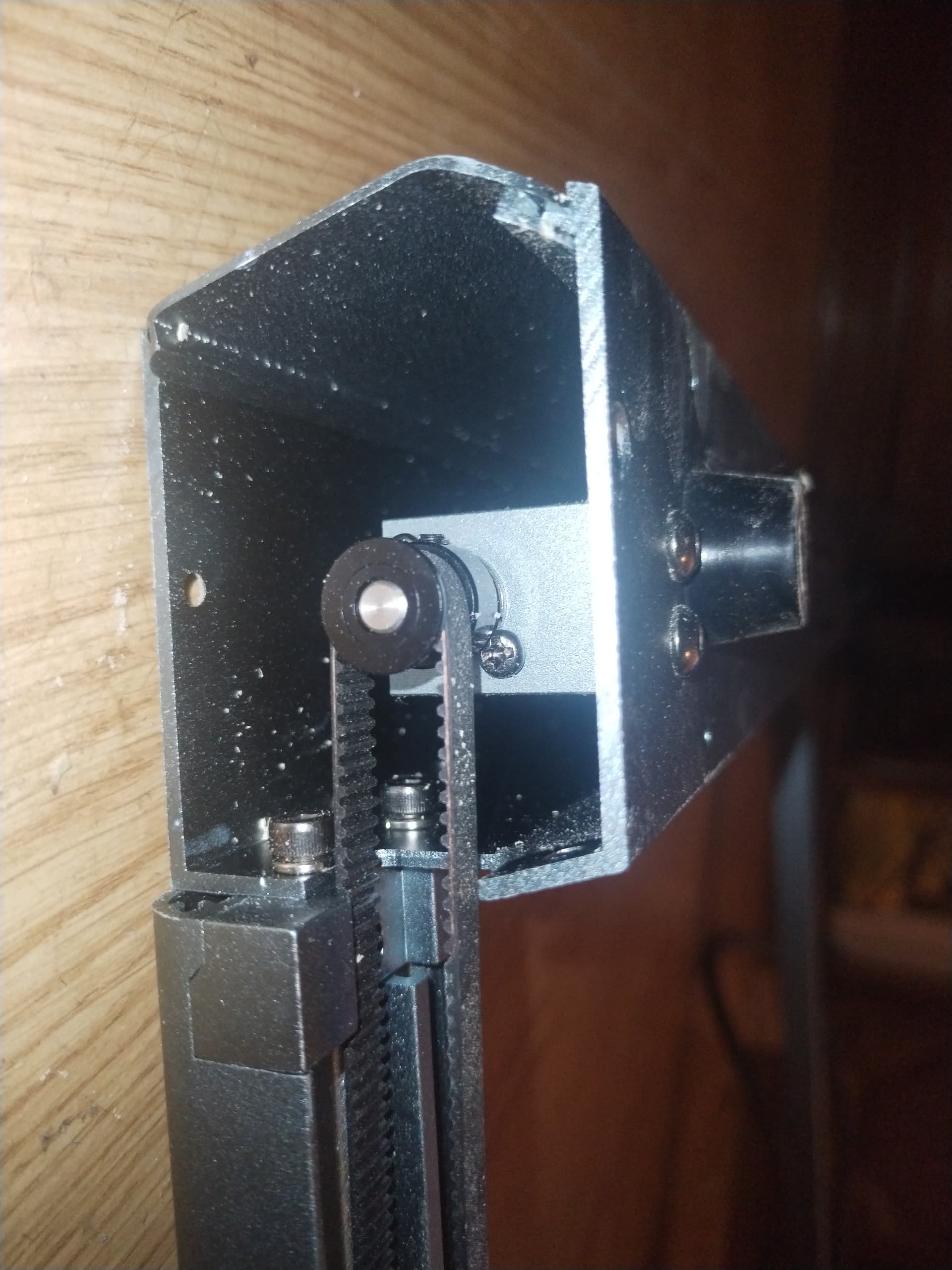

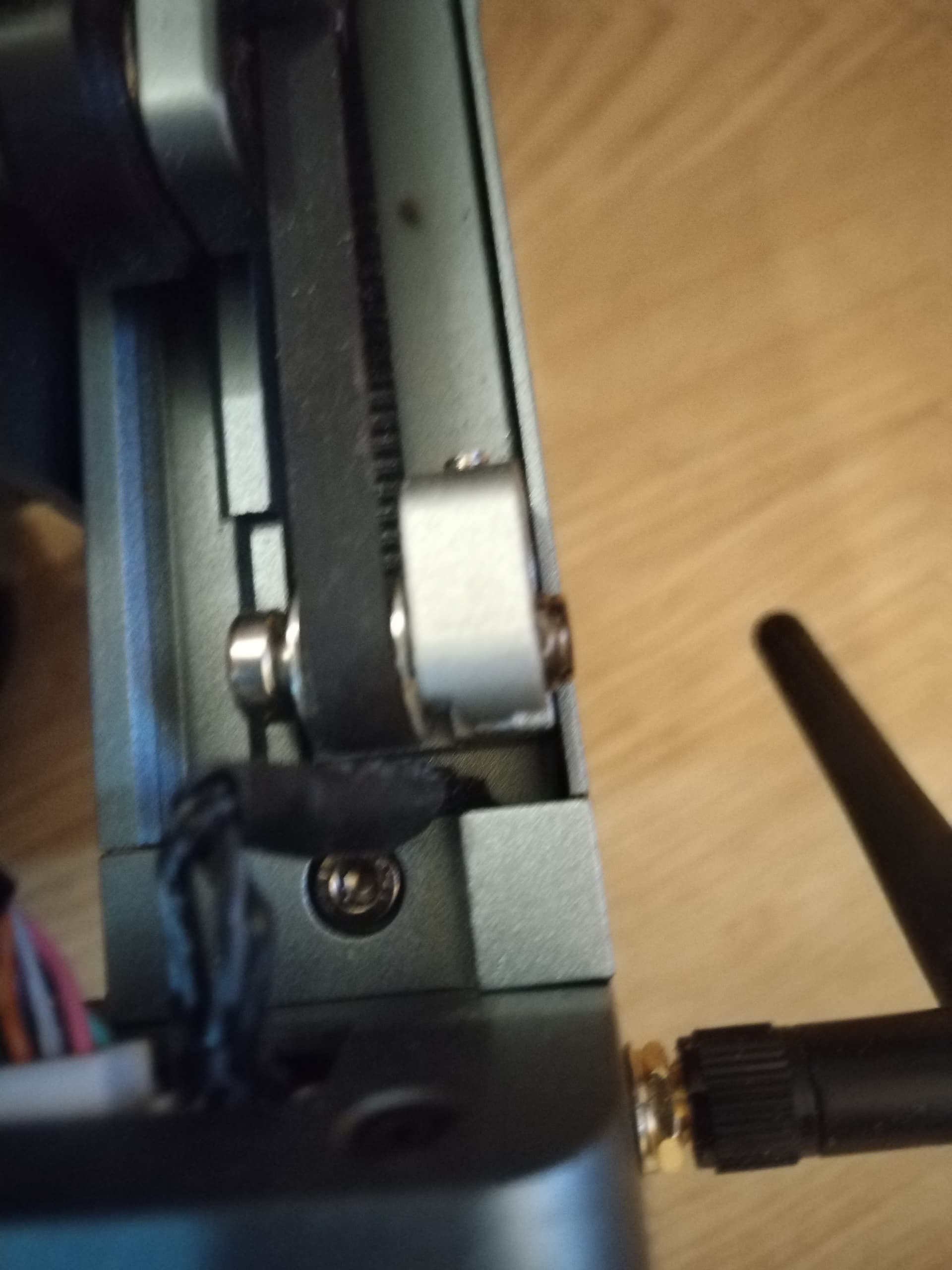

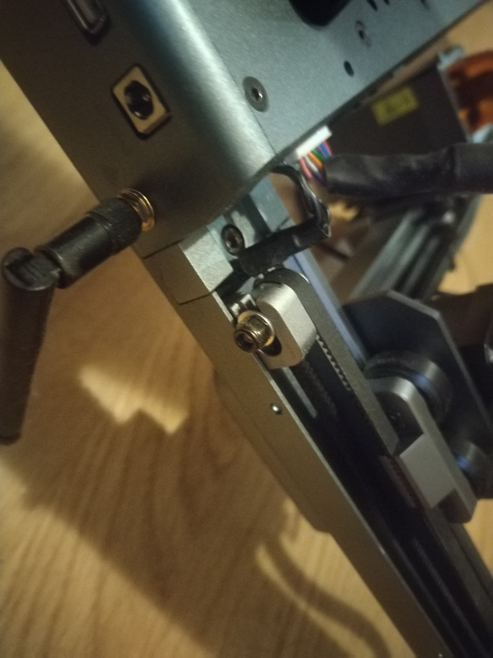

first looks like im not able to post video of homing my laser here, second i noticed that one of belts on my lasers are not tight as others and third could you please write in simple steps what exactly i need to i would appreciate your help!
post image of your belt tensioners, both sides
images should be ok to post
I can then scribble on them
Videos need to be uploaded to a 3rd party service and link posted here (ex: youtube)

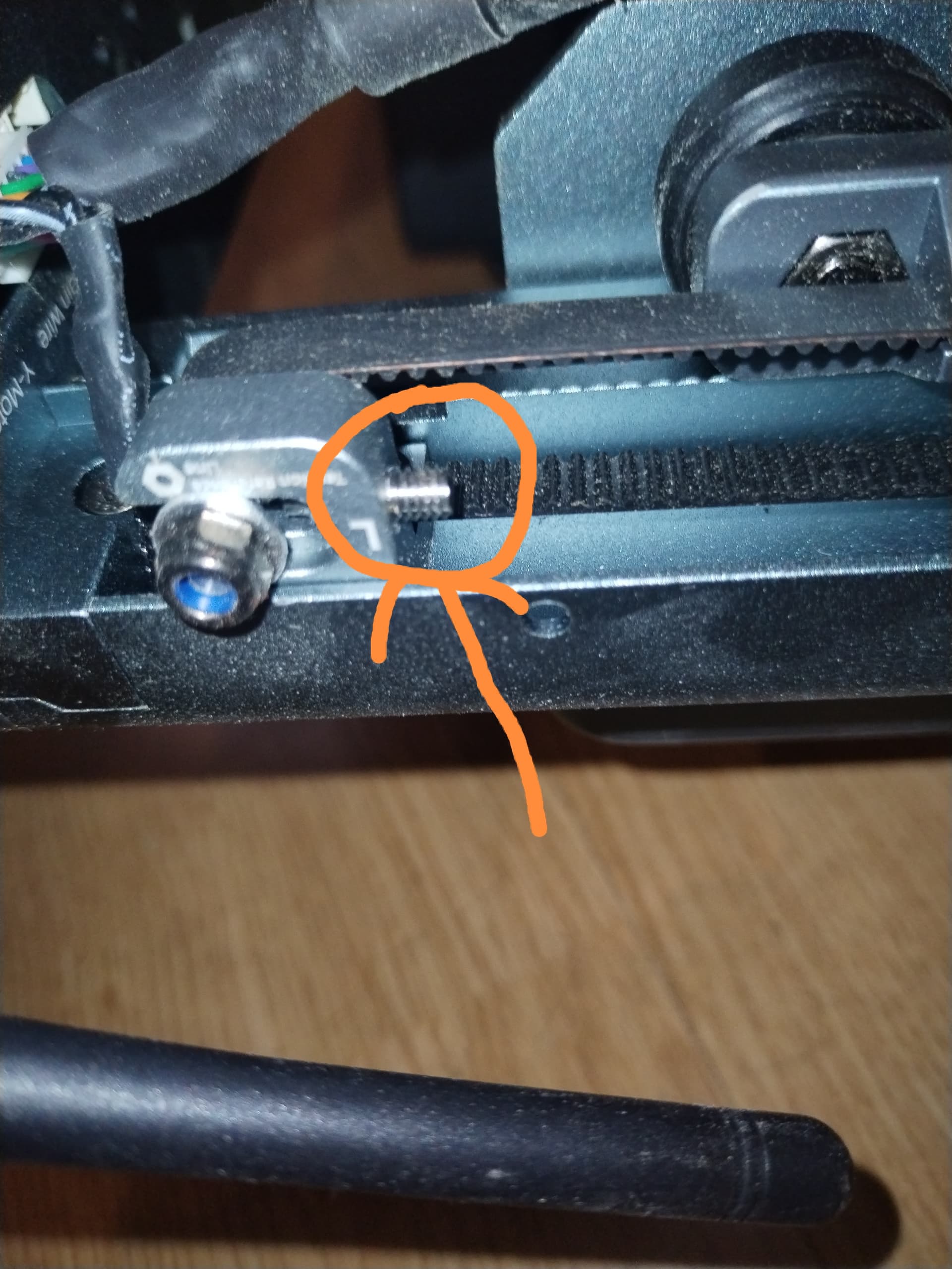

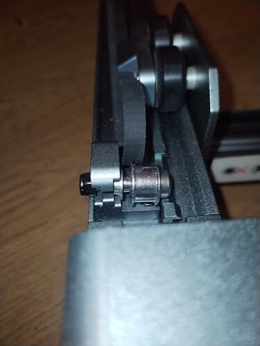

. i assume this is what you wanted me to show you

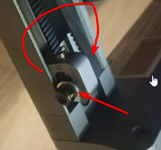

Your problem is here
The washer is in the wrong side
It needs to be in the inside
once you fix this, tightn the little screw on the back until is flush with the bracket
Shoudl fix all

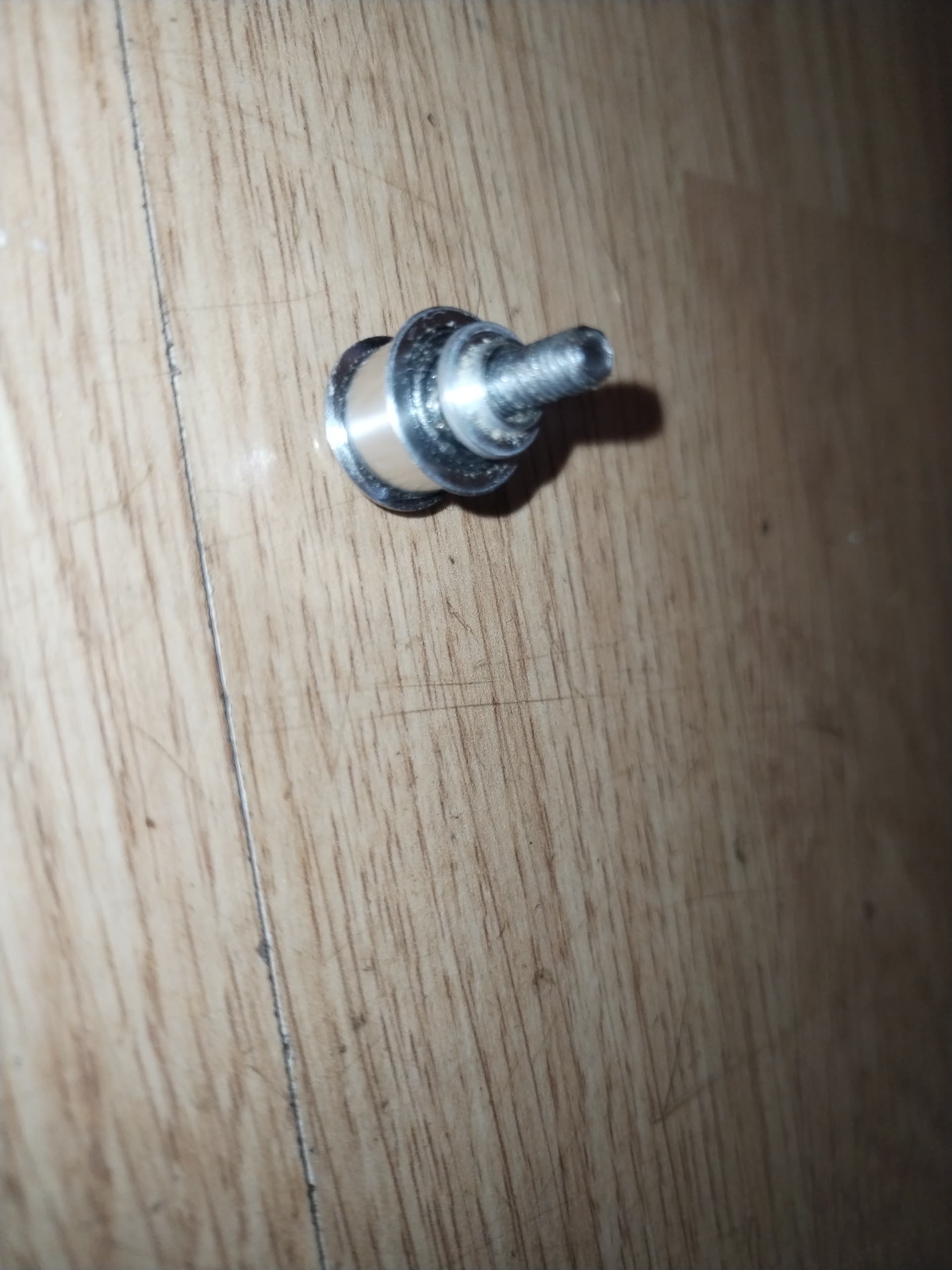

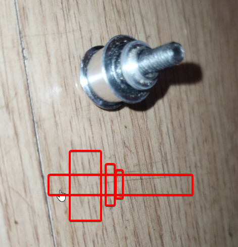

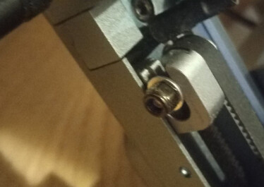

i found that litthe screw on the ground! do i just need to screw it in how i want or there is specific measure how much i need to screw it?
i think a pictur was missing there. what little screw?
this scew you were talking about?
yes you definitly will need that screw on each side
But first you need to fix the washer

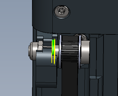

washer is the metal circle with hole i assume, so i need to reassemble whole laser or?
Correctomundi! :slight_smile:
must go from the outside to the inside
and look like this
Green highlighted part is washer

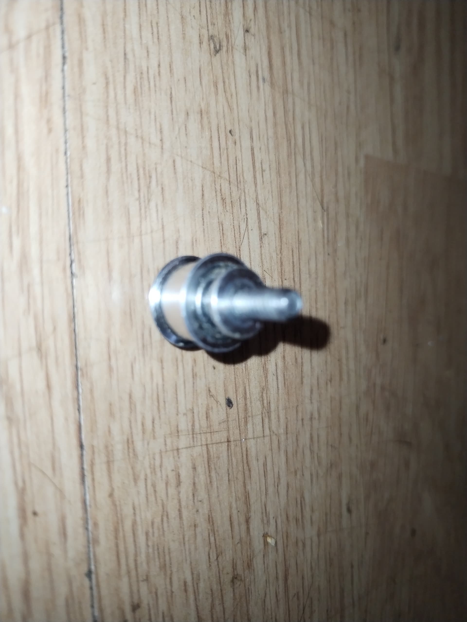

the washer goes like this or like this?
. flats side of washer looks at the wheel or dont look at it?
Flat side touching the roller, othe side facing the bracket

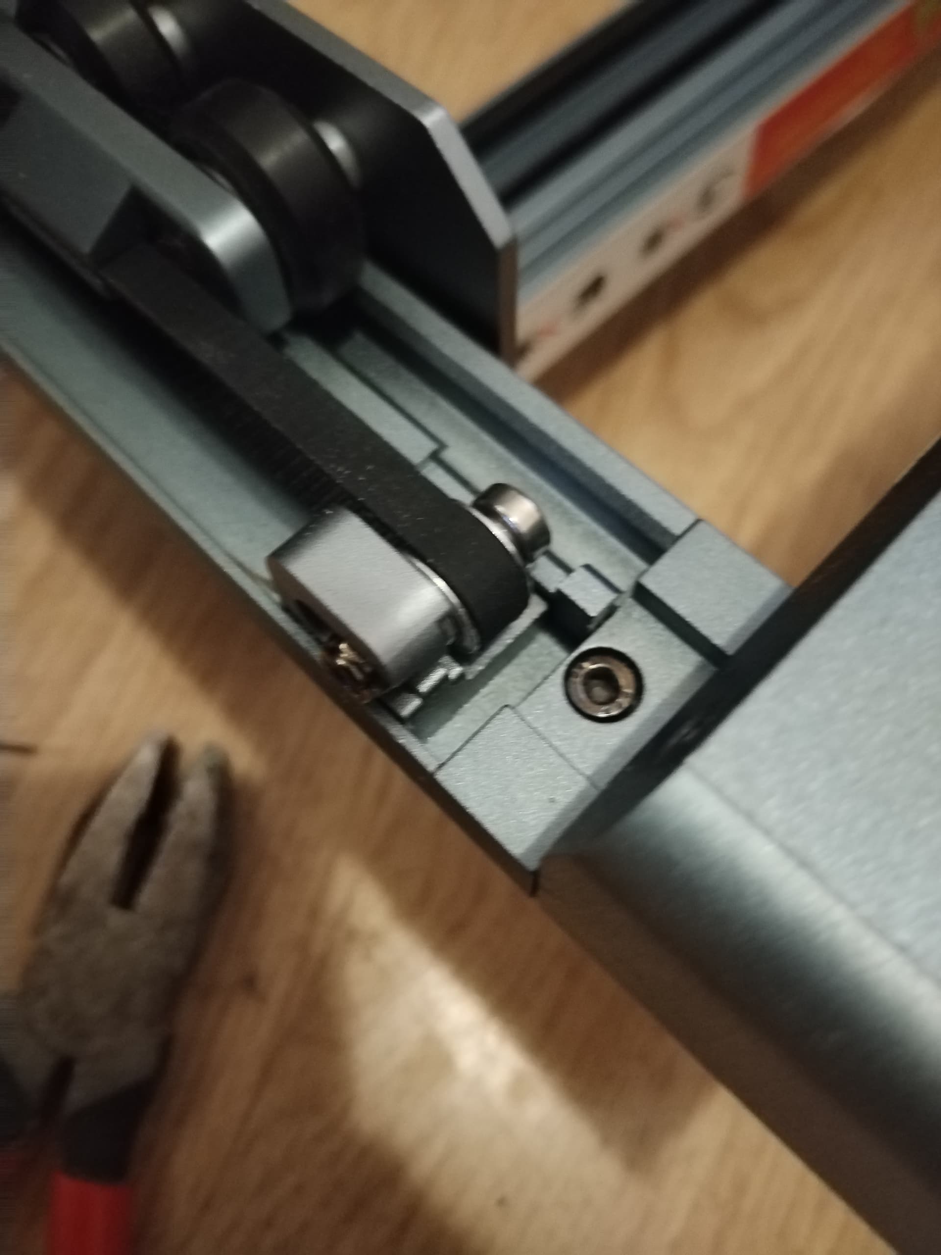

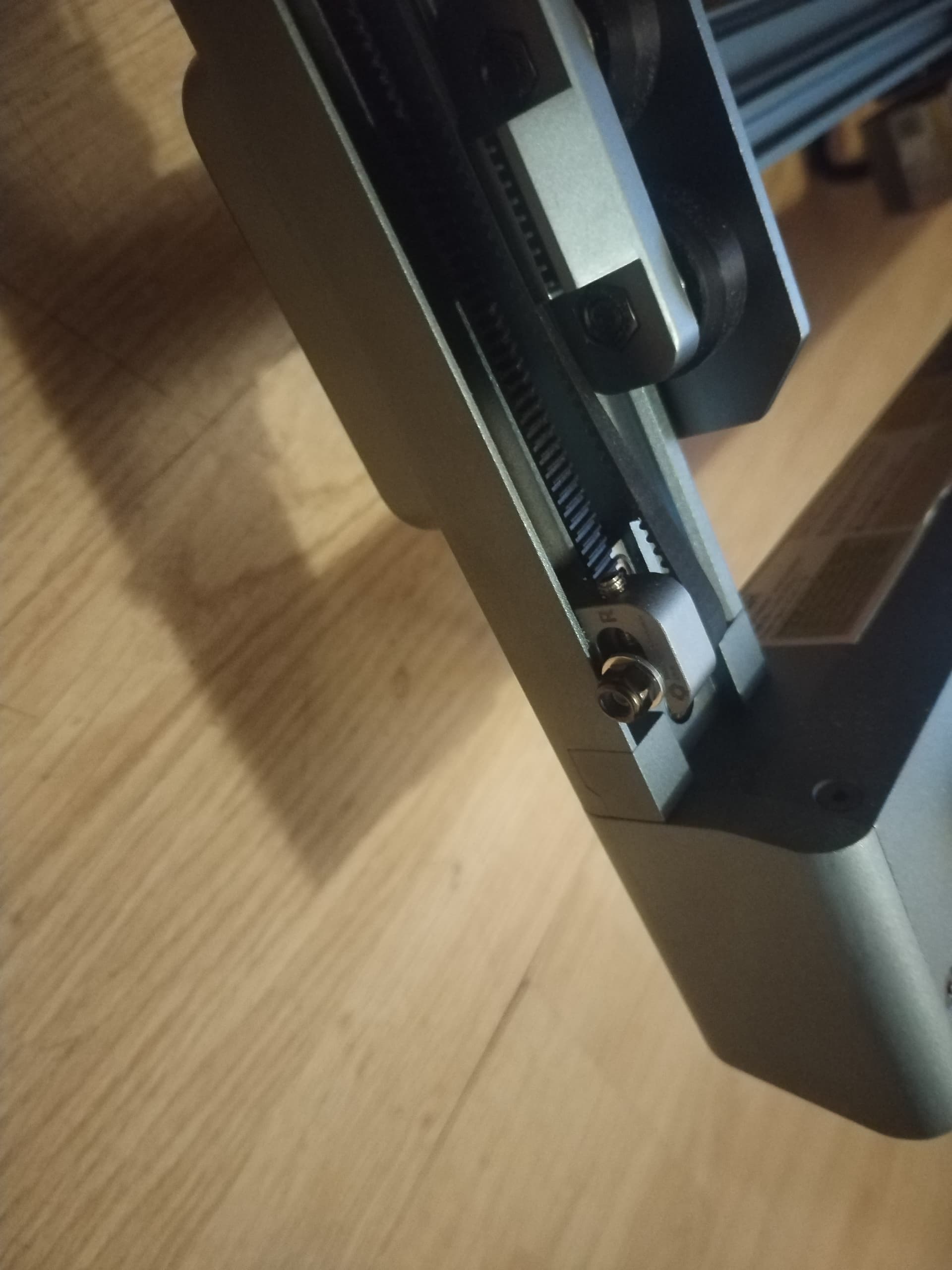

the black screw doest have much to hold on is this the right way?
that is the way. remember to put the belt FIRST
then adjust the little screw on the back
And then tighten the big screw so the roller is snug. not TOO tight just snug

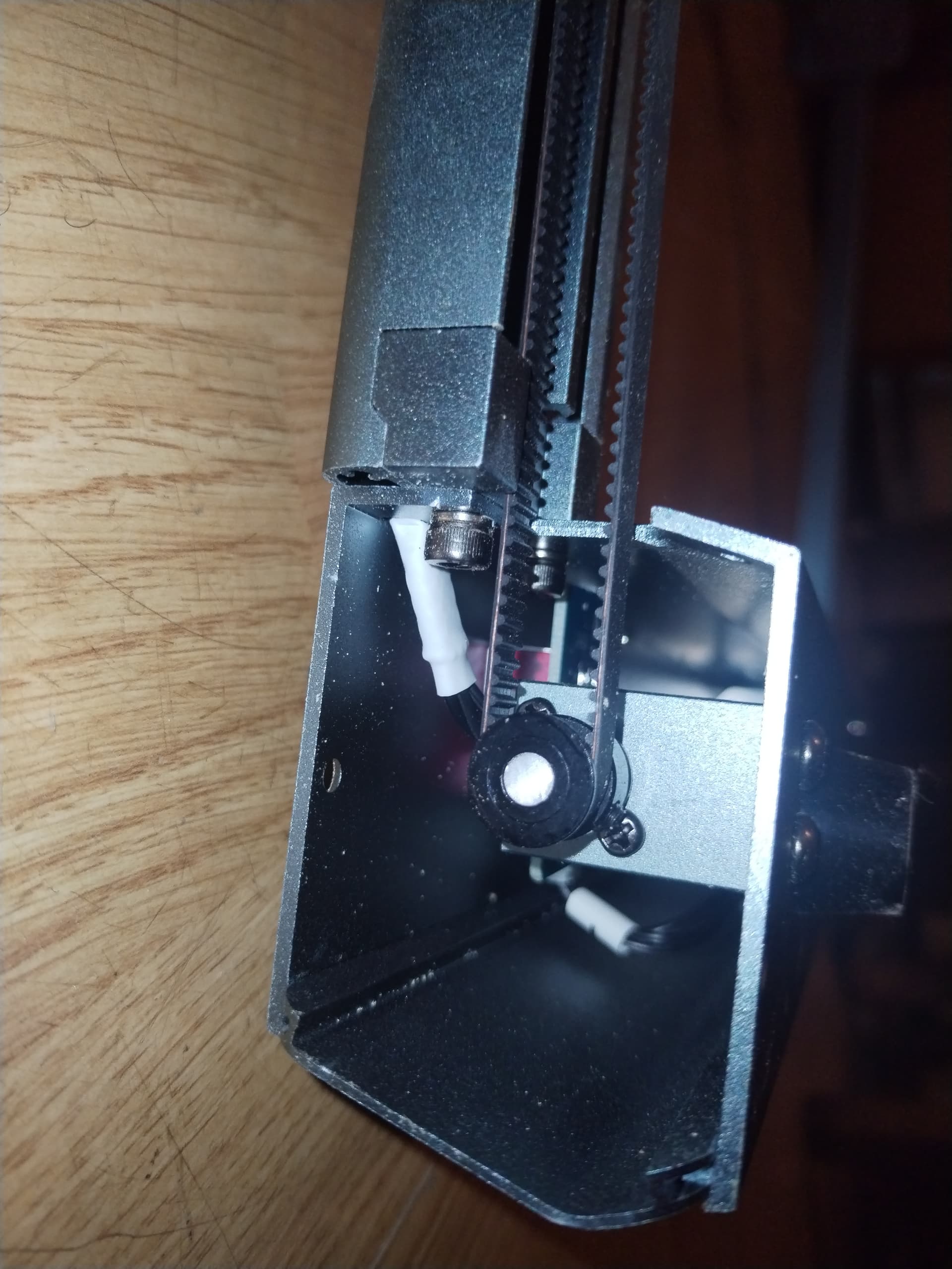

take a look and give me your opinion, one more thing laser worked before this was fixed so are you sure that this is only source of my problem?
perfect

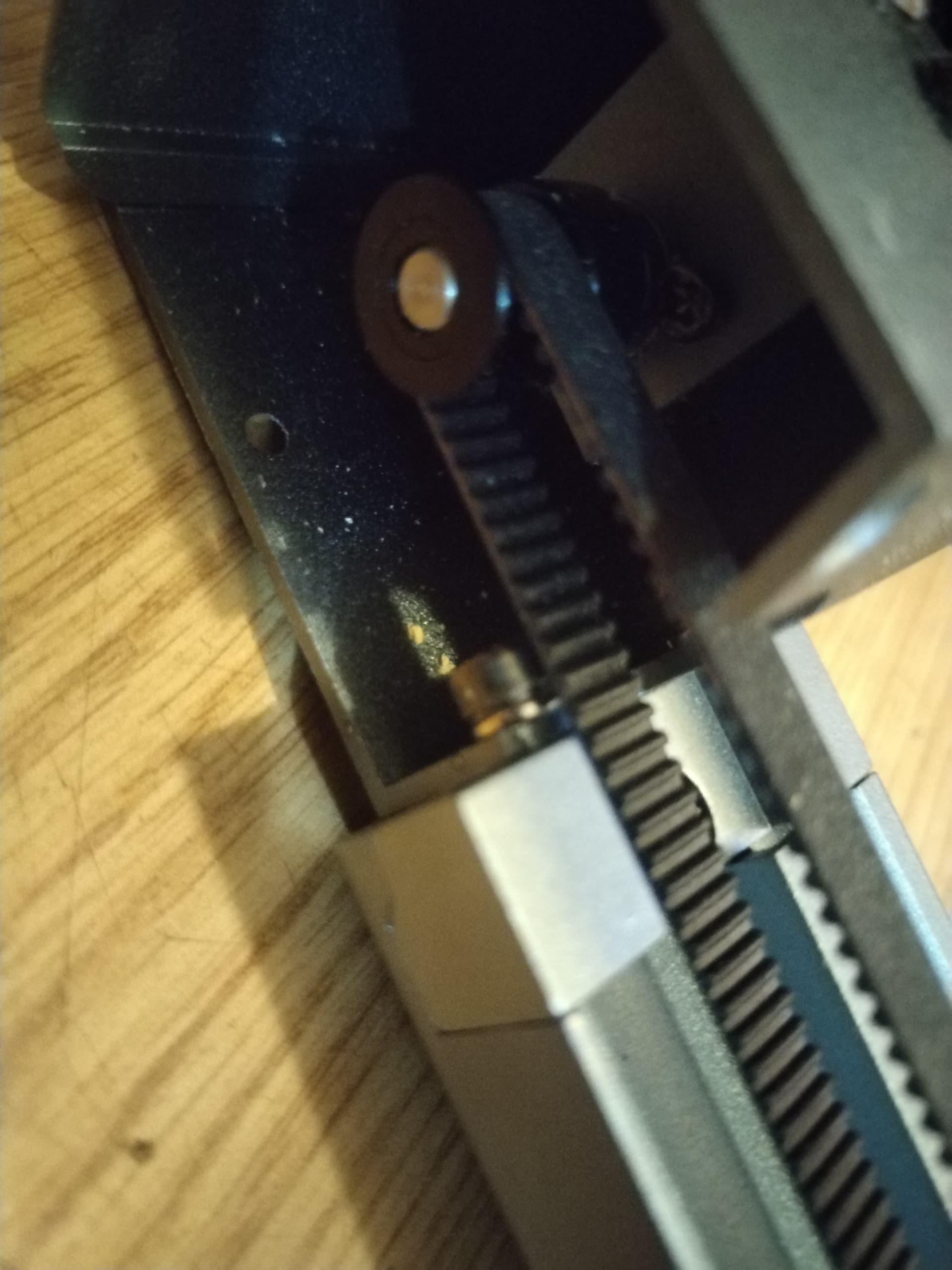

2 steps missing now
a) At the very back, where the belt sprokets more (motor size back of machine)
as you have them exposed, make sure the sprokets (black round bits with teeth) dont move UP and down the metal shaft and are perfectly tight and snug
if yes
b) Remove the belt from the sides of the X axis
Move X all the way to the back and make sure BOTH sides are touching the stops
(maybe ask someone to hold it there for you)
then put the belts back in the side brackets
This will ensure your X is square to the frame
c) move head to center
Plug power,
Check KEY to on, and emergency swith is not pressed down
power on machine and watch homing. should hit the lett/front corner, pull back and touch again
Then LED should go GREEN
you ask me if these parts move up and down?
Hold them and try to push them up and down the shaft
They SHOULD NOT move, but just triple check
