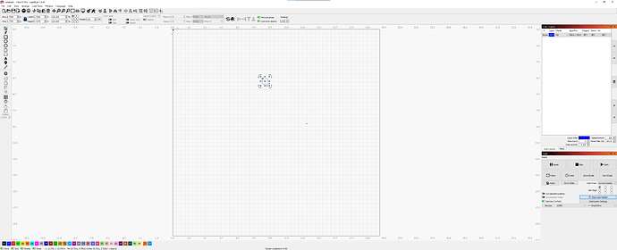

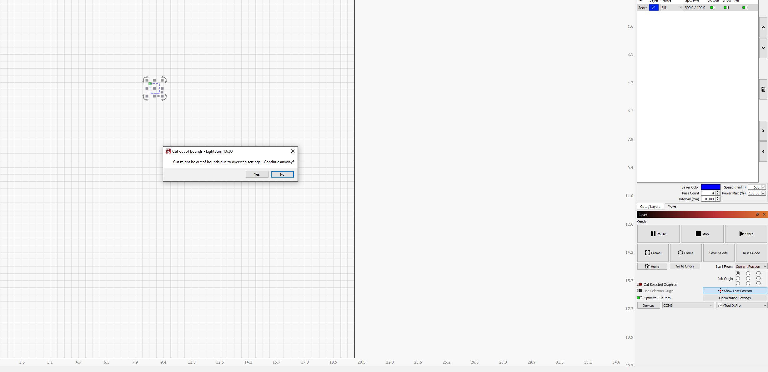

Hello!
I hope I can get some help or someone shine some light on my situation. I have a xtool D1 pro with a laser tree k60. The laser works fine on the XCS. The issue is when I got to light burn and use Fill. It’s gives me a overscanning or cut out of bounds. I used the same design (a circle) on XCS and light burn but lightburn gives me the problem. When I press the start button the laser moves very slowly to the bottom left corner. My home positions is too left and it homes perfectly fine. Also the projected time goes into negative numbers. I just got the K60 works good on XCS but I would like to use light burn. Please help!

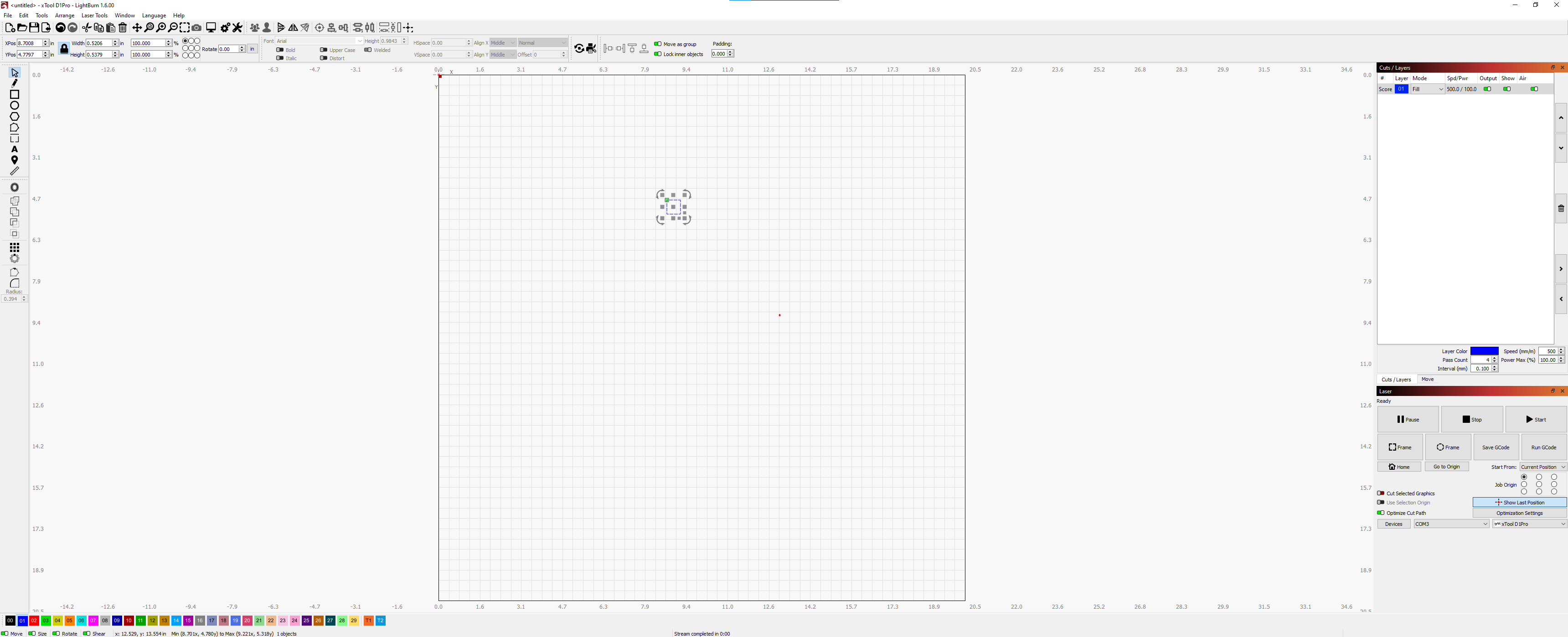

@JessN Yes, I do have a xtool d1 with a laser tree k60 mounted. This set up works fine one XCS, also does well with light burn until I do the fill mode. Please see attached for over scanning
 ![image](https://forum.lightburnsoftware.com/uploads/default/original/3X/d/9/d9ba5602b1068c926d55570c4ab5e01dce51d488.png)
 ![image](https://forum.lightburnsoftware.com/uploads/default/original/3X/5/1/51b88393f06a7ce9b644e87d65e6d7666d88ac53.png)

Yes makes sense but I tried adjusting the Over scanning setting and I still get that pop up and when I press continue the laser moves slowly to the bottom left corner. not engraving no laser is fired just jogs over to that bottom left corner

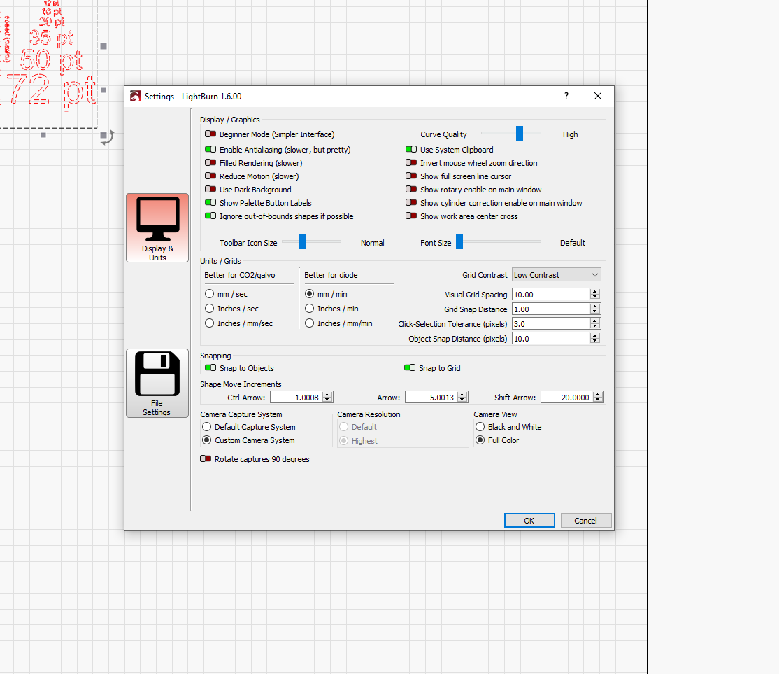

Could you have Lightburn set to mm and the laser to inches?

Where can I find that option?

![image](https://forum.lightburnsoftware.com/uploads/default/original/3X/0/5/05fb3dbbe00bb3bf3553da24410e613798ad34fd.png)
