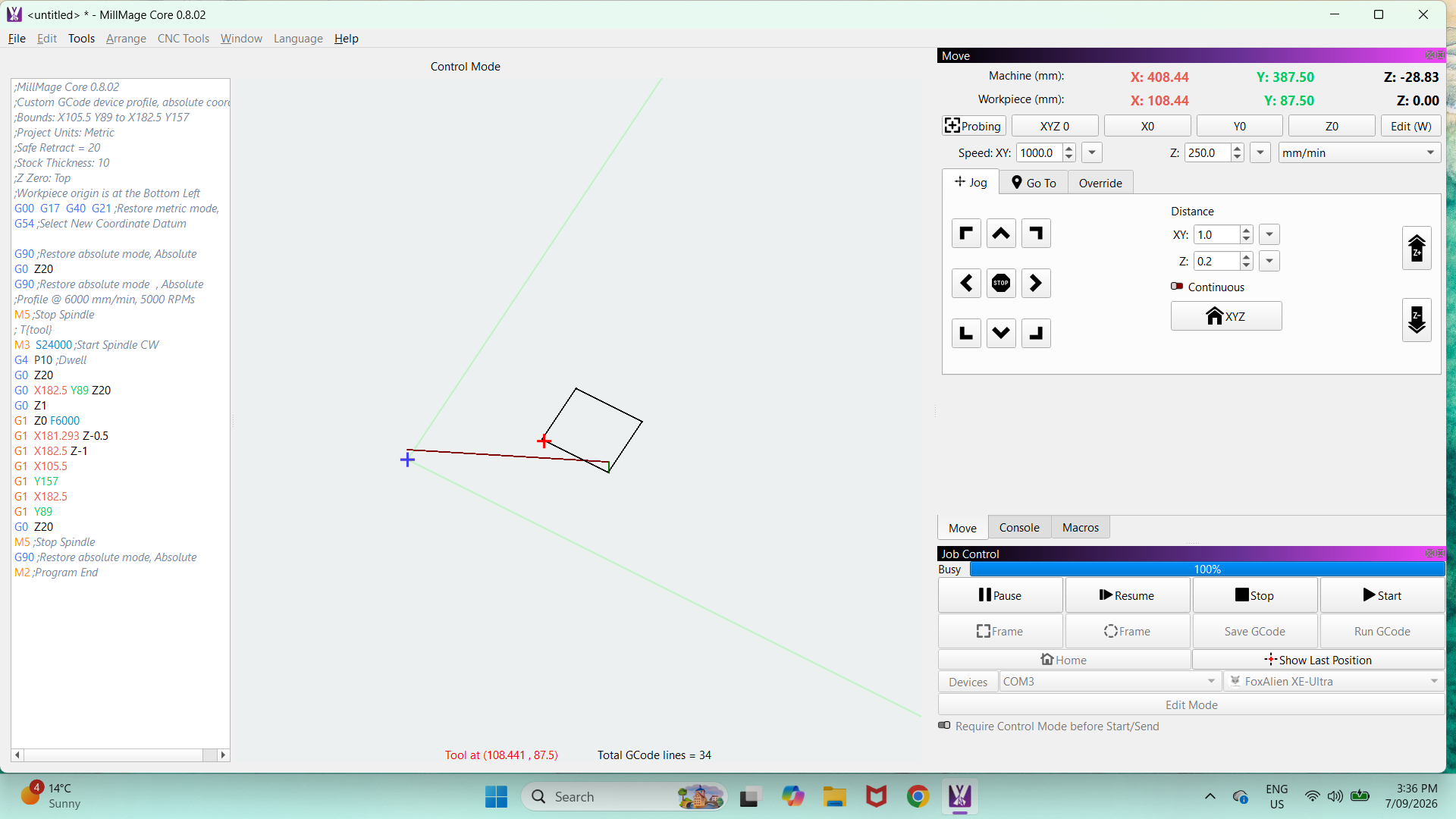

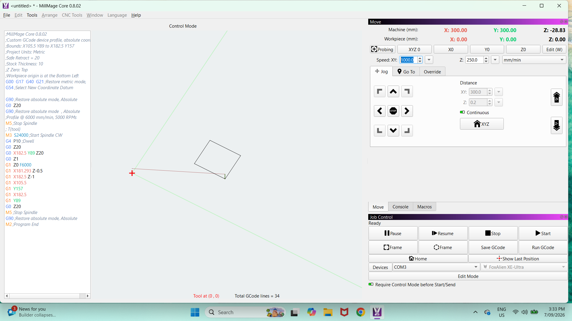

when i start a job after zeroing X Y Z the spindle want to go to where the job is on the workpiece that I have on the screen not the cordinance
it seems to flip my job over to the right than to the rear
Are you saying it engraves backwards, or is it not starting where you think it should?
what cordiancess are you talking about ?
going to where job is on workpiece on screen is normal
are you new to cnc ? are you treating it like a laser
if so i think you may be misinterpreting how workpiece works

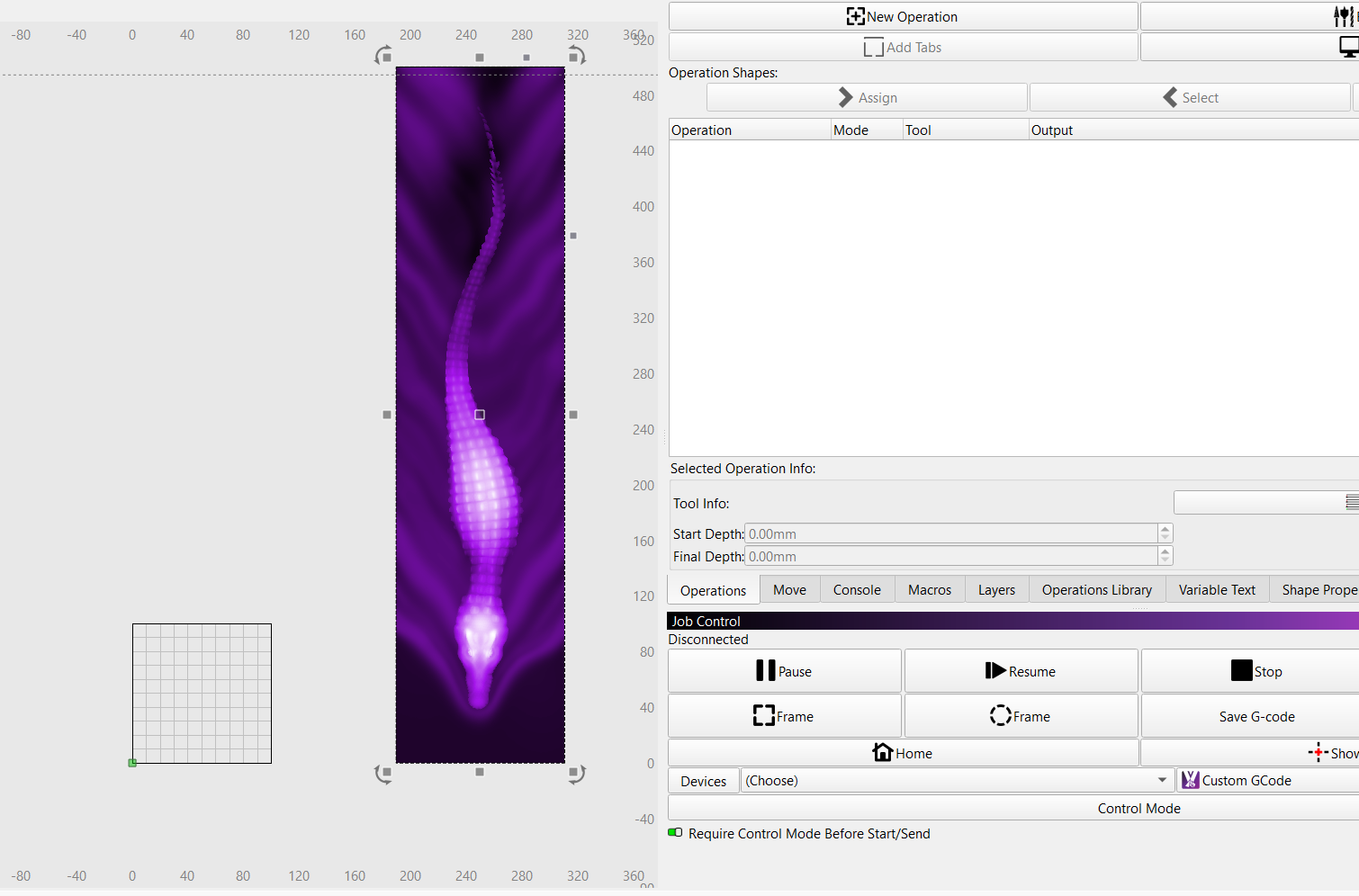

is this the scenario of whats happening say your bed is 600x 600 , you create a work piece of 300x 300 ,design is in center of that workpiece you drop the board on your bed say in centre, but when you start job spindle dosent go to where board is ?
the reason being is MM works off your project size not your bed size
there is a way to achieve this with a template
this is template i use it is full size of my bed. 2400 x 1200 the blue square is marked out on my table and shape is lock on the template , when im doing small pieces i drop them there and probe from bed

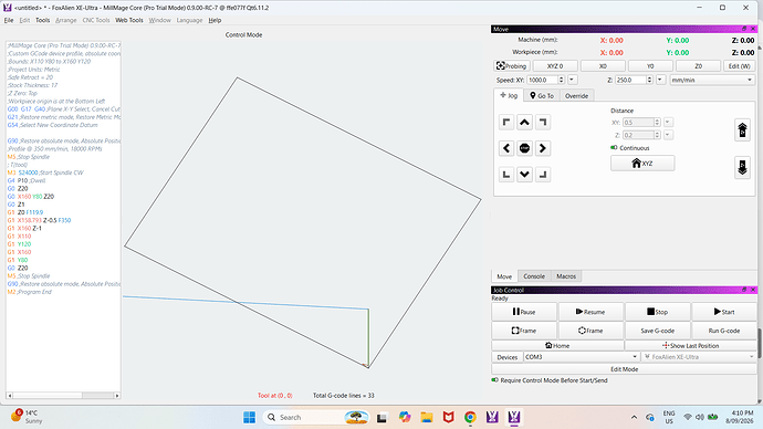

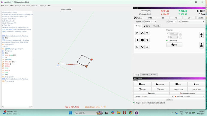

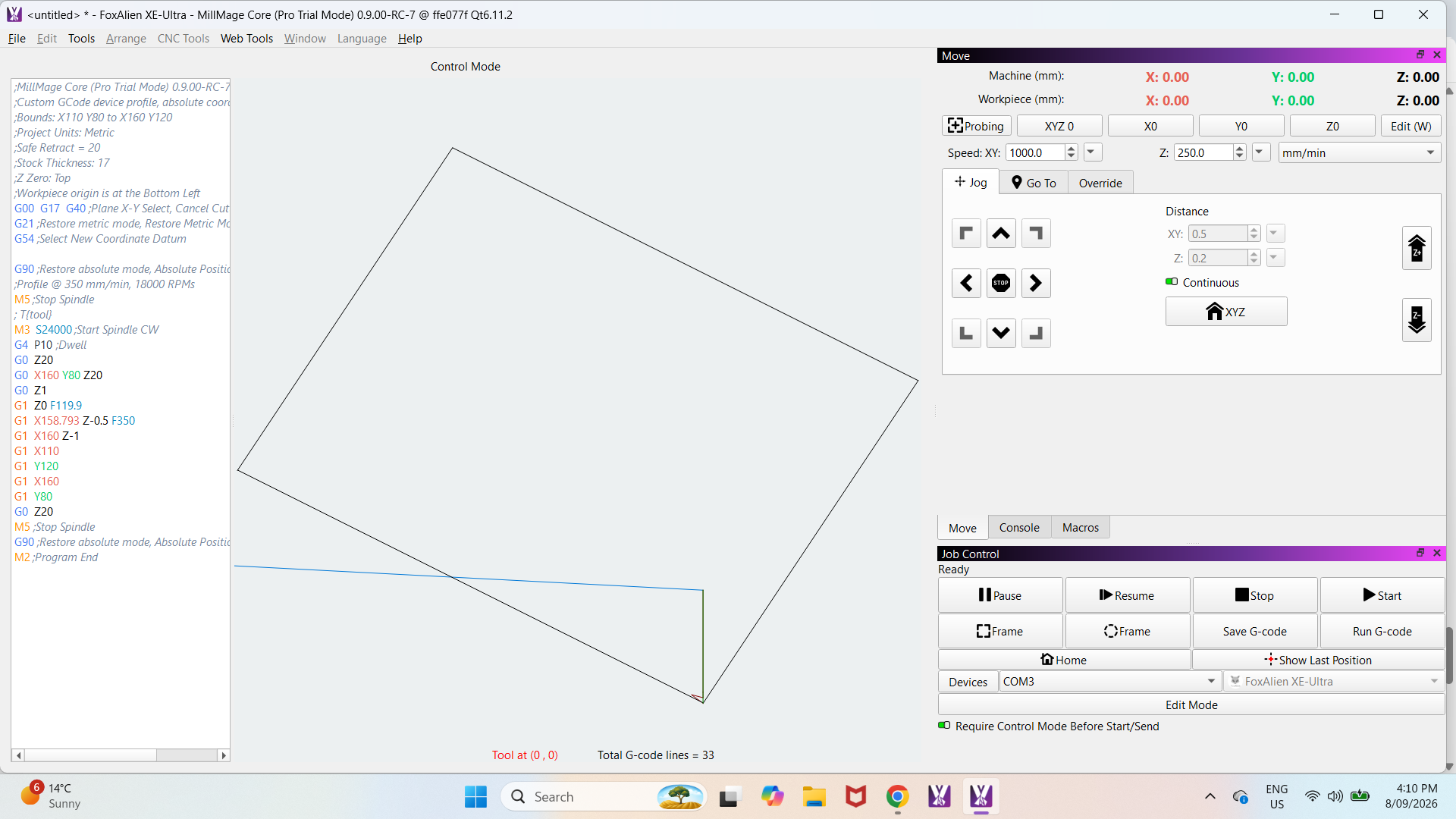

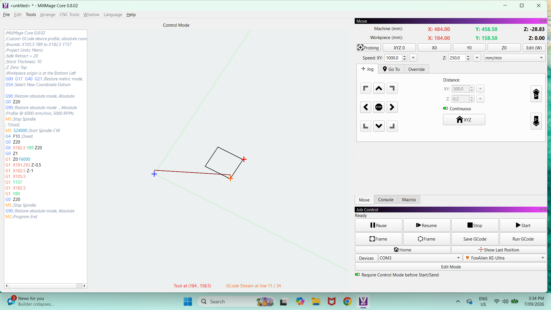

As per photo I zeroed the spindle over the workpice at X300 and Y300 on the material,
When I hit frame it starts at x108 and Y 87 and finishes at X184 and Y158 not where I wanted the
job to be cut on the material.

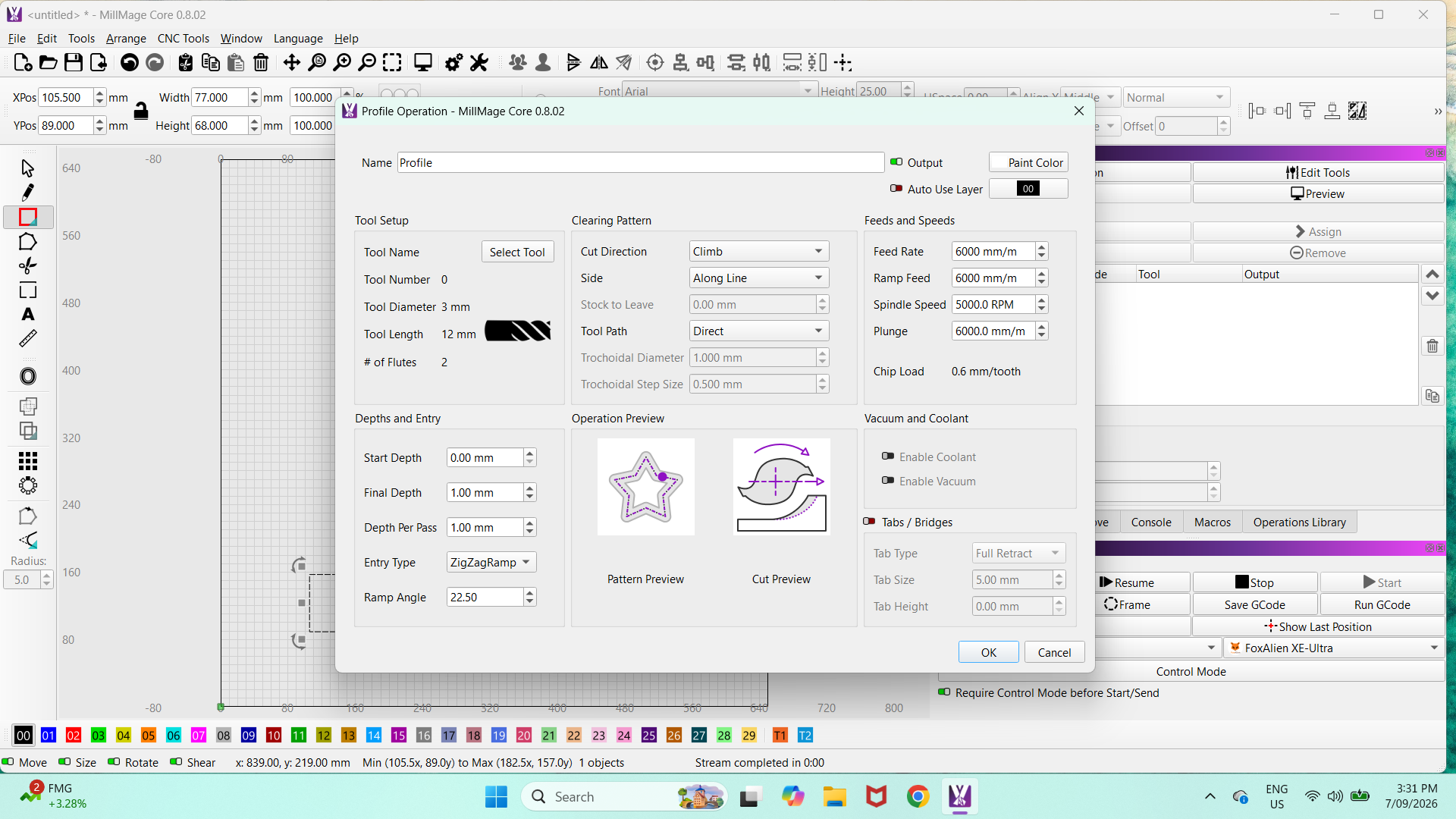

Also my spindle speed is set to 5000RPM but it max out at 24000RPM. VDF set to PWM.

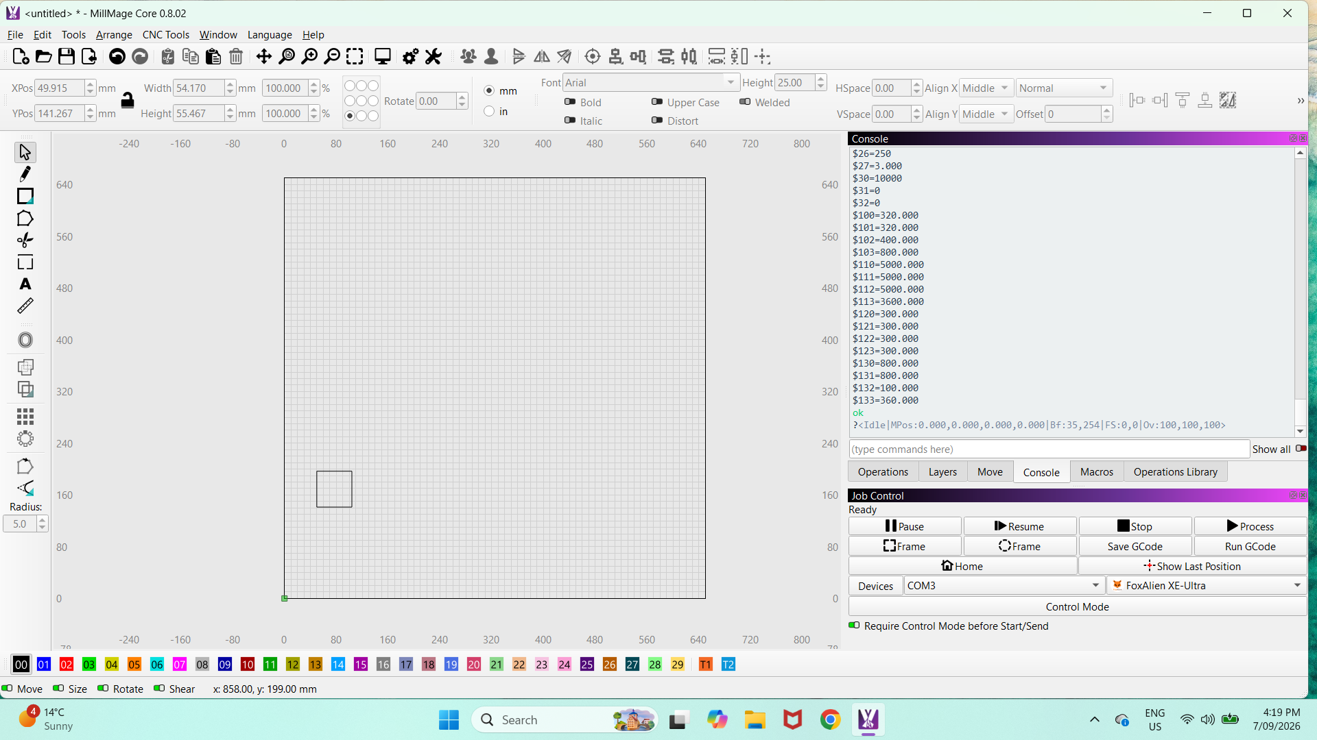

Screen shot of my console settings
Without the .mage file, we have to make some assumptions based on the postings in this thread.
  1. Your machine bed is 800mmx800mm.
  2. Your workpiece is (about) 650mmx650mm.
  3. Your design front left corner is at X108, Y87.

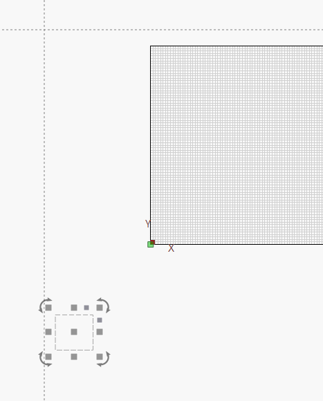

  4. Your orgin went from to 0,0 to 300,300, which is now 0,0.
  5. Your machine front left corner is now x-300, Y-300.
  6. Your design is 76mm wide (X) and 71mm high (Y).
  7. Your design front left corner is now X-192, Y-213 (see image).
  8. When you Frame the design, the spindle will go to this new position of the design.
[1] You did not show us where it actually goes in relation to your machine table, so I cannot improve on the math calculations.
[2] You did not provide the .mage file, so we cannot use your actual settings for testing.
[3] Is it possible leaving the Origin alone and using Absolute Coordinates will simplify the setup and operation of your projects?
[4] If you want to do it your way, then you must have a good grasp of coordinate systems, graphic quadrants, and machine geometry.
[5] If I said anything you feel is insulting, that is not my intention and I apologize. But I did say assumptions would be made based on what has been provided so far.
Hi, my fault, all OK, I was used to using lightburn and setting the start of the job with the laser head.

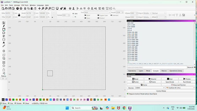

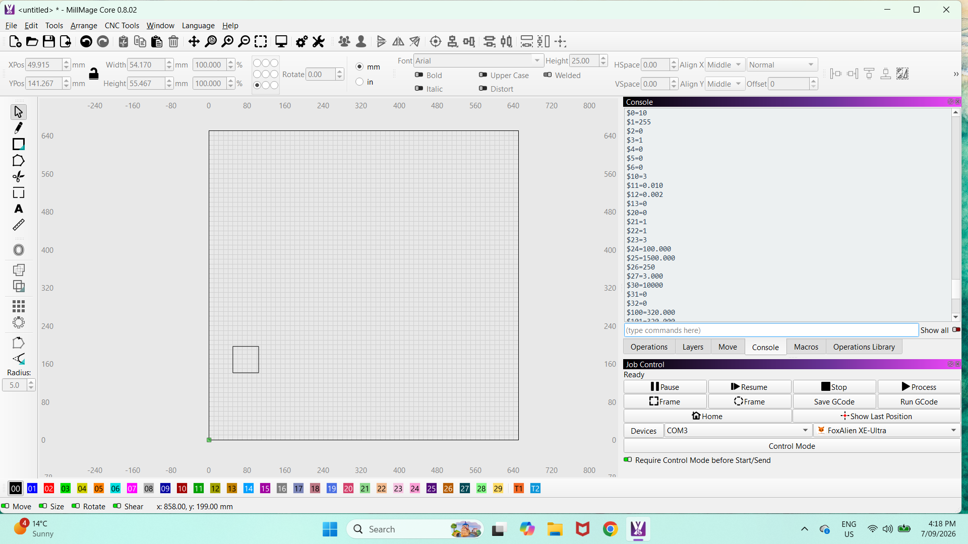

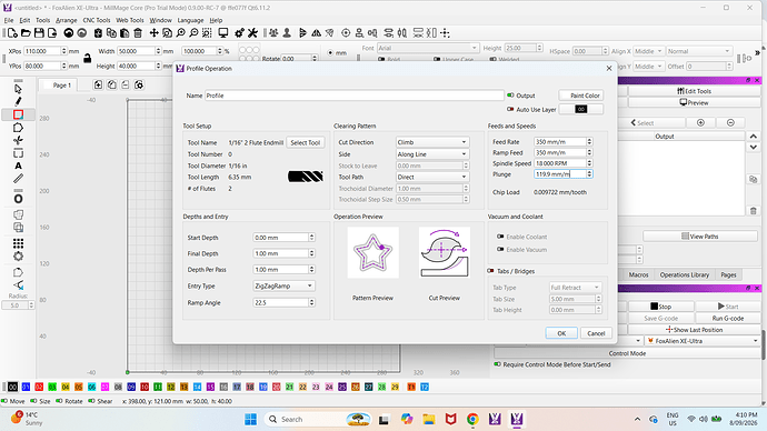

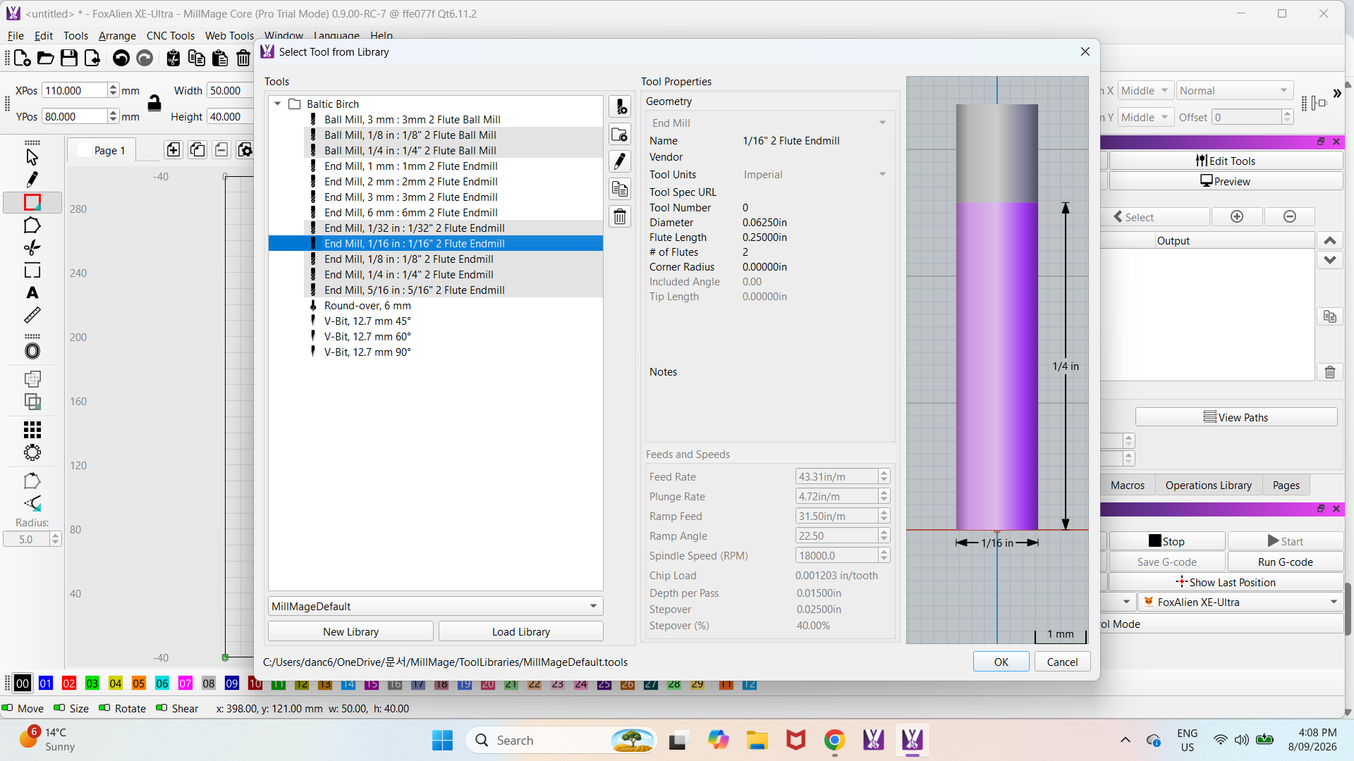

the only problem I have is the spindle speed. I set it in the tool selection but when i start the job it goes to the full 24000rpm. The only way I can slow it down is in the override section when the job starts.
I have a VFD 1.5kw spindle.
$30=24000
G Code tool on M3 S24000 G4 P10
When I hit Process I don’t get the speed and feed down the bottom.
Yeah, that is both a blessing and a curse. :rofl:
@wanderingtruckie asked what machine did you have, but you did not answer. Some mills have VFD drives that are not managed by the controller, so MillMage cannot manage it either. But…
This indicates that MillMage CAN control it. Now the question is, “Where are you setting the spindle speed?” If you set it as 24kRPM in the tool definition area, that is what it will run. And you can override it in the Move window while running, as you discovered.
If you want to use the same tool on different materials, where different speeds are required, then you can define it as another tool with different speed settings, or chip loads. You can even define all your tools into a new category in the Tool Library. It is quite flexible when setting up.
You likely know all of this, but we will get a lot of new users reading these MillMage posts and might benefit. :grin:
It appears you assigned 18,000 RPM to a tool, but it outputs 24,000 RPM. That is a different issue that requires you upload the .mage file so it can be investigated. What I do not see in the GCode is a tool selection (tool number).

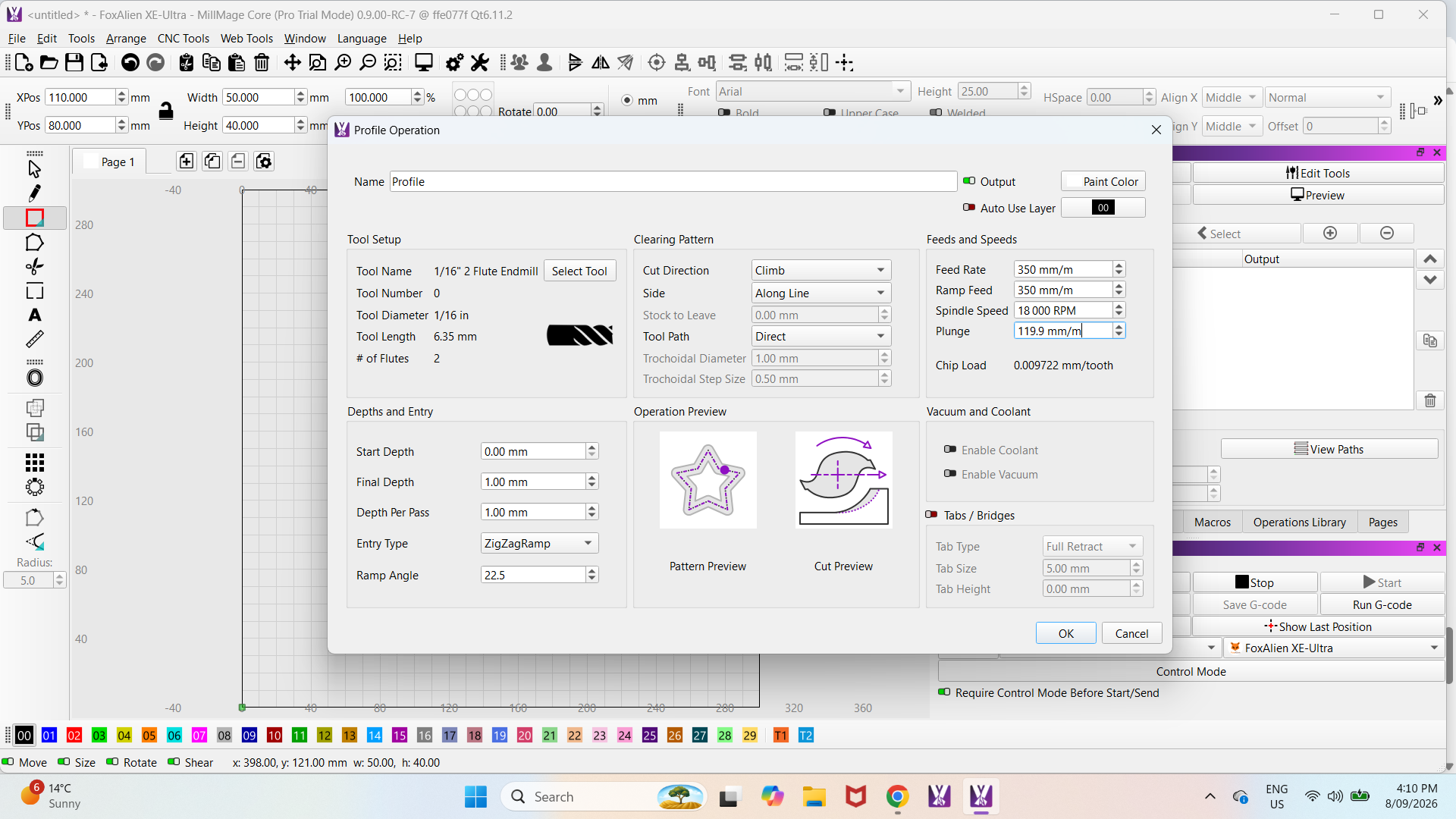

I am setting the spindle speed in Profile Operation.
I have a Foxalien VDF 1.5kw PWM controller.

Not sure you expect me to examine. Your image is much larger than your workpiece, and you have no operations defined.
I was expecting a MillMage file related to the images posted earlier.

Spindle speed set at 1800 but goes to 24000rpm
Pretty sure you meant 18000. How are you telling the difference between 18000 and 24000?
What is the value in your $31 parameter? It should be Zero. If this is not the issue, then…
Set your $30 on the controller to 5000, your tool RPM’s to 500, and report what effect that has.
