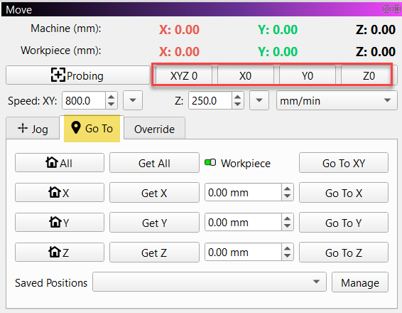

I’m having a lot of trouble positioning my spindle where I want to cut in my workspace.
There seems to be some discrepancy in the documentation. In the “Move Window Options and Settings” section it shows an image of the Move window as it appears in my installation. There are three tabs in this section: “Jog”, “Go To”, and “Override”.
Further down in the documentation there is a section labeled “Position Tab”. This image shows a version of the Move window with three tabs: “Jog”, “Position”, and “Override”. The “Position” tab highlighted in this image does not exist in my installation.
This tab contains “Zero Workpiece” buttons which may be helpful.
Am I missing something?
Genmitsu 3018 pro v2
MillMage Core 0.8.00
The wording on the tab was recently changed from “Position” to “Go To” as highlighted, but in some places the documentation still hasn’t been updated (we’ll get that fixed soon).
The “Zero Workpiece” buttons are still there - but the button labels were changed as outlined below:
