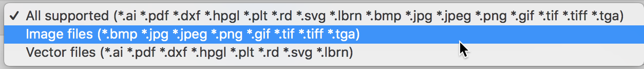

First, what filetype are you importing that is causing this issue? Vector or an Image file?
Post a few pictures of what file(s) you are starting with, what it looks like in LightBurn, how you have the Optimization Setting configured, and the Preview with the slider anywhere but far left or right so I can see a bit of how things are processing. We can go from there.
AI file
