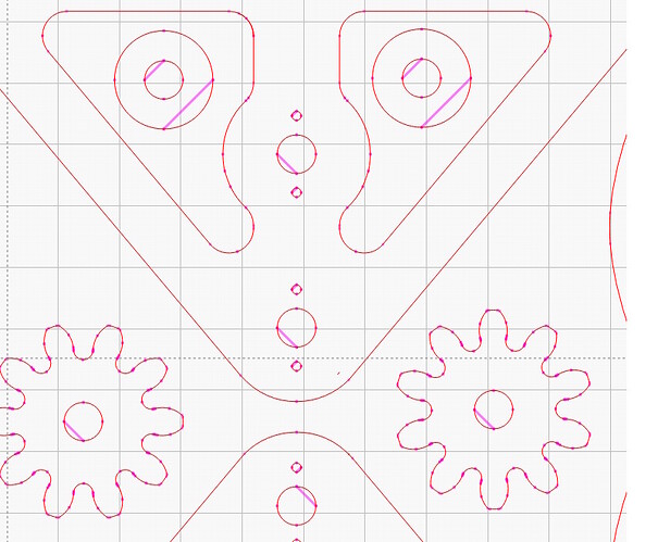

Why do my circles all have a bar across them?
All of my circles have a bar across them. The bar is a different color than the circle vector, but is on the same layer. The bar does not show up in the preview or affect the laser operation. Also, the vectors all seem to have nodes displayed, even though I am not in the node tool.
Windows 11, Lightburn 1.7.08 (Problem showed up with previous version)

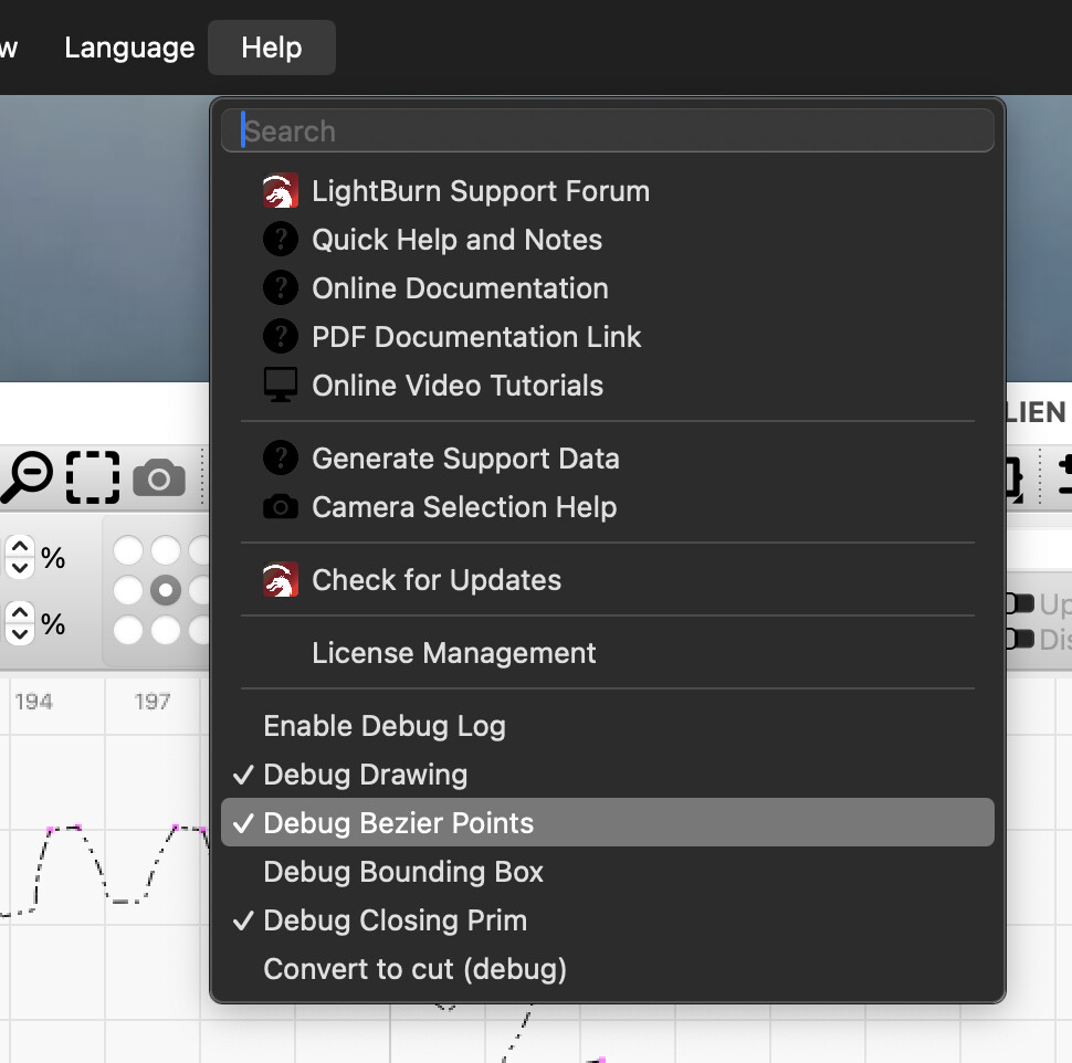

The pink lines are shown if you go to Help>Debug drawing with the objects selected, I suspect that’s how you got them to appear. In my example, I have disabled the bounding box:
I give up. What are those lines on my circles telling me?
I’m not sure, it’s not mentioned in the documentation: Enable Debug Log - LightBurn Documentation
@LightBurn what do the pink lines in debug drawing mode represent?
If you uncheck Debug Prim, the chords on the circles go away. Yeah, a Helpful Hints document would be handy…
This specific setting isn’t saved, and it’s intended as a debug only option for the developers. Re-running the app clears it, and it’s not something we expect anyone to turn on.
I can say with certainty that a “helpful hints” document would contain a TON of stuff before you got to the “if you have a pink line across your circles…” bit, so it honestly wouldn’t be a very useful addition. :slight_smile:
The pink line is showing the drawing primitive that “closes” the shape, if present.
