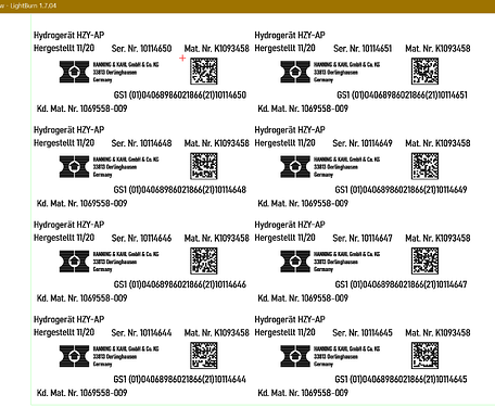

This is what it looked like in rl before i installed the new Version.
Your file works correctly with 1.7.04 and 1.7.06.

Ok… lots of weird stuff I found.
First of all, I just want to note that your CSV file has the GS1 barcode data in the wrong format… you need to surround the application identifiers with square brackets and then set your data mode on the barcode to GS1. Otherwise it won’t work
Secondly… as for the incorrect ä in your variable text it’s actually your CSV that’s wrong and it was being hidden by a bug in the older Qt version that we were using. Now on Qt 6, it’s loading the file “correctly”. I’ll admit, this is even weird to me and I’m still not entirely sure how it’s “working” on the older builds.
I can even show you by loading the file in VS Code (my code editor):
I cannot get a single application I have locally to load that CSV file and interpret that character as ä other than old builds of LightBurn.
The character you had in there was hex EF BF BD which is not ä in unicode or UTF-8: UTF-8 Tool
The correct character is hex C3 A4: UTF-8 Tool
What application did you use to create that file in the first place?
