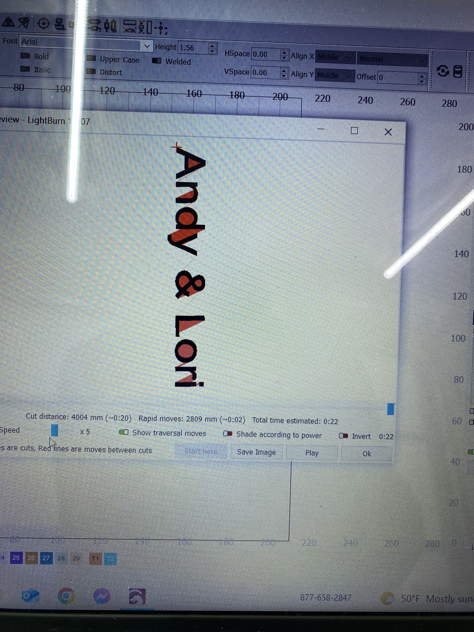

Why my text automatically splits in half
When I enter a text and frame it on my tumbler it shows it perfectly, but when I run the job it splits the text and engraves the bottom half of the text and rotates the tumbler the engraves the top half of the text.
What am I setting up wrong?
What does the preview look like? Are the words grouped together? Can you post the file?

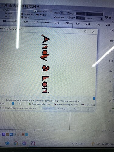

I just typed my name in the workspace and applied the material settings and framed it. The framing shows correct but when I run it on my galvo uv it runs the bottom half of the name and the “chuck” rotates the tumbler and engraves the top half of my name.
When you run the preview how does it look?
Can you post the file or screenshots of the settings?
Hard to tell because you haven’t posted any details except the problem. Settings, screen shots, file, etc

The preview looks perfect actually
You maybe have the axis wrong, judging from your text direction and description. Try y Axis.
Reduce the split size to 0.02 overlap 0.0
Thank you I will give that a try
Also, your interval (LI) seems really large. Should be 0.0XXX or 0.00XX But that wouldn’t cause your issue.
Another thing. Check the scan angle. The preview looks to be 45 deg
The issue ended up being my split was too large and I needed to be on the Y axis. Thank you everyone for your help!
