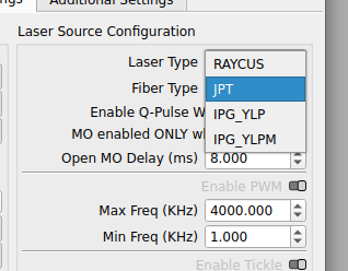

I am trying to engrave in color but my kHz can only go as high as 80. How can I get that to go higher so I can engrave on my MOPA fiber laser?
First, you’d have to verify what exactly your particular source is capable of. Then, in the F3 Settings on the Ports and Laser Settings Tab, you can set it there. Should have been set if you imported your markcfg7 file when you set your machine up:
Might want to update your profile so we know what kind of machine you have. Sometimes it’s just a simple controller change.
Which source do you have? Mines JPT.
I found it thanks
If you don’t mind, what exactly was the fix?
I had it set to JPT I just went in manually and increased the setting for kHz
