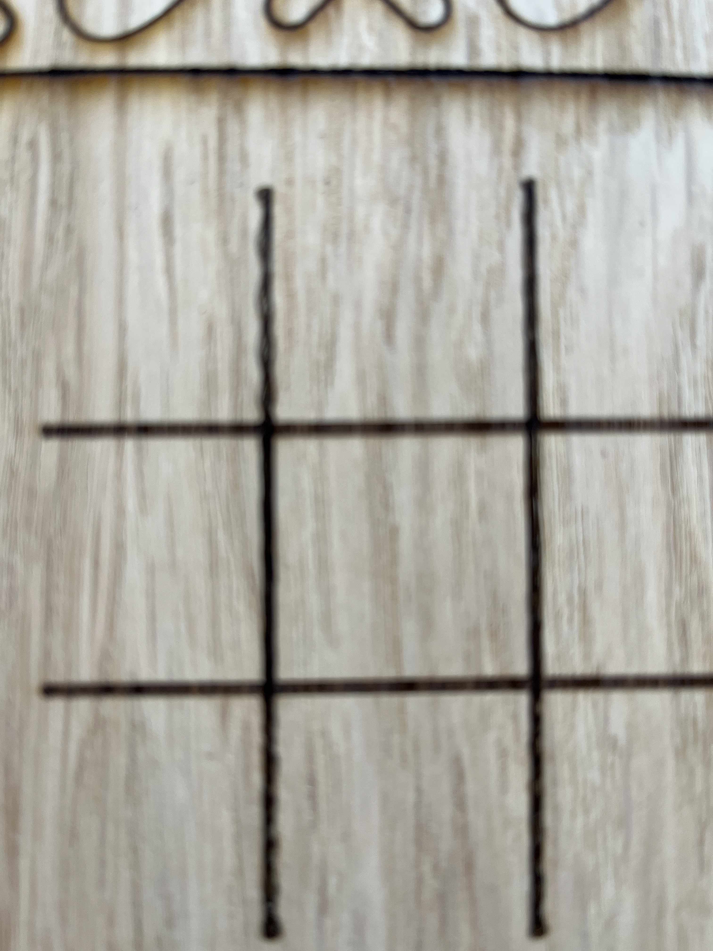

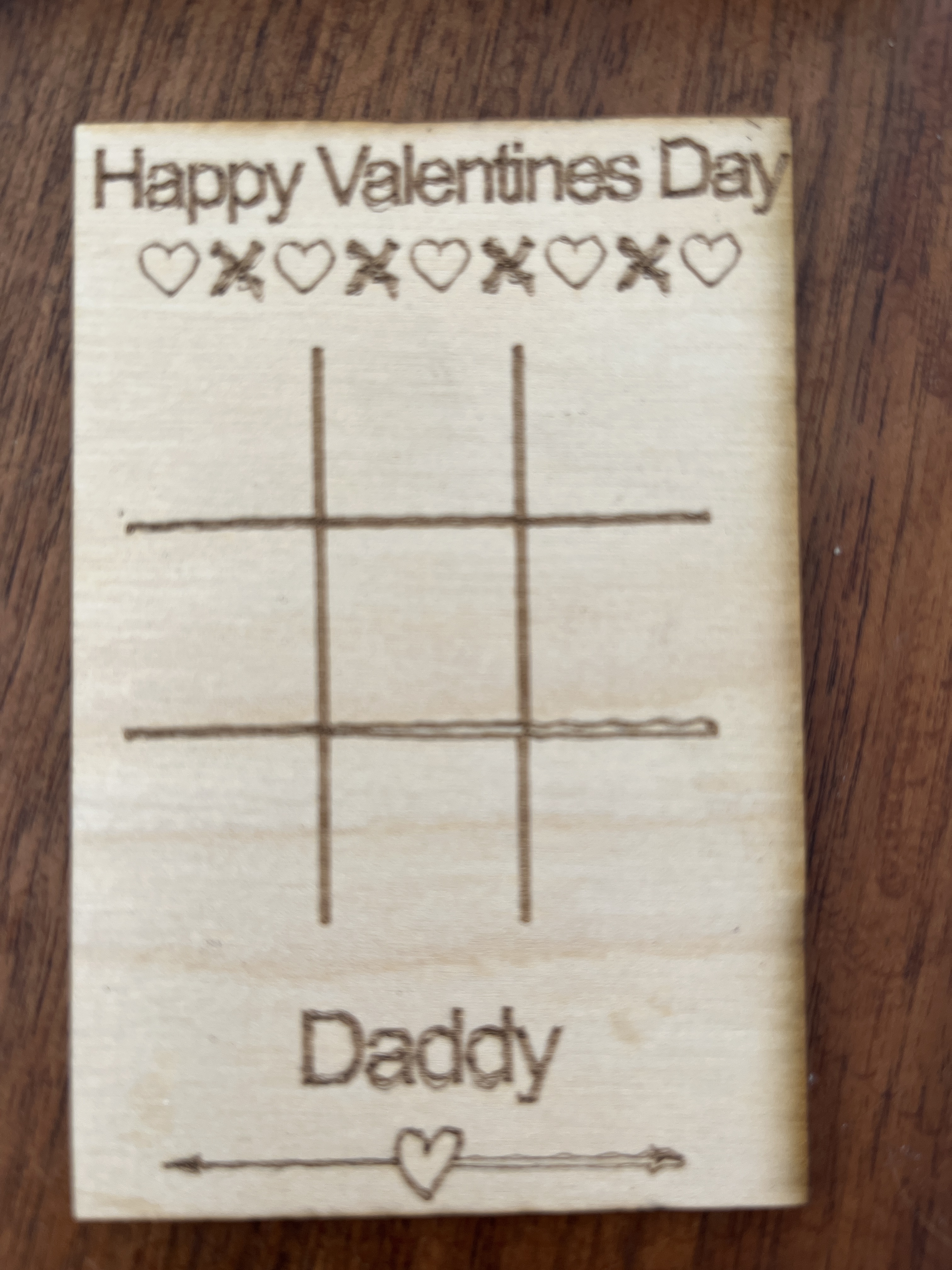

Wiggly lines from Sculpfun s9
I am getting so disheartened I just can’t seem to get rid of the wiggly lines I have adjusted everything but I am no expert as I have only had my Sculpfun s9 for a week I know it’s a basic model but surely I would get better results than this?
I think you still have a mechanical problem.

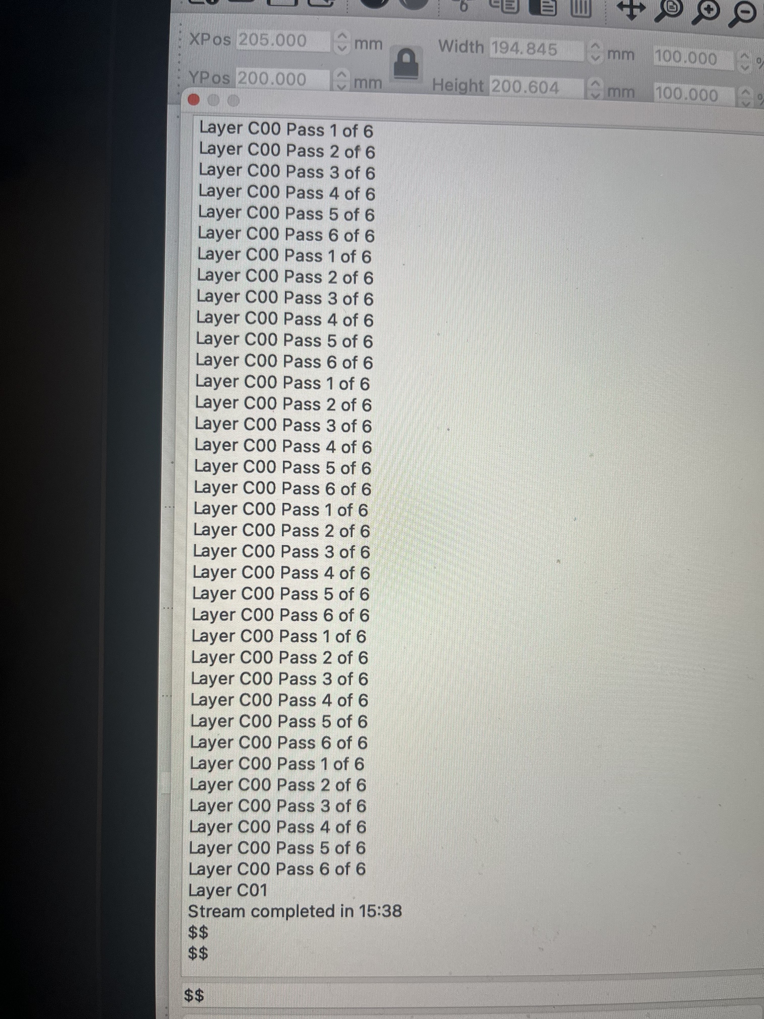

Can you type $$ into console and paste results?
I now seem to be incapable of pasting but here are some photos does this help?

Your numbers don’t look out of the ballpark.
I would recheck belts, drive pulleys, set screws, couplers and laser head for any looseness.
My first laser was also a Sculpfun S9. While not as obvious as your problem, I had similar. I had to retighten my belts. You might also have to adjust the eccentric nut as well. Since you have waves in x and y, my first guess is loose belts. After adjustment, with the power disconnected from the control board (too much/rapid movement can feed back into the control board and possibly cause a short), tilt the machine at a 45° angle. The gantry should move freely, but not too fast. Say a few seconds to go from top to bottom.

The wheels are more crucial than the belts usually. And the grub screws need to be checked as well.
For the S9, you can also try to reduce acceleration $120, $121 to 500 or 250 (is 1000 by default). And I recommend not running faster than 3000 mm/min.
Thankyou I think it was the eccentric nuts!
