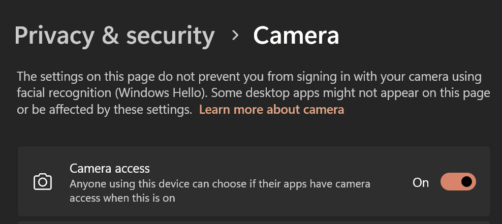

We have installed Lightburn 1.7.06 onto a windows 11 Laptop (i7).

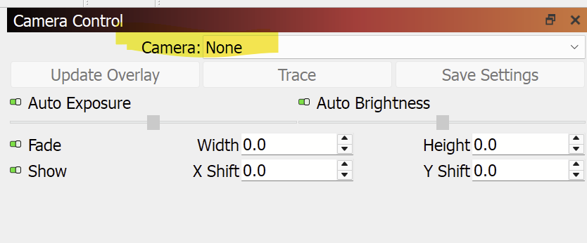

Software installed ok but the camera option is always greyed out.
I have tried the tips on here to activate default camera etc.
Also un enable and re-enable camera in device manager.
Checked app security is off and not blocking lightburn.
I have tested the cam and this works fine (also on "webcamtest.com)
Tried both laptop cam and external webcam.
Feel like ive tried everything and nothing works!?
Camera on lightburn continues to stay greyed out
Any suggestions?
Any thoughts?
I’m unfortunately going to have to find another software to run if Lightburn support cannot get this resolved.

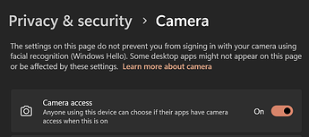

Hi Steve,
Do you have this setting enabled in Windows and does LightBurn show up in the list below?
Do you mean this part “None” is greyed out?
