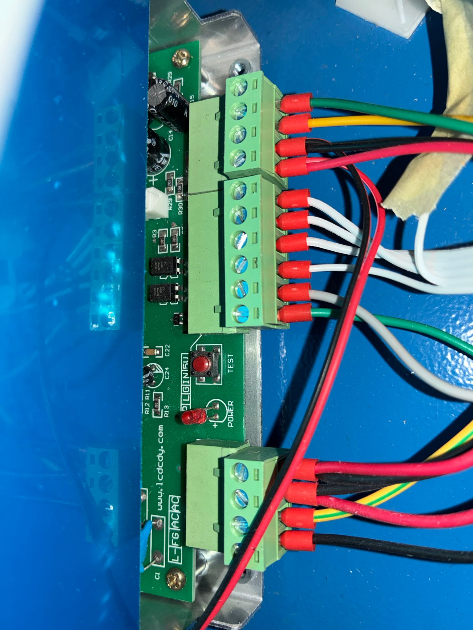

Hello, I bought a K40 with a monport board yesterday. It works well with manual laser power adjustment directly on the K40.

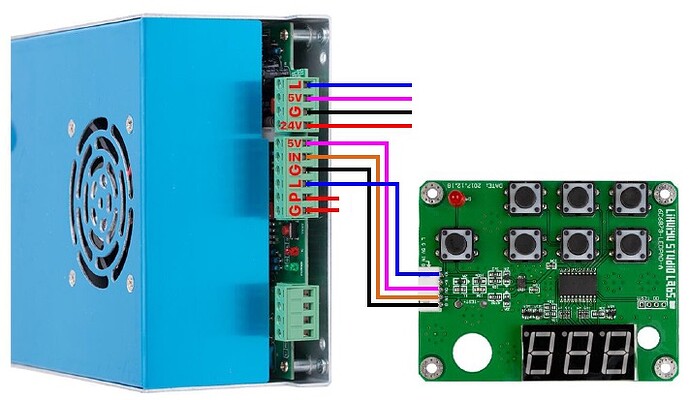

Now, of course, I would like to be able to adjust the power in Lightburn. However, my power supply looks different than the one in the monport description. Can you help me with how to wire it all up?
I’m attaching a picture of what my power supply looks like.
This isn’t the monport upgrade type board I’m used to seeing. I haven’t seen any of them that don’t remove the console controls.
This thread might help, but from the drawings, I don’t know what the little board is doing or how it interfaces to the Monport grbl board.
Let us know when you find out some specifics… Links to this stuff is usually very beneficial to those attempting to assist.
You lps should be able to be plug compatible. It’s just like the one in the link I posted.
