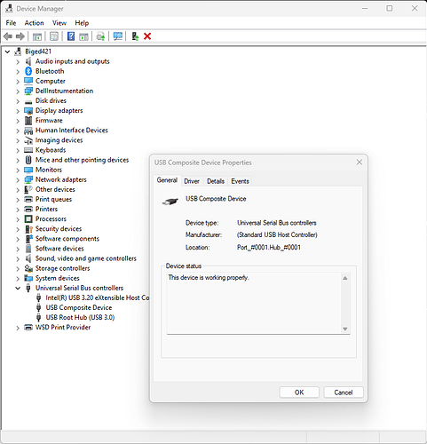

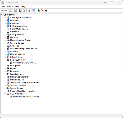

**Author:** ![Biged421](https://forum.lightburnsoftware.com/letter_avatar_proxy/v4/letter/b/7993a0/32.png) [@Biged421](https://forum.lightburnsoftware.com/u/Biged421)\
**Post date:** [December 5, 2025, 11:06pm UTC](https://forum.lightburnsoftware.com/t/wont-stay-connected-longer-ray5-20w/185634/13 "2025-12-05T23:06:20Z")
</div>
![image](https://forum.lightburnsoftware.com/uploads/default/original/3X/4/3/431ed491f7a3c511b2b891c57de20a676fb1152e.png)I found Device Manager but where is the Power Management? I right clicked on the USB and there is no Power Management there either

Expand the Universal Serial Bus Controllers line. Then select a USB line, right click, Properties, Power Management tab… or something like that. 😁

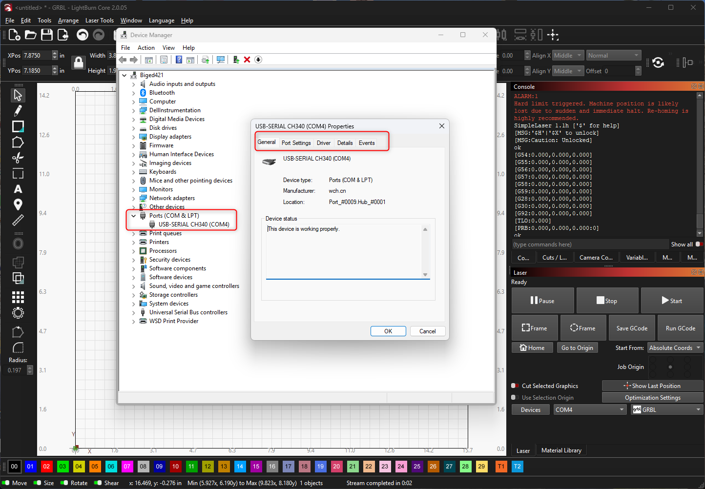

**Post date:** [December 6, 2025, 1:05pm UTC](https://forum.lightburnsoftware.com/t/wont-stay-connected-longer-ray5-20w/185634/15 "2025-12-06T13:05:28Z")
</div>
No Power management tab on any of them. I did search through the 4 tabs that there are at the top and none have anything to do with power in them.
 ![image](https://forum.lightburnsoftware.com/uploads/default/original/3X/9/7/9711ece140a6a376efec3e8b164d8798792c1b3d.png)

That is because the laser is not connected. Plug in the laser with that window open and a new one shouls appear. I had several, but you might only have one to set.
There will be another tab saying Power Management.

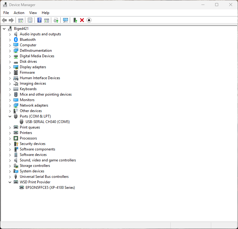

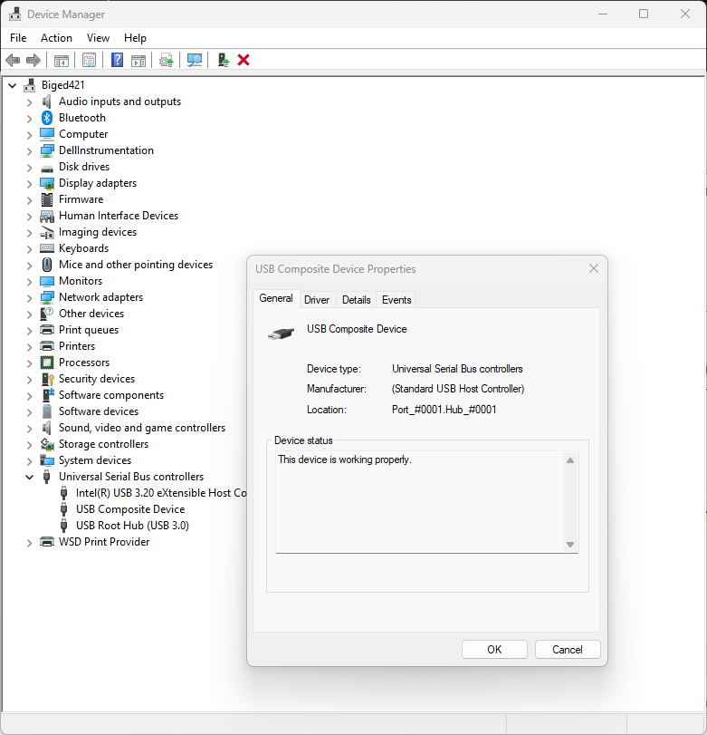

There is none, Laser is on the USB port comes up, I right click it and there is no Power Tab, I looked in the 5 tabs that are there and there is none for Power Management, Any ideas why mine doesnt have it?
 ![image](https://forum.lightburnsoftware.com/uploads/default/original/3X/f/b/fb5bdee511fedeb80ef58cc1c7b88c0599340069.png)

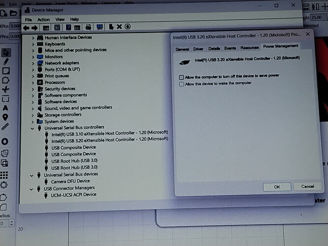

I just bought a new Win11 laptop. I will hook it to a laser and see if I get the same thing. My other laptop just upgraded to Win11 was Win10 Pro, which is now Win11 Pro. The new one is Win11 Home, and that might be the difference. I do remember finding a USB energy saver switch on the new one in a strange place. Be patient, we will figure this out.

My was Win10 now Win11 won’t open any Lightburn sites. **I HATE WIN11!!!**
Ok, here is what I got on the new laptop, reported with tablet.
1. eXtensible and Root Hub entries all show 6 tabs, as shown.
2. Composite does not have the Power Management tab.
3. When I plug/unplug the cable, the USB controllers list does not change.
4. I could not find any line that told me the laser was on COM3.
5. There was no mention of the CH340 driver, but I did not have to install it. Built a new Device for the S30 laser and it connected.
6. Did I mention I hate Win11?
 ![20251206_174933](https://forum.lightburnsoftware.com/uploads/default/original/3X/e/e/eecb14ee516f5539d2bb6465c81980f1e2e1b44e.jpeg)
