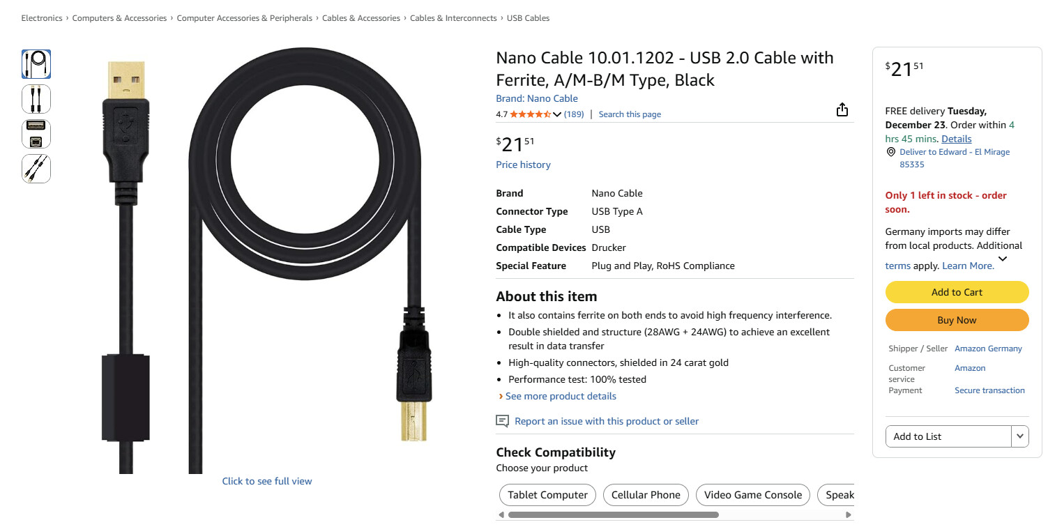

Like this one??
 ![image](https://forum.lightburnsoftware.com/uploads/default/original/3X/6/4/641ae9554baa456fc3206c1a74b388c586ac63de.jpeg)
<div class="post-metadata">
**Post date:** [December 7, 2025, 2:51am UTC](https://forum.lightburnsoftware.com/t/wont-stay-connected-longer-ray5-20w/185634/26 "2025-12-07T02:51:24Z")
</div>
Yes, but make sure it has the right connectors on both ends for your setup.
**Post date:** [December 7, 2025, 12:35pm UTC](https://forum.lightburnsoftware.com/t/wont-stay-connected-longer-ray5-20w/185634/27 "2025-12-07T12:35:06Z")
</div>
> [@Biged421](#):
> Like this one??
I am always suspicious of Amazon listings with contradictory or irrelevant bullet points:
- “Ferrites on both ends” but the picture shows only one core
- “Shielded in 24 karat gold” is total nonsense
- No mention of the length

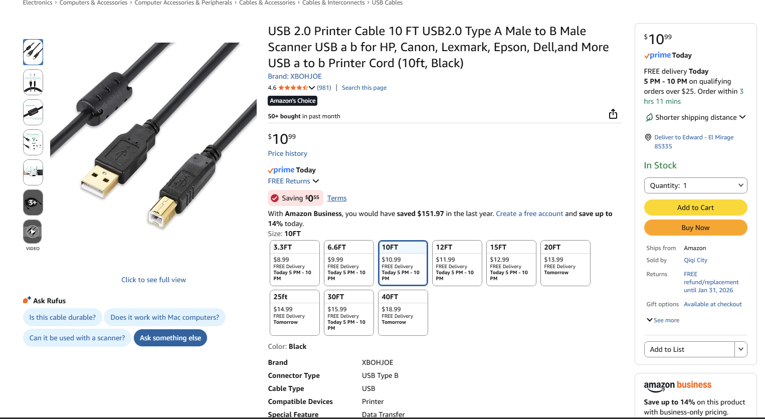

I didn’t get that one says it wouldn’t be here for 16 day so I ordered this one, I am having a hard time believing that it can be the cable when the cable works on my laptop to my laser just fine but I don’t know enough about it. I just have a feeling that I am going to buy a expensive cable and I am still going to be in the same boat.
 ![image](https://forum.lightburnsoftware.com/uploads/default/original/3X/6/2/62635d3f5dadad24a24631d95056459a4a3f0ac9.jpeg)
**Post date:** [December 7, 2025, 1:38pm UTC](https://forum.lightburnsoftware.com/t/wont-stay-connected-longer-ray5-20w/185634/31 "2025-12-07T13:38:13Z")
</div>
I hope the length is not an issue. The USB standard says 15 feet maximum length, but I usually recommend 10 feet. That said, there are users that have reported using 20’ cables so we are crossing our fingers. 😁

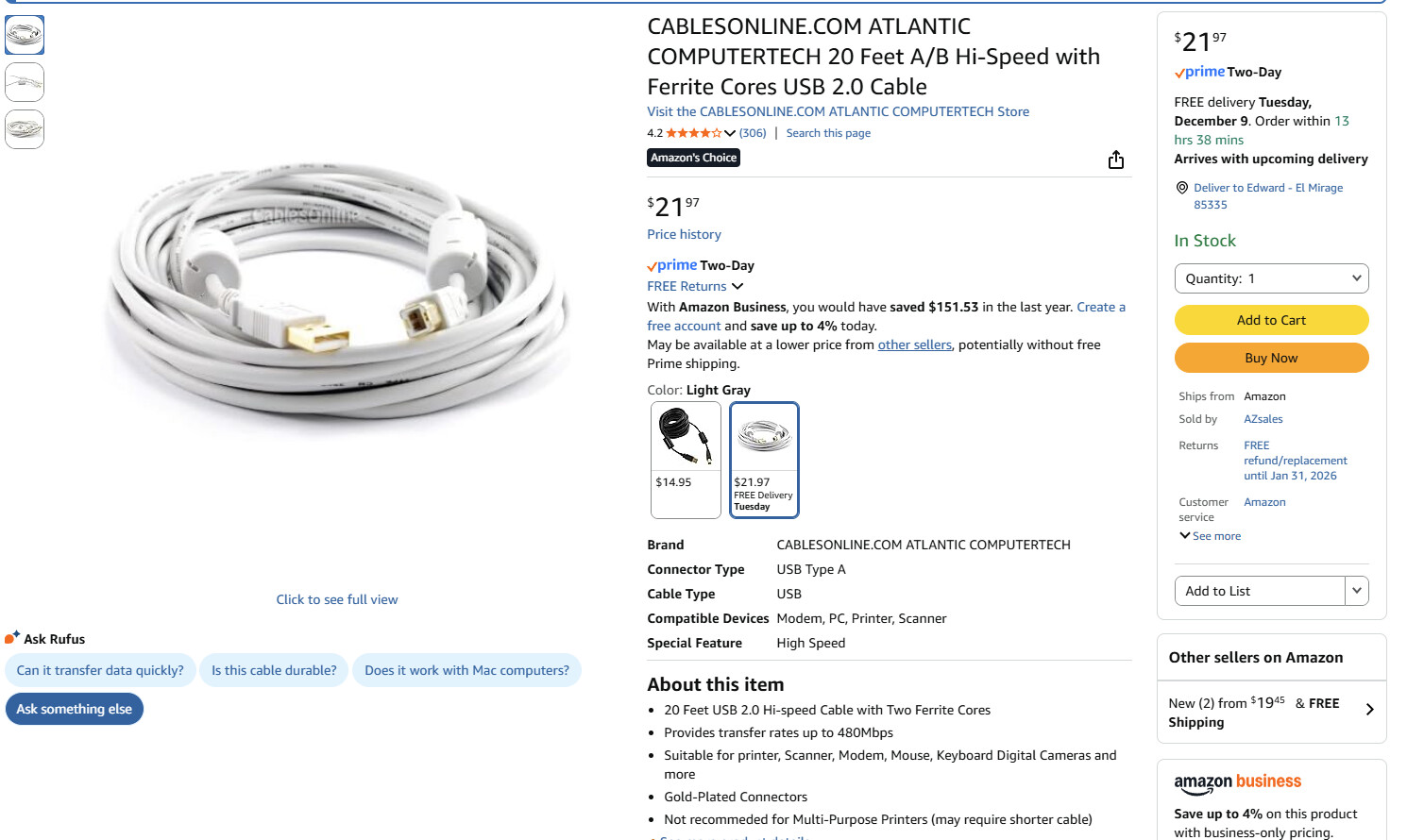

How about this one? Its cheap though.
 ![image](https://forum.lightburnsoftware.com/uploads/default/original/3X/b/8/b8411c749e344d04ef02911e6dc749d7073e2c09.png)
**Post date:** [December 7, 2025, 3:23pm UTC](https://forum.lightburnsoftware.com/t/wont-stay-connected-longer-ray5-20w/185634/34 "2025-12-07T15:23:52Z")
</div>
> [@Biged421](#):
> How about this one?
IMO, any cable over about a meter long requires special care, because _everything else_ is not under your control.
Ferrite-core cables _usually_ work up to 2 m, if only because OEM cables are typically junk and anything will be better, but that does not meet your length requirement.
The CableCreations active cable I’ve used will _probably_ improve the results, although it does not have power injection at the laser end:

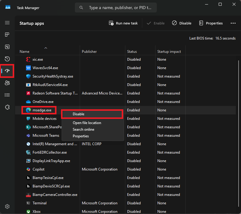

Did you try disabling MS Edge for auto-boot? Select these options, then reboot:
 ![0c23e0b5-f528-4af1-af05-843a34c51b32](https://forum.lightburnsoftware.com/uploads/default/original/3X/0/5/05bf90d283425215e47b27e034ff31b6ced24d73.png)
It seems unlikely, but this seems to have solved some issues for users with USB problems. Maybe worth a try.
**Author:** ![Biged421](https://forum.lightburnsoftware.com/letter_avatar_proxy/v4/letter/b/7993a0/32.png) [@Biged421](https://forum.lightburnsoftware.com/u/Biged421)\
**Post date:** [December 10, 2025, 3:24pm UTC](https://forum.lightburnsoftware.com/t/wont-stay-connected-longer-ray5-20w/185634/38 "2025-12-10T15:24:18Z")
</div>
Thank you for the try but this has already been disabled.
