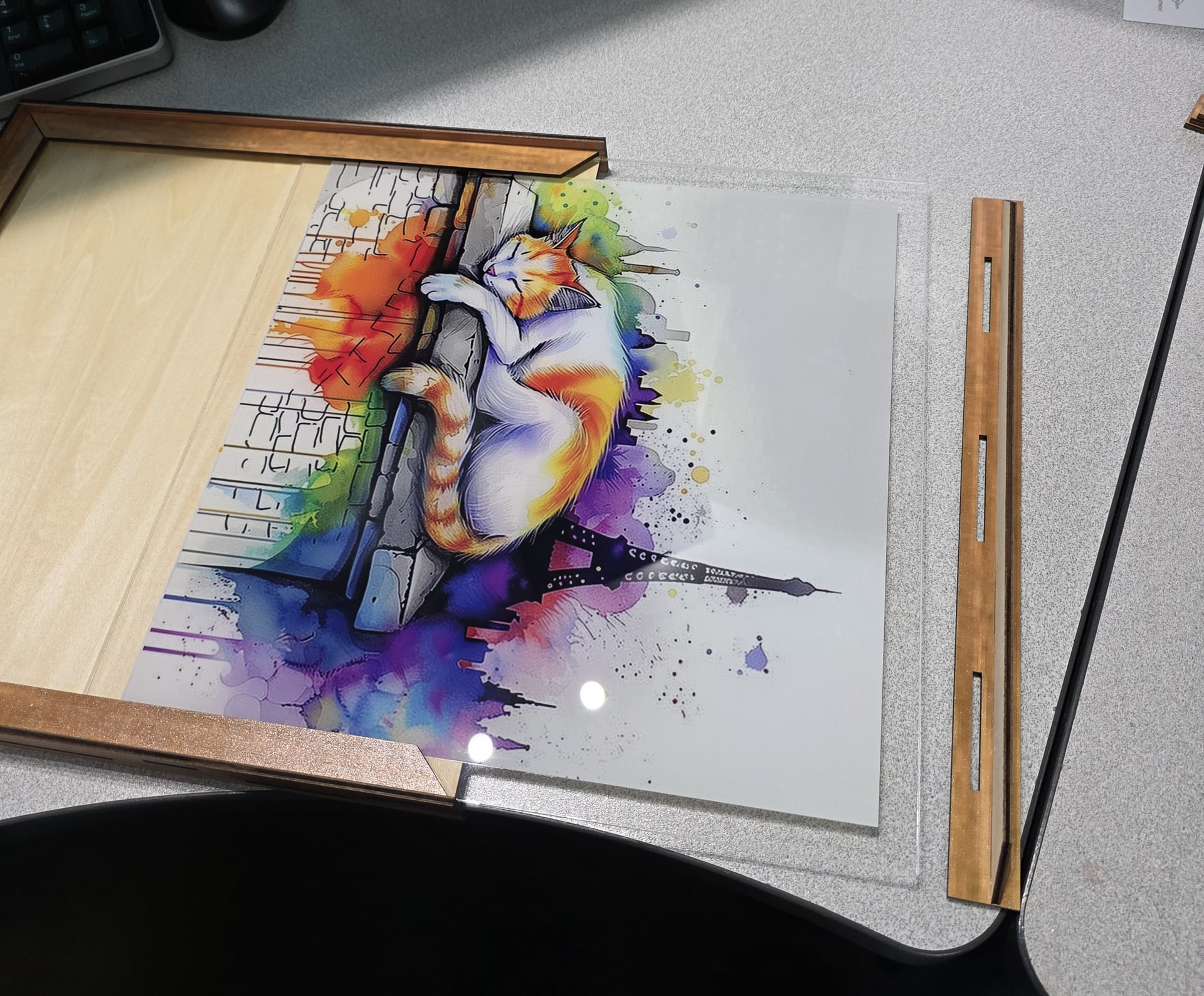

Really sharp. How’s the adhesion? Or do you not really have to worry about it since it will be enclosed?
You’re making me think more and more about getting one of these printers. :grin:
Ok a look into my day, it starts at 3am :slight_smile: (I am an early bird…)
I use THIN Super glue for the frame parts, except the top which ‘can’ be glued if desired,
but I keep it free so I can make bulk frames and then build as needed…
and the top frame part just pushes on and stays in place after hanging..
The design I did on the frame is 4mm spacing for the 3mm acrylic to just slide in and out
nicely..
Then there is my classic hanger :slight_smile: on the back. I use MEDIUM superglue on this…

Nice! Sorry, I wasn’t clear. I was wondering if you had any issues with the UV paint/ink adhering to the clear acrylic. Do you have to pre-treat the surface or just peel off the protective film and print?
YES :slight_smile: I only get the Acrylic with the plastic cover, never the paper… my preference…
but I only peal it when it is ready to go on the UV printer plate. moisture, dirt reduction of course.
UV ink is acrylic based so acrylic to acrylic stick GOOOOOOOOOOOOOOOOD !

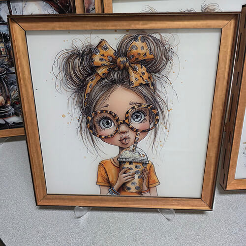

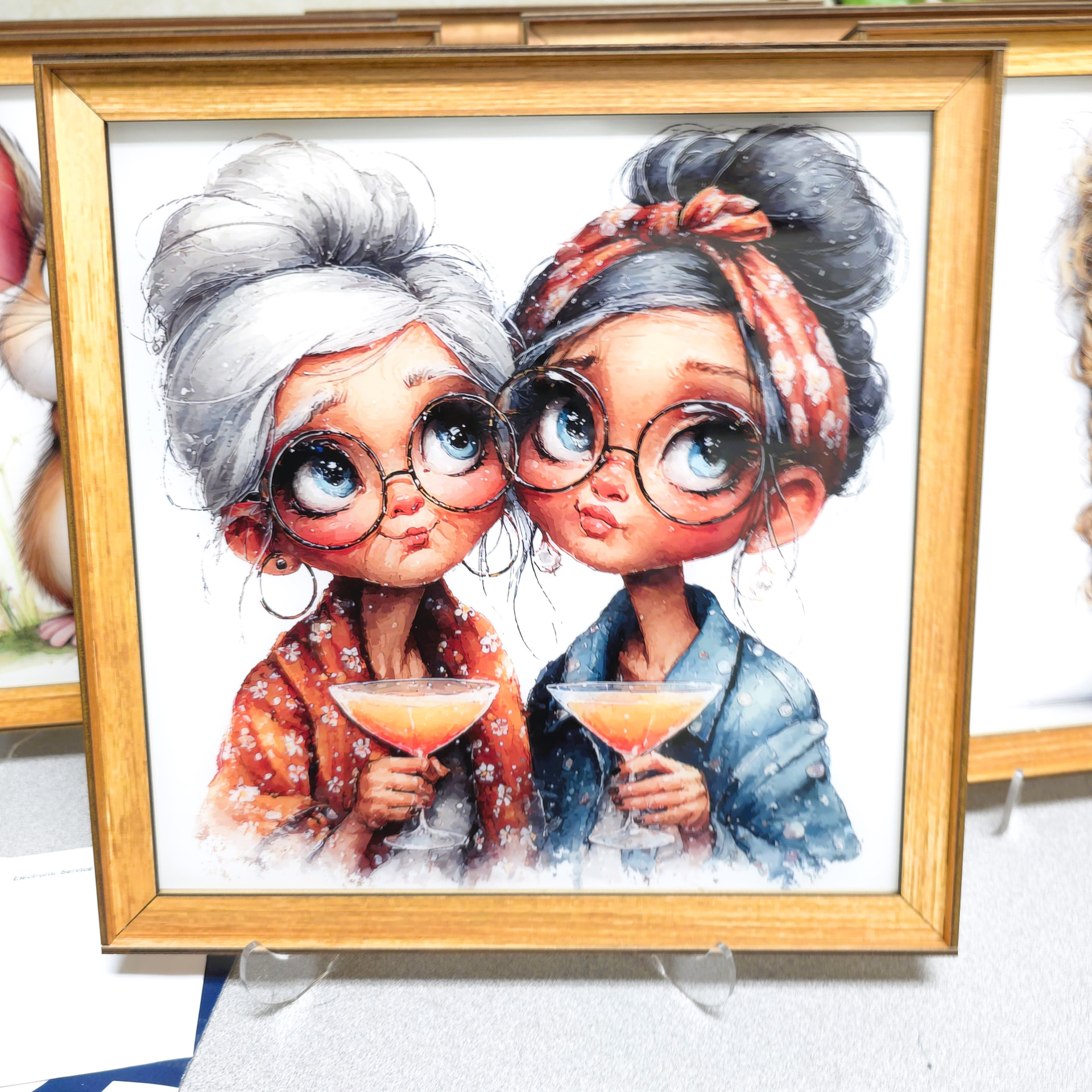

Hung some pics in our Hair cutters suite… just 1/2 of them :slight_smile:
I trust it’s not intended as their “We can make you look like this!” display … :grin:
Hall of (hair) fame :+1:
My wife likes frogs
Collie
12 x 12 8 layers
Mouse
Pigtail Girl w/bunny
Drinks for Girls

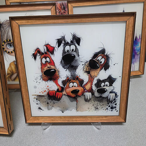

Happy Hounds 12 x 12 UV Printed
Amazing detail and quite flawless.
I’m wondering if the Happy Hounds is actually a representation of an oil painting.
