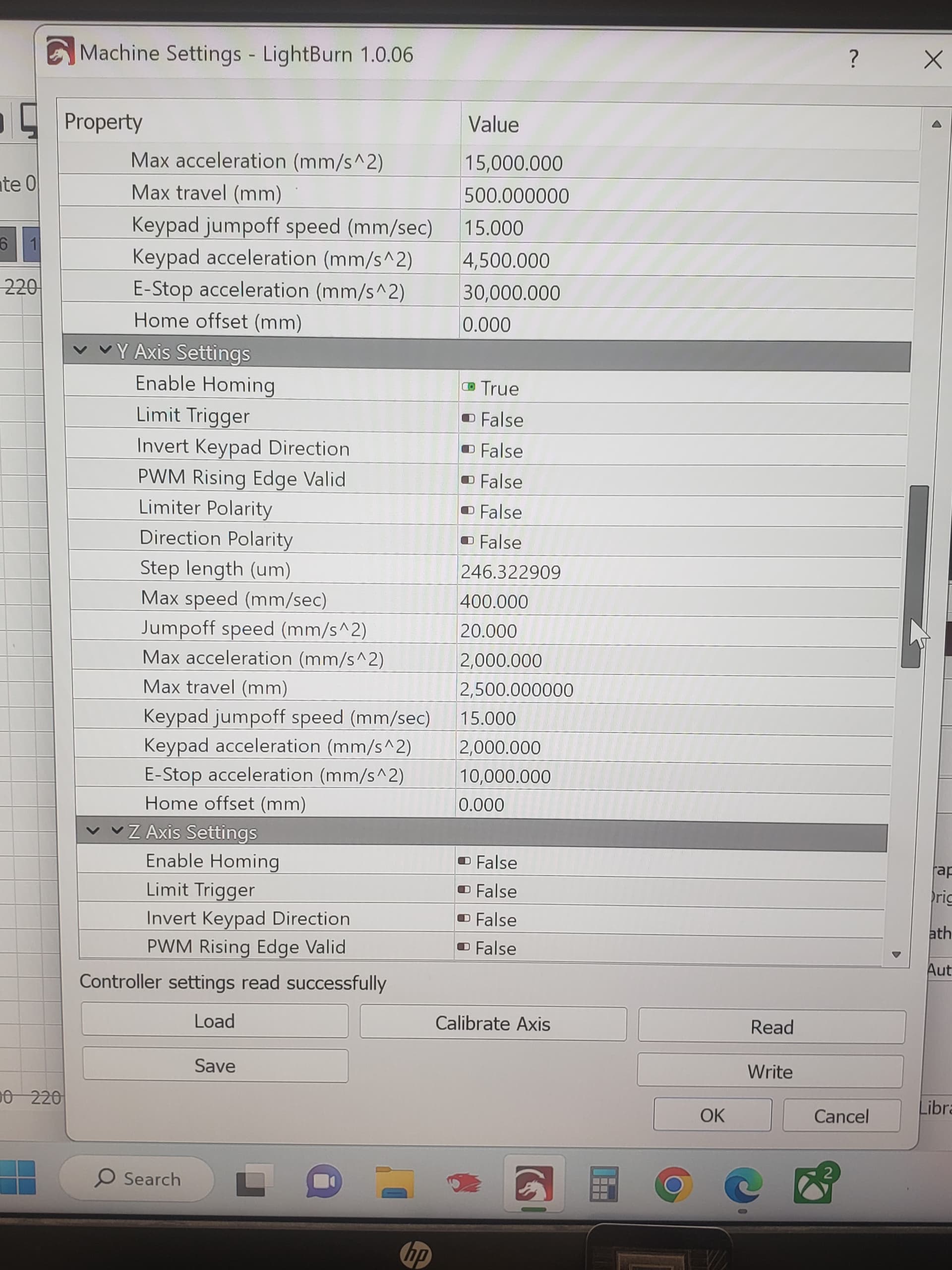

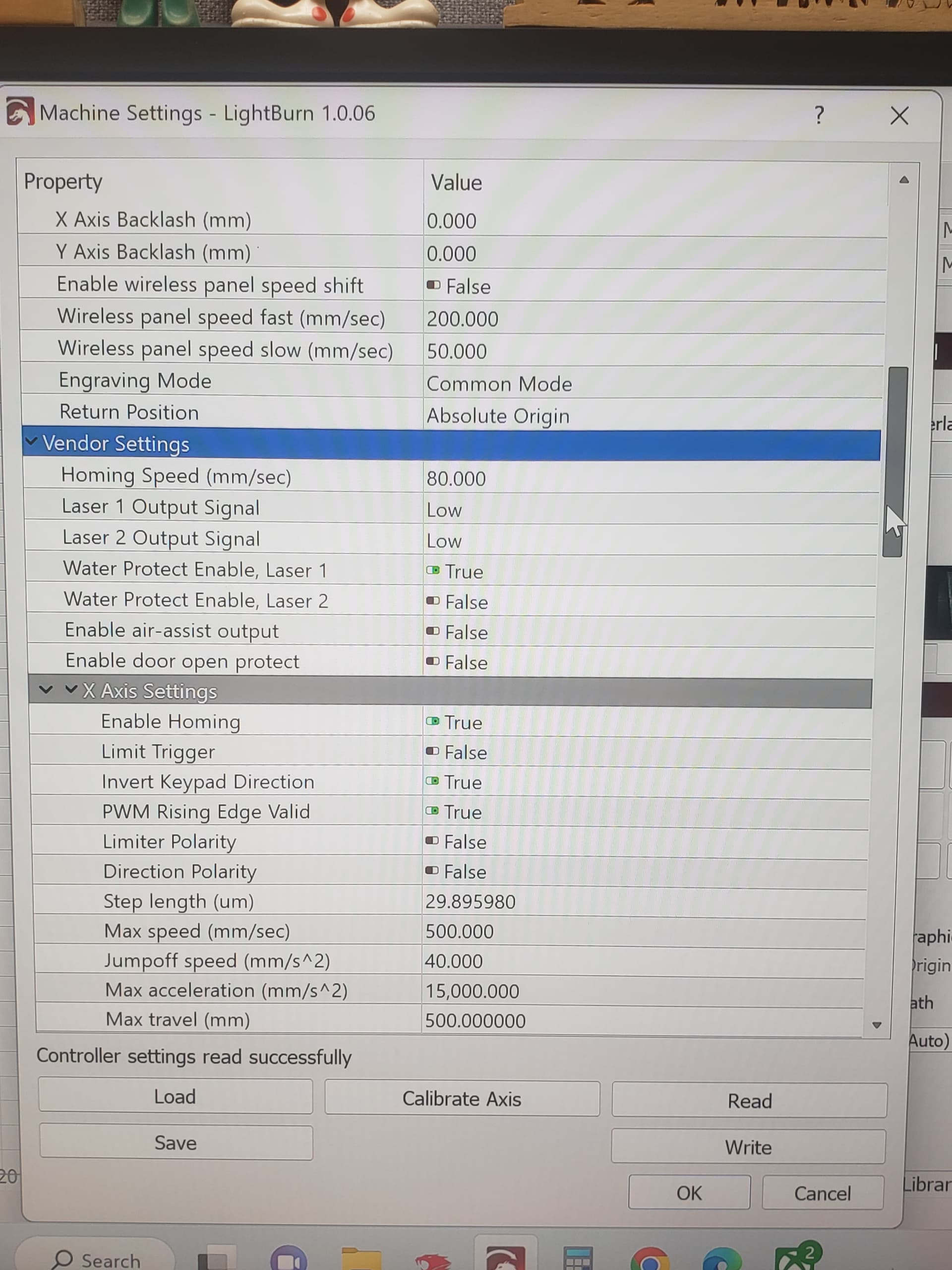

I have a gray and blue 50 wat laser with a ruida controler.
i have a 500 by 300 bed size.
i tried to adjust the step size on the y axes in machine settings and now everything is messed up . i saved the setting before the change , and reloaded it but it is still messed up .
i dont know how to get it back to normal. i have included my settings. if anyone can tell me what is wrong and what to do it would be greatly appreciated .
I don’t know anything at all about your controller and I’m not exactly sure what you mean but l would look at your Y Maximum Travel (mm) that’s set to 2500. If your X is correct at 500 then Y should be 300 I would think.
Thanks a lot. I did not catch that. I took a few times to wright it back but my machine is back to normal.

Sory i took it the wrong way. i was very frustrated because i did hit the save button before making a change. i dont know why it did not work.
All i did was hit calibrate axis tab and put in the numbers fore the y axis. then everything went wrong.
