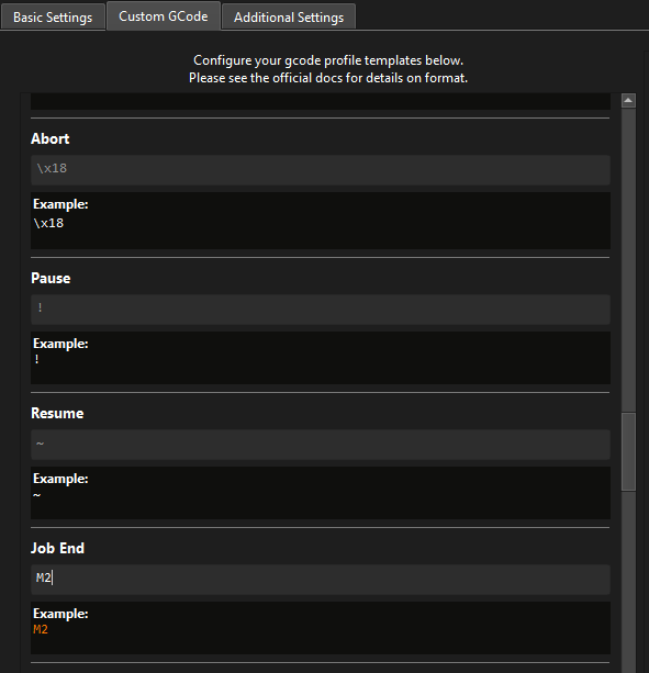

You can go into the Device Settings, custom gcode tab and find the Job End gcode:
By default it only sends M2. You can add the G0 X0 Y0 before or after the M2 as you prefer.
This will alleviate the need for a macro.

I just did a serious search for Finish Position like Lightburn has. Best I can tell, the finish position is where the cutter is last located when it finishes the cut. You can set Go-To positions in the Move window, but I could not find anything that was automatic. There may have been a good reason for leaving that out.
I get the impression you will be using the same finish position for all cuts. In that case, you can add commands to the Custom GCode tab, User End Script. Edit this for your own settings…
1, G0 Z0 M5
2. X250 Y250
The M5 may be optional; you might examine the GCode output to see if it is needed. Let us know if this helps.
