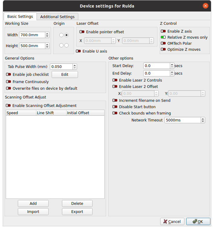

Thanks again everyone. First my device settings:
 ![Screenshot from 2026-01-12 13-30-05](https://forum.lightburnsoftware.com/uploads/default/original/3X/a/8/a8f374ea18398ad4683b3881f6ec78cb1717f7fb.png)
And machine settings:
[2026-01-12-ruida.lbset](https://forum.lightburnsoftware.com/uploads/short-url/8XNLjfX0kBpPy18STN7vHt0LdHs.lbset) (12.6 KB)

> First off, check to see if the Ruida is using the same active edge as the stepper drive.
Apologies I’m not sure what I’m looking for here. In the device settings I see `PWM rising edge valid=TRUE` for the X-axis but FALSE for Y, Z, and U axes. I assume these are the Ruida settings; could you clarify where the stepper drive settings would be located?
In a referenced post Ed suggests rising edge valid should be the same for all, so I’ll try that first.

> [@aolney](#):
_Bingo!_
Unless the stepper drivers have truly bizarre wiring not seen in bone-stock OMTech machines, the X axis is incorrect. Flip that switch to `False`, run the same pattern at the same speed on cardboard, and it should work fine.

Setting `PWM rising edge valid=FALSE` for the X axis to match all other axes solved the problem!
