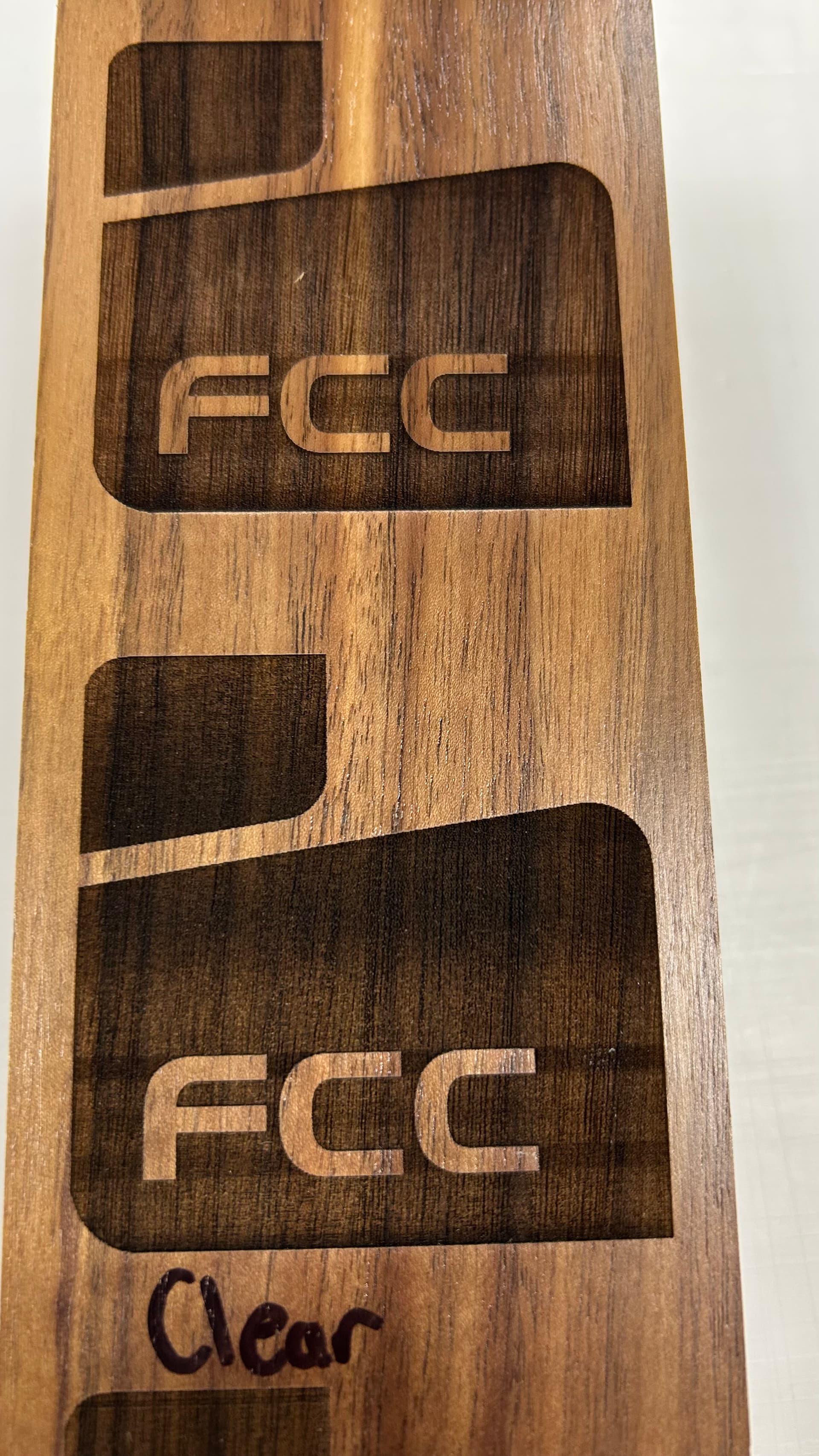

X axis shadowy looking bars
What would cause these dark shadowy bars where it says FCC? Any help would be appreciated.

What does the job look like in Preview.
Do you see anything other than the font/letters.
Could you post a copy of your .lbrn2 file so we can take a look? This is on the Trocen-controlled boss laser you have in your profile?
