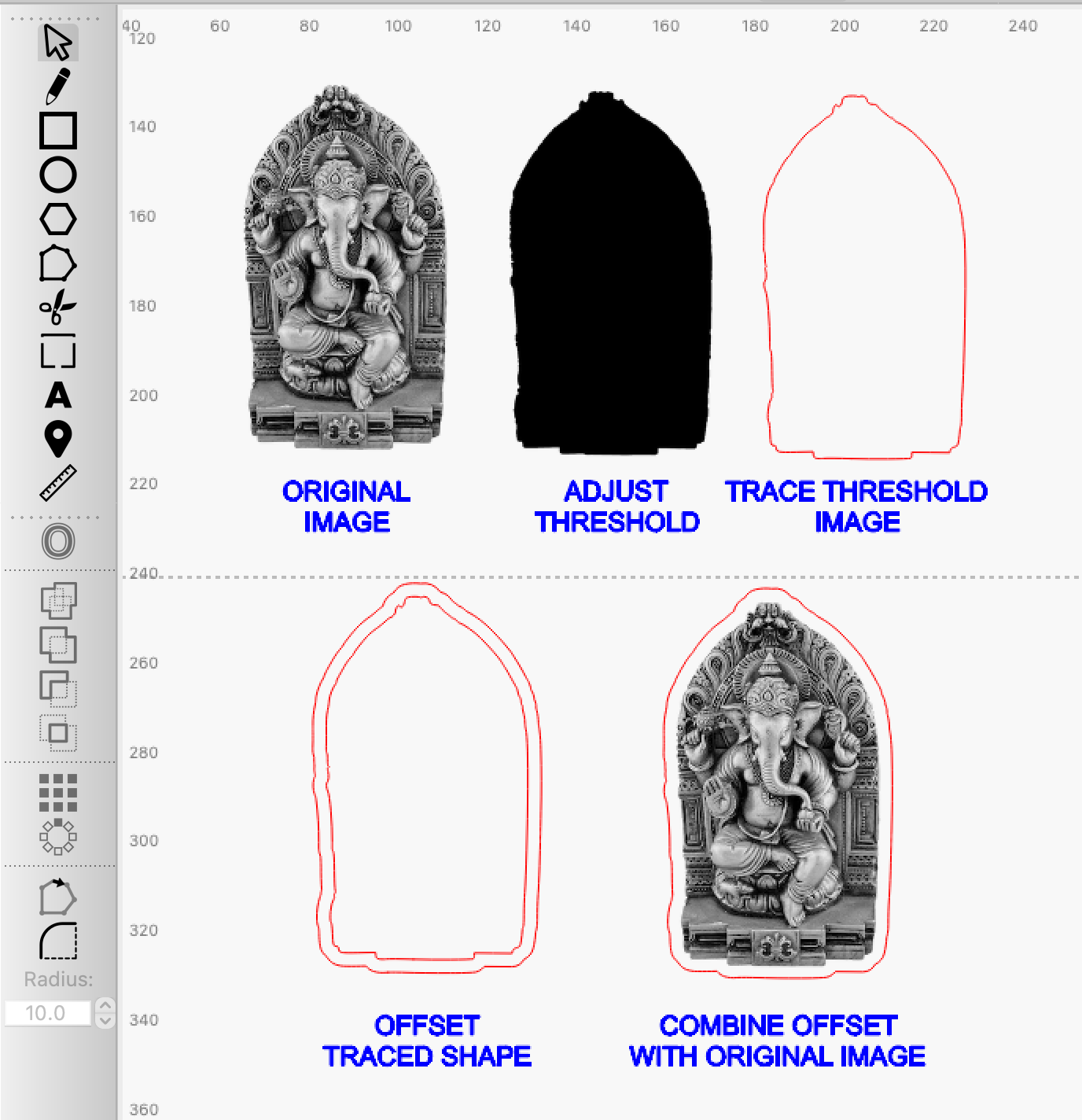

  2. Offset it’s only working with vectors? I have an image uploaded that I wanted to make an offset from it to cut, but it doesn’t work, and it’s not just a simple circle or square.

  2. No idea what you mean. How would you offset an image?

Here’s how to create a vector from an image:
You can use the offset shapes tool if you don’t what the vector outline snug around your image:

This is how I offset an outline around an image. In this example, the image does not have a background. First, I duplicate the image and then adjust the Threshold to create a solid black image. Next, I use Lightburn’s Trace Image function to outline the Threshold image. I can then apply whatever offset I need to the outline. Finally, I combine the original image and my new offset outline.
