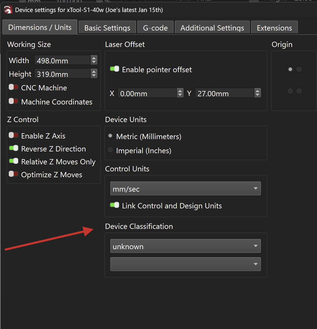

I see that “XTool Network Protocol Support” has been added in LightBurn-v2.2.00-RC-2, how do I connect to my XTool -S1,
I Get an error “xTool: cannot determine protocol generation at IP192.168.------ (no V1 service on :8080, nothing listening on :28900); retrying in 1s (attempt 1)”
xTool Studio is conncting on port Src Port: 20000, Dst Port: 20000
The S1 and D1 only work over serial for now. I added that detail to the RC-2 release post.

Adding my voice here — xTool F2 Ultra owner (60W MOPA). Would love to see the F2 Ultra added to the network-protocol device list. It speaks the same V2 protocol family as the F1, so hoping it’s a straightforward add. Happy to beta test if you need F2 Ultra testers. Thanks!
Thanks for chiming in, and welcome to the forum, @Td3d
I’ve only heard the devs talk about the F1 so far, but I see the F2 is on the list in the Device Settings, under “Device Classification”.
That’s just the list of detectable machines. It should reset on each new connection.
If you connect to a machine and that changes to the right model, that is an excellent first step.
@Td3d
Got feedback from the devs:
It definitely won’t work right now because I haven’t filled out the metadata table for the F2. If the F2 Ultra and F1 speak the same V2 protocol family as the F1, that would would be really lovely!
We can turn it on and treat the F2 like the F1, might as well, we’ll see what happens I suppose.
