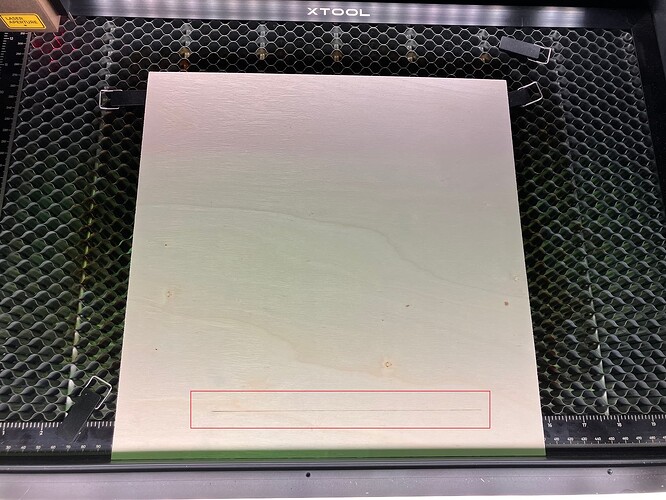

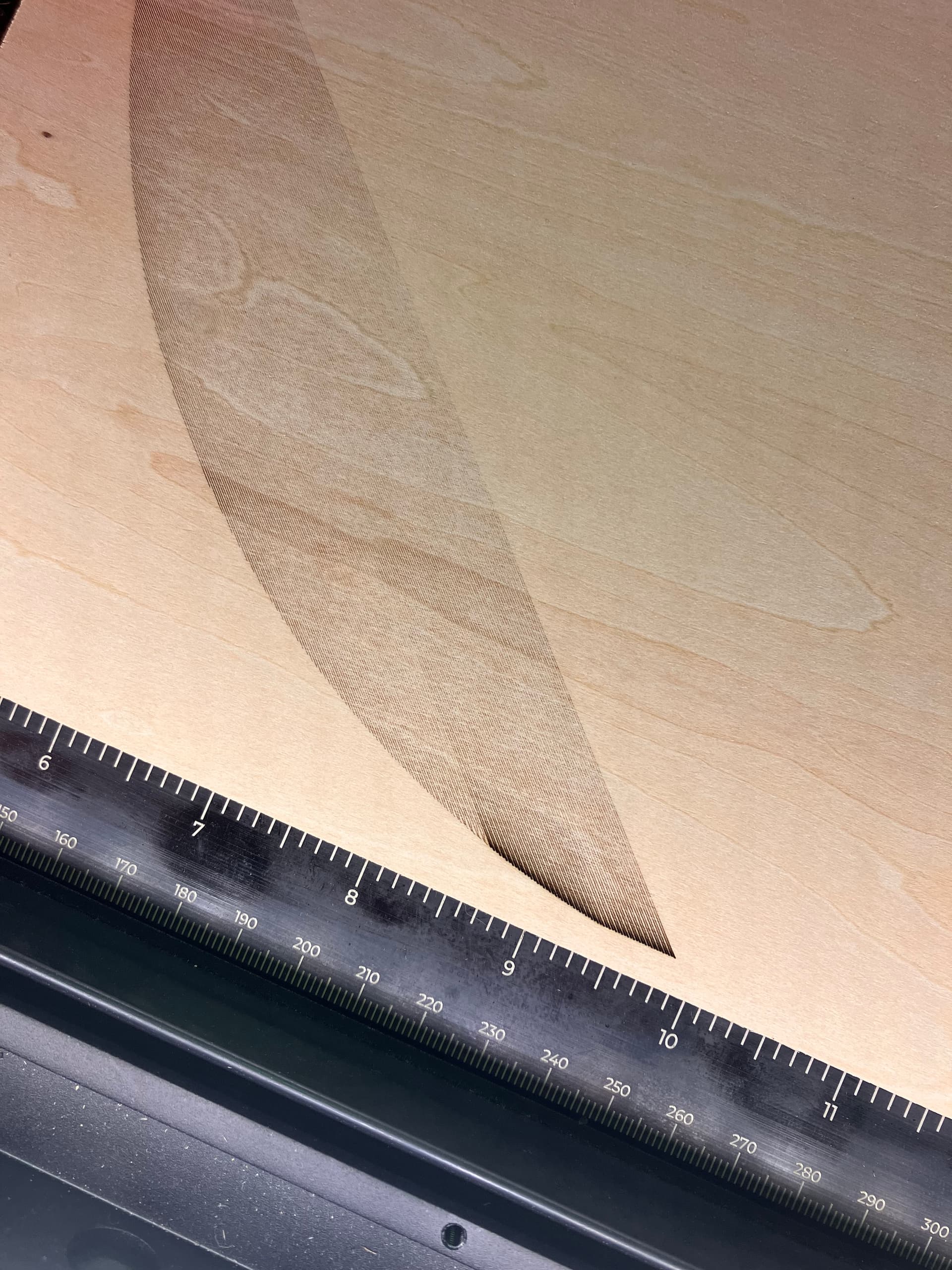

I doon’t know if someone had the same issue like me, I have the Xtool S1, and I can’t engrave or cut a circle with 300mm of diameter. On the buttom working area, the laser don’t cut curved, but a line (see photos)

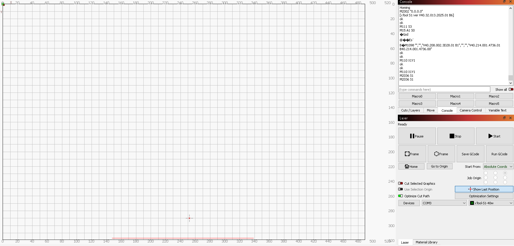

Are you using the Lightburn device type or the one from xTools?
You need to use the LB one.
I’m using the LB provided setting file.

I tried to engrave a line at Y(317mm) position, but the laser, engraved it before.

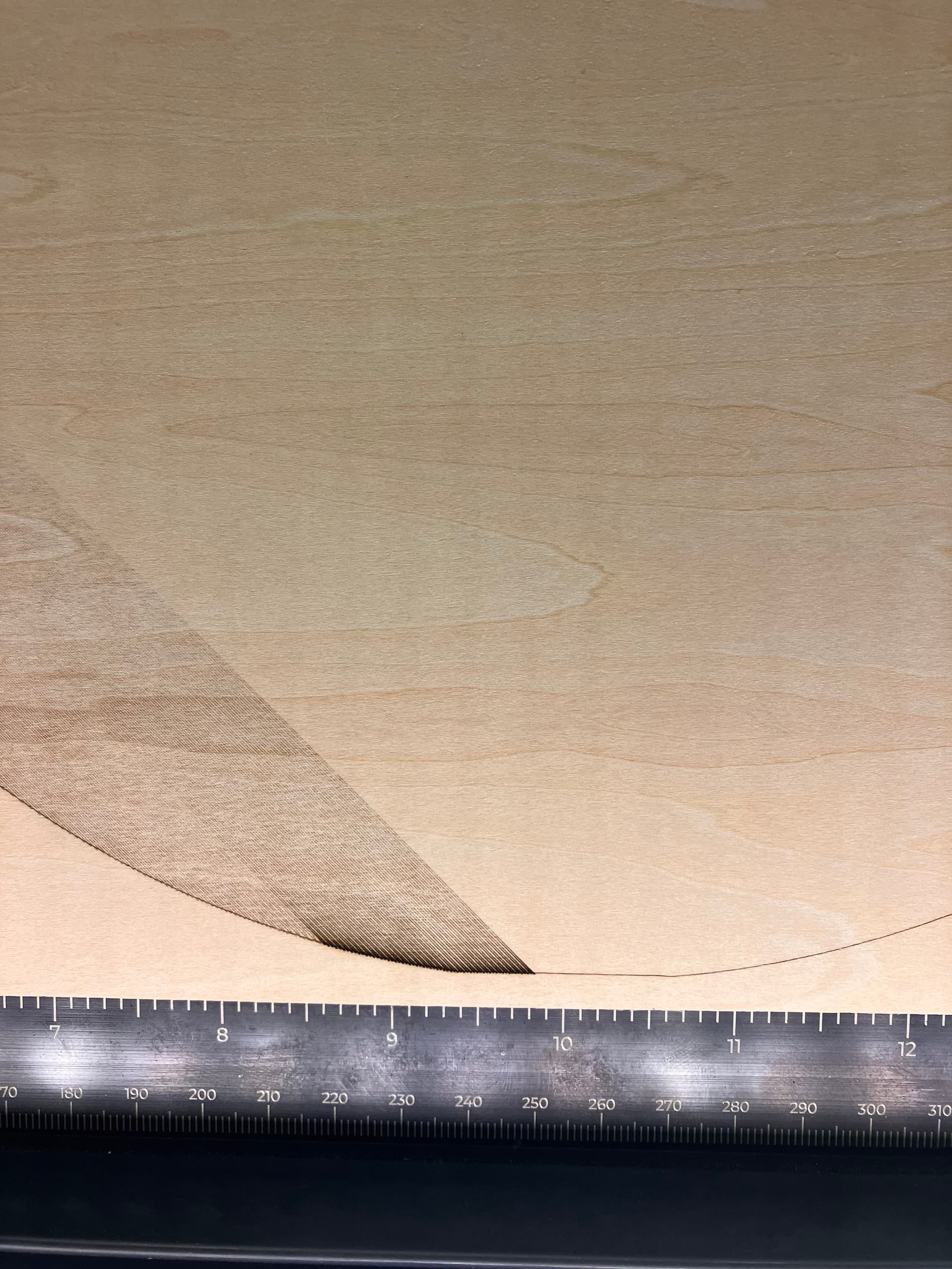

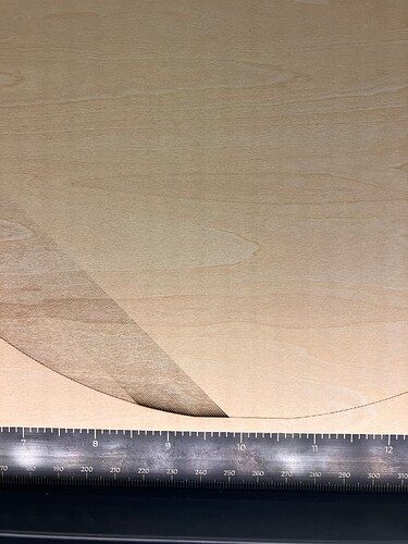

Another test:
You might not be able to. Those flat spots on the bottom are firmware limiting the travel. The 40w doesn’t have a full 12" of travel on Y because of the size of the module.
I reduced my Y to 295mm on the working area.
