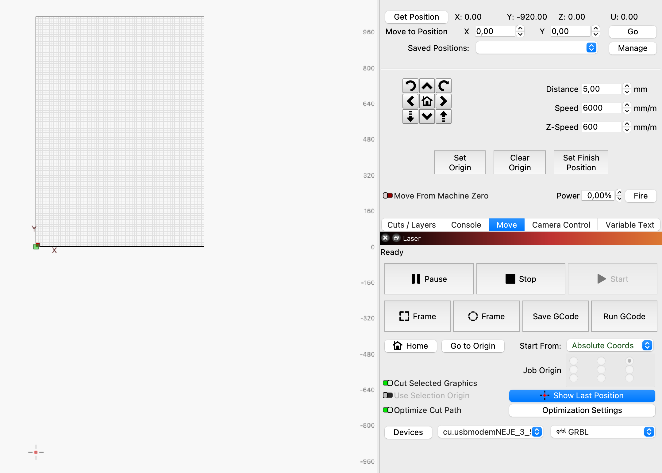

Yes thats correct: from where I’m standing with origin selected to bottom left X+ moves the laser to the right and Y+1 moves the laser away from me…
With the settings you suggest; after homing I get the a position of X:00 and Y:1030
Is that how it is supposed to be?
Thanks again.

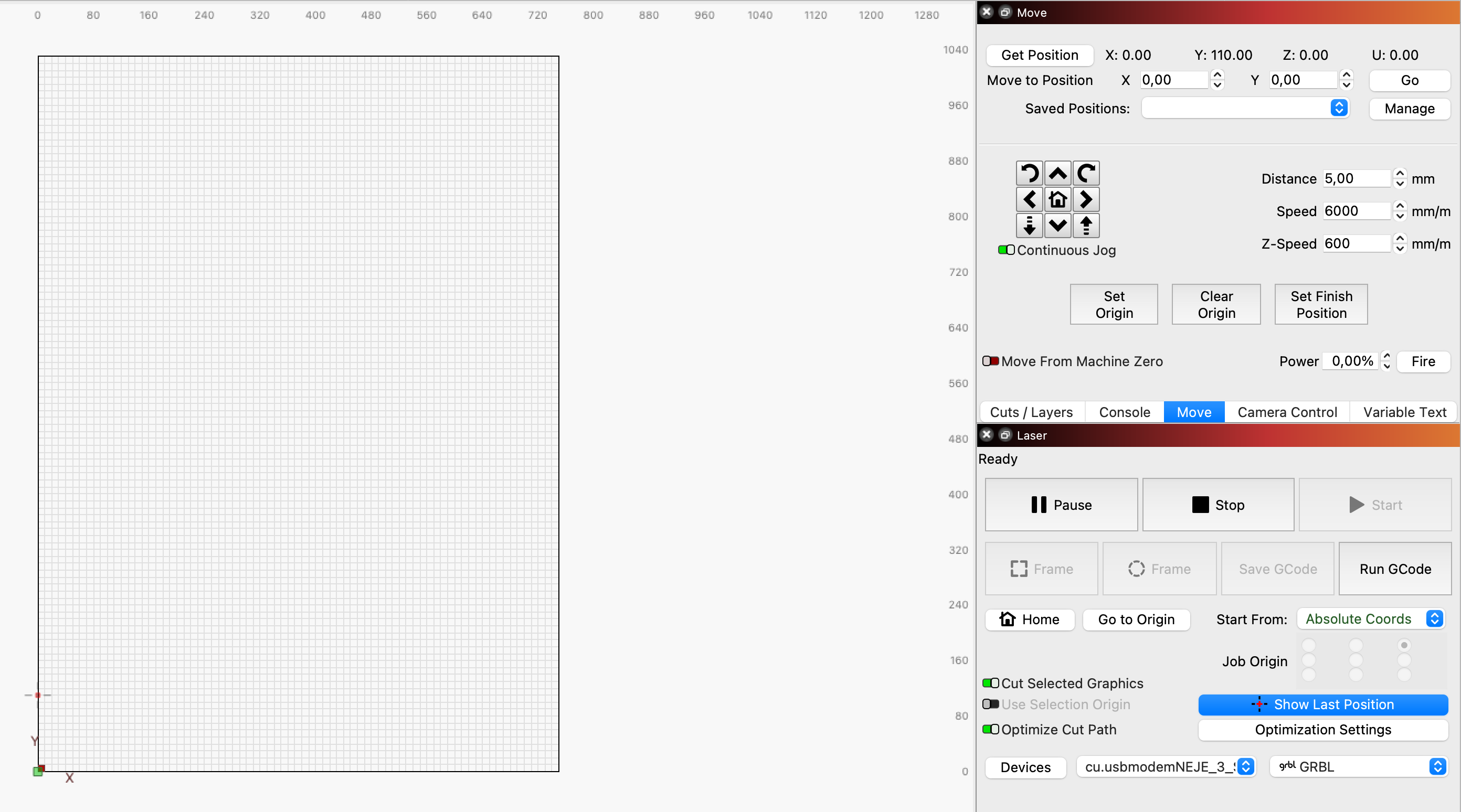

Okay I did, and now Im back to the original problem where after homing (still homes to the right corner) lightburn thinks the laser is at Y:110.
We have gone full circle, but now we know you are nearly done. You now have a +110mm offset in the Yaxis, right? I want to confirn that is not a stored offset, although I think we did this previously.
In the Console window, enter $# and post the results here. Please do not change anything or experiment.
Yup, Y is offset

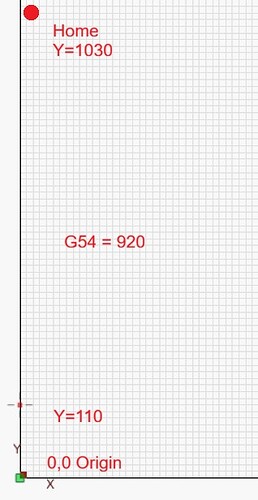

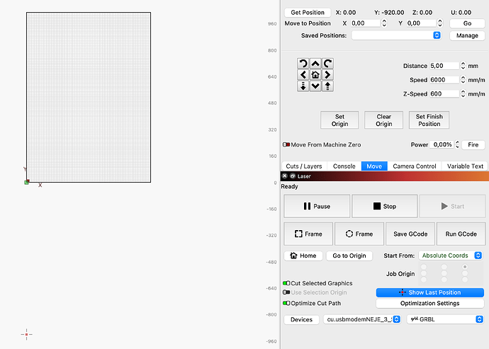

Look at the attached image and see if this makes sense:
In Console, enter G54 Y1030
The laser thinks it is at Y110. That is where it tells Lightburn it is located. If you add the 110 to the 930, then you are tellling the laser that X0 Y0 is in the location you want it to be.
This makes my machine go North, away from me, off it’s limits..
Try Y-1030 then…
Not understanding how adding 110 to the parameter makes it go in the wrong direction.
Not understanding that either.

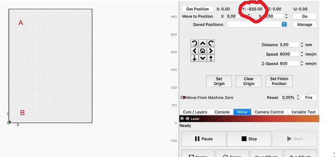

Entering G54 Y-1030 moves it the other direction, towards me. but it moved 110 to far, off its limit.
So I tried again entering G54 Y-920 instead, that moves the laser to the exact origin.
Oh and then this:

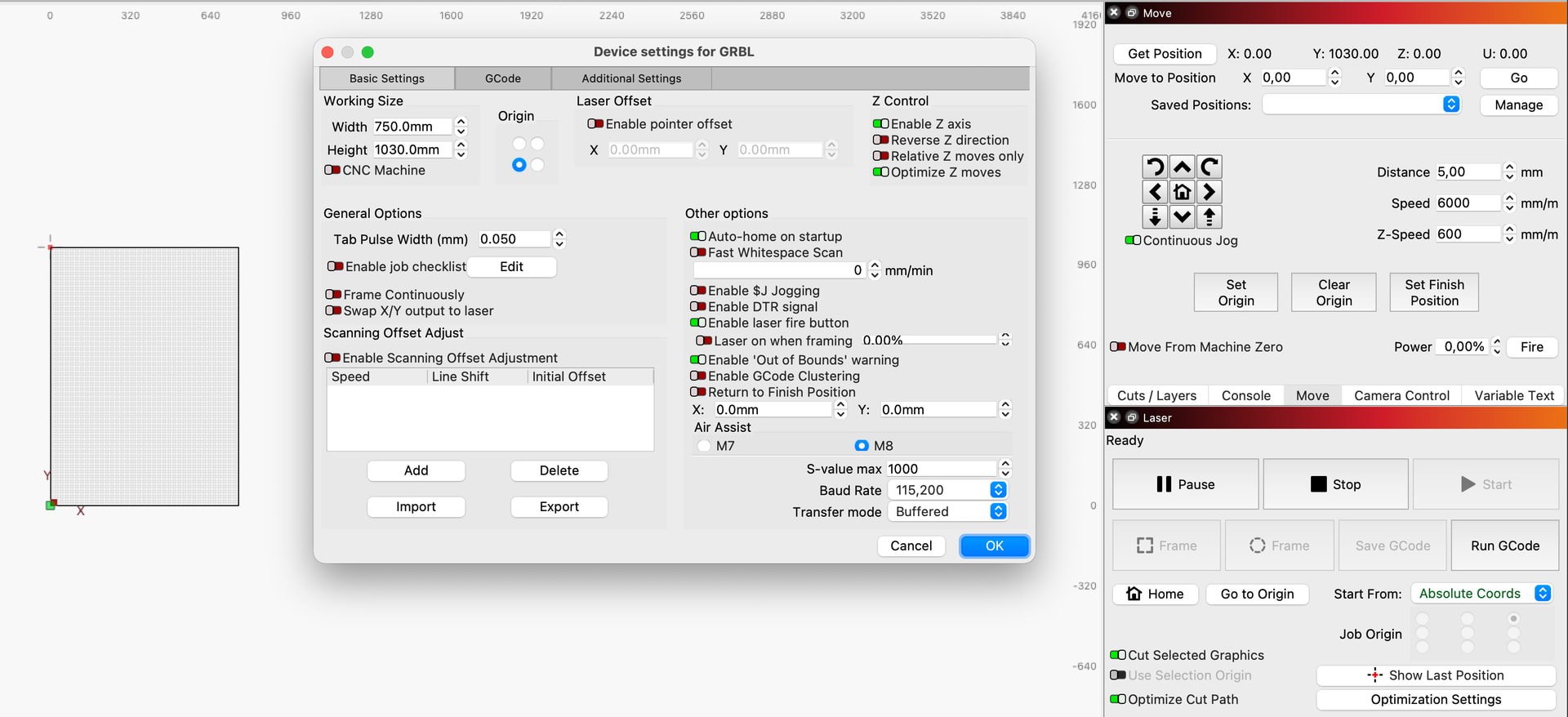

  1. Is your laser workarea 36”x30” or 42”x30”? NOT the frame size.
  2. $130 and $131 should be set only once, then not touched. They establish the workarea of the laser.
  3. When your laser is at the position shown (-920) in your Move window, where is it located in the machine, A or B?
I have a problem with that 1030 number when 920 seems to make things better. If Y-920 moves it to the “exact origin”, that suggests that is the correct G54 value.
If your laser does not Home at the 0,0 location, but Homes somewhere else, then you will not see X0, Y0 when it Homes. You will always see a Yaxis offset value because it will be located at an offset from 0,0.
Do a G54 Y-920 and and Home the machine. Then answer my questions #1 & #3 above. :nerd_face:
1: the workspace of my machine is: 1030mm x 750mm
2: ok
3:B
Yes I understand, when I home it moves to corner A. The feedback in Lightburn in the move window suggest Y:110 however…When it is actually at Y:1030
Also in my previous screenshot, you see the laser icon all the way at the bottom of the scrn, beyond the workarea of my laser…(920 beyond, that is…)
Yes, I saw that.
This would be Y=0 at that point. When you move it towards the Origin 0,0 point, the Machine coordinate will increase negatively to 920. Honestly, this suggests 920 is the correct Yaxis offset, not 1030. I do see it is advertised as 1030 when extended.

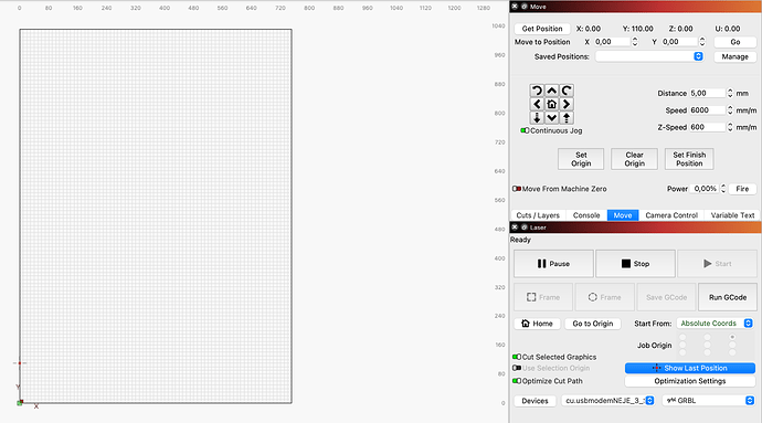

Btw after having done this and after homing the y-position in the move window is back at Y:130 again. Not sure if that G54 is a permanent comment or just a temporary move.
