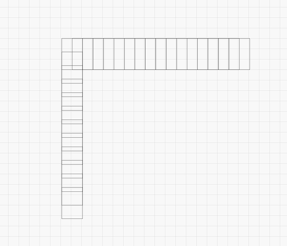

I don’t know if this also applies to the newer diode laser, but my old 5Watt diode laser has an elongated spot, with a ratio of about 2 to 3.
It was fairly self-explanatory that it is “easier” to cut in the Y direction, in my case.

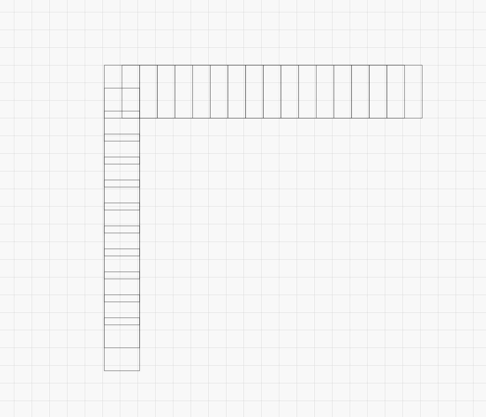

Hi there
Thanks for the visual explanation.
This does make sense, but is there a way to get around this and cut through cleanly like on the Y Axis?
Perhaps the laser focal distance?

No, unfortunately not, as far as I know. It has always surprised me that the orientation of the laser beam is so straight with X and Y, but it must be something design-related. If it was set to 45 degrees there would be some kind of compensation, but it is not optimal either.
However, I believe that the new multidiode laser heads are much better designed with a more round beam.
No. Just add another pass. Always do one pass more than necessary. This will also compensate for material inequalities.
