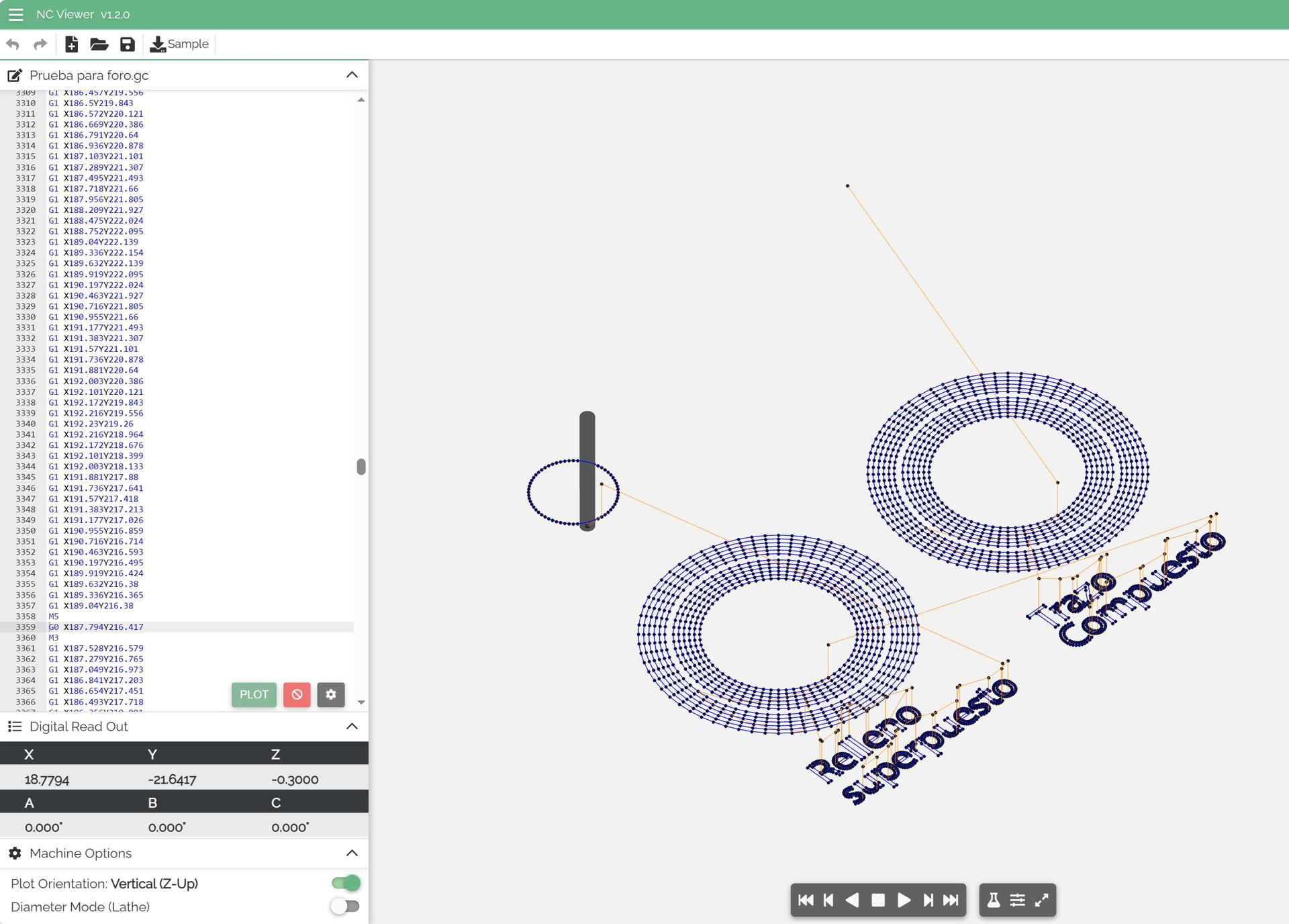

Hi everyone,
I’m running a modified Sculpfun S9 setup equipped with an MKS TS35-R V2.0 motherboard (GRBL) and a custom motorized Z-axis module. I am currently using a pen holder tool to use the machine as a drawing plotter.
The machine works great with simple text vectors and basic shapes. However, I’ve encountered an issue when processing complex compound vectors, specifically when using the **Offset Fill** layer mode.
**1. Missing Z-axis travel commands:**
On certain complex shapes, LightBurn omits the Z-axis lift commands altogether during travel moves between shapes.
When inspecting the generated G-code, after an `M5` (tool disable), LightBurn directly executes a rapid move `G0 X... Y...` without injecting the expected Z-up sequence (`G91` $\rightarrow$ `G0 Z3` $\rightarrow$ `G90`), followed by `M3` to resume drawing. Because the Z-axis remains down, the pen drags across the paper during the travel move and leaves unwanted lines.

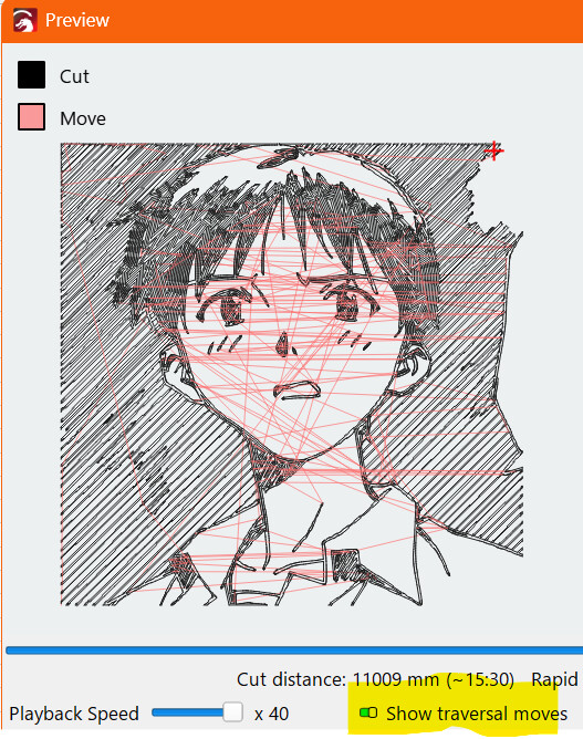

_(Interestingly, in LightBurn’s Preview window (`Alt + P`), these travel moves are often shown as red travel lines, but the actual exported G-code text lacks the Z-height instructions)._

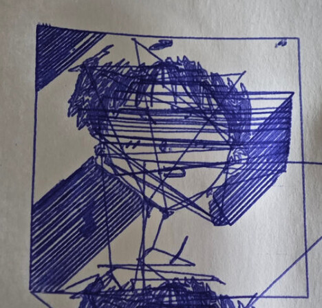

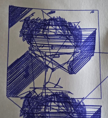

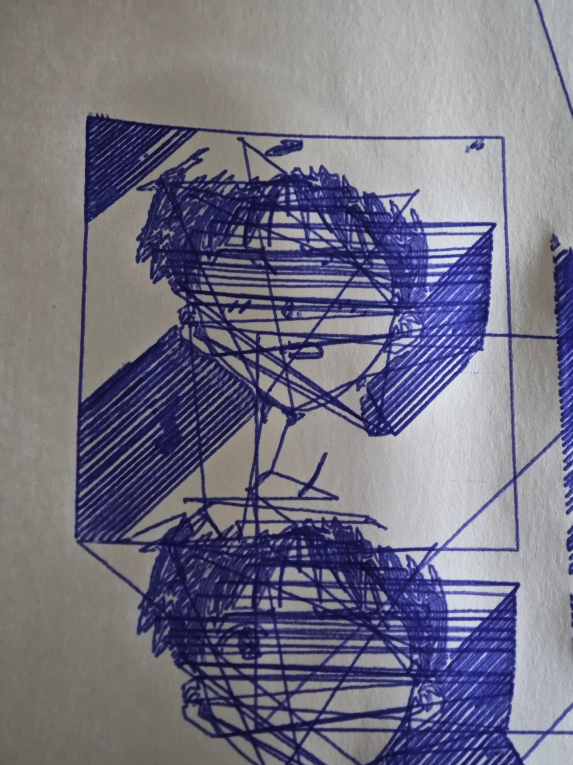

Archivo G-code:
[Nuevo a empezar.gc](https://forum.lightburnsoftware.com/uploads/short-url/8p84VFGkOu2XM9Kak8x916wDxnn.gc) (132,6 KB)
Trabajo sin modificar g-code

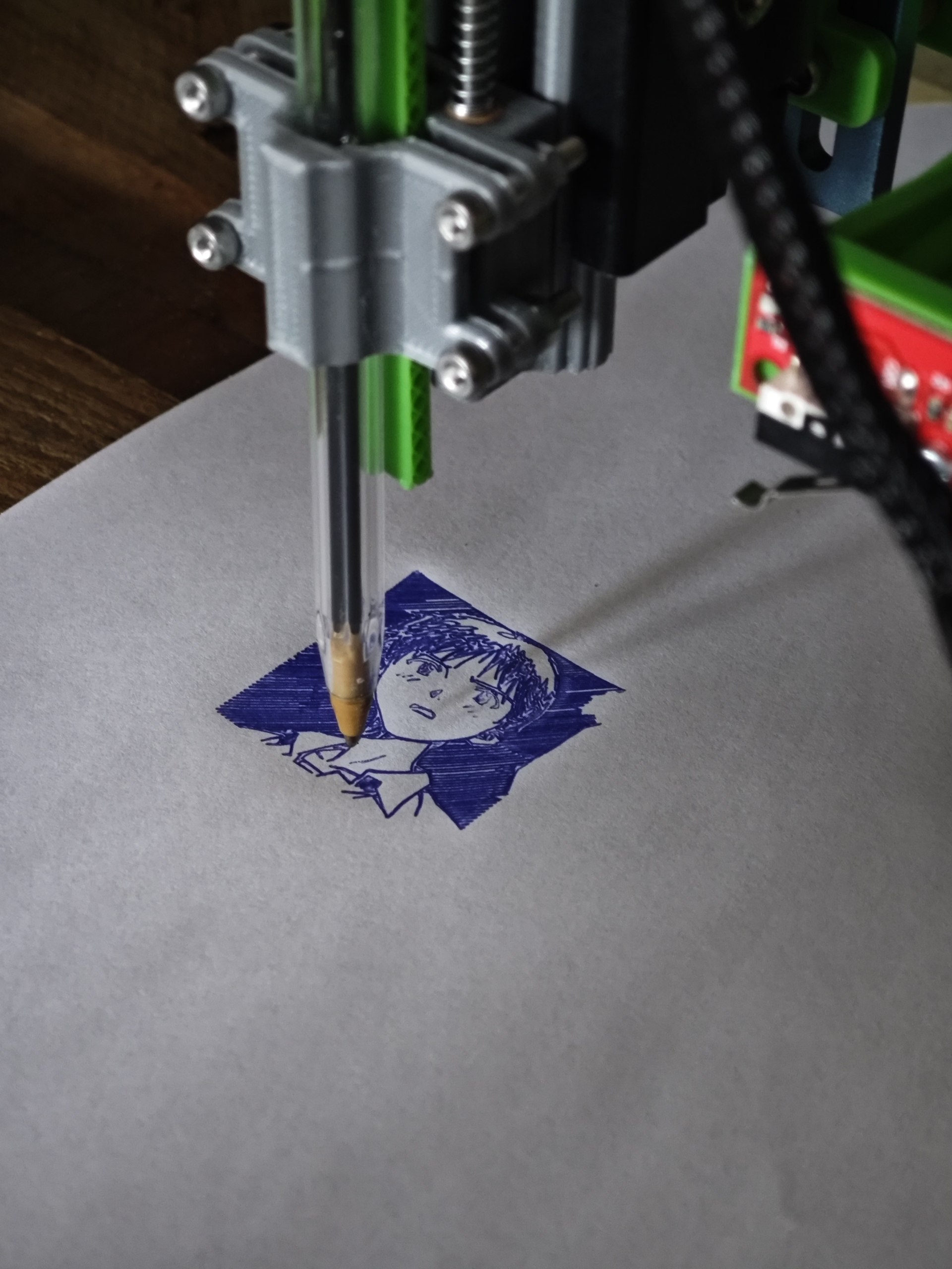

 ![photo_2026-07-30_20-38-25](https://forum.lightburnsoftware.com/uploads/default/original/3X/6/4/6484336a38ab10c9aefa58f8a78bd867c2713de7.jpeg)
Trabajo con G-code arreglado.
 ![photo_2026-07-30_20-38-32](https://forum.lightburnsoftware.com/uploads/default/original/3X/5/a/5a1bbb5353c93d7b8eadba471e60e3723e7fe6a5.jpeg)

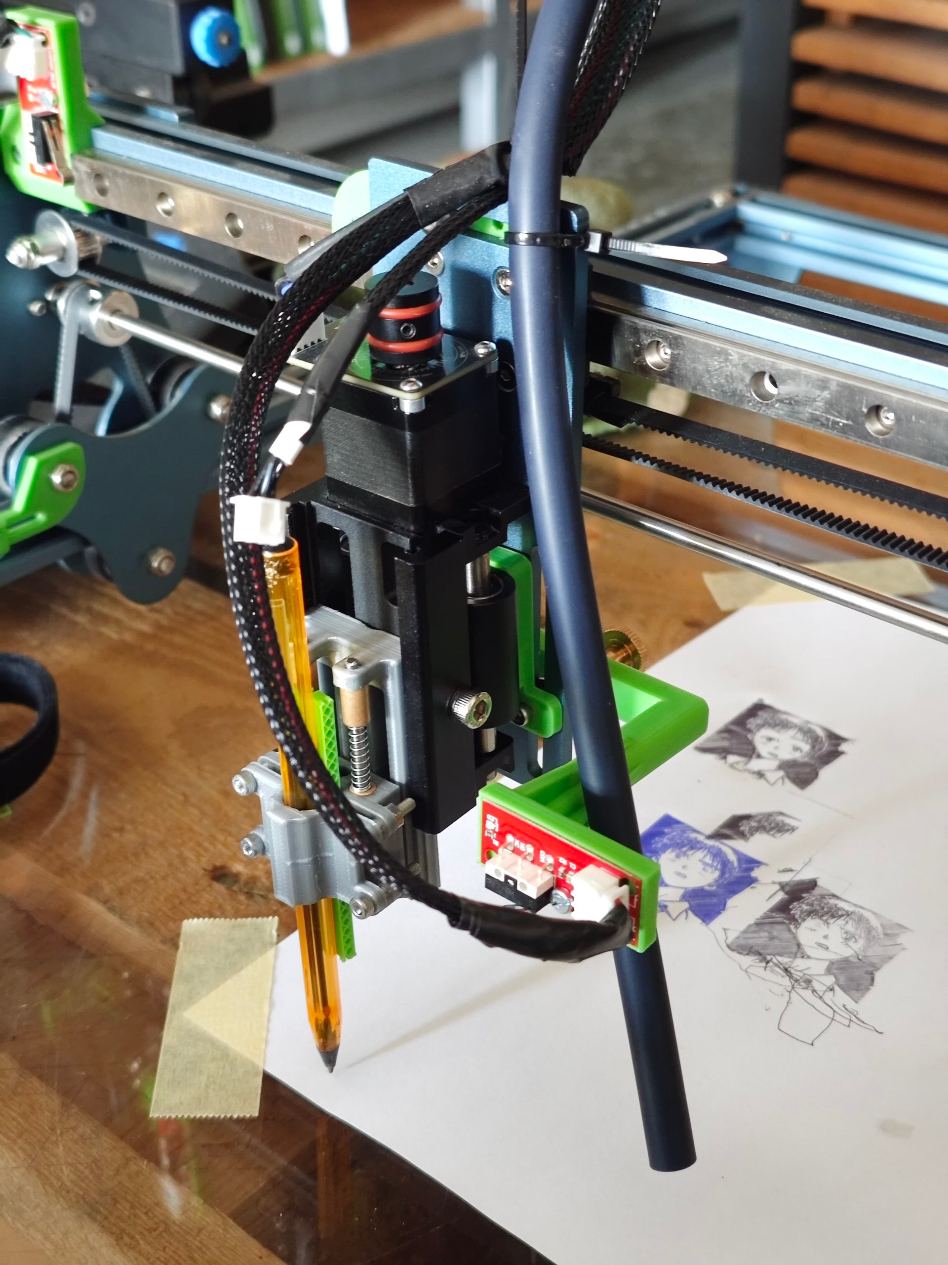

Thanks for your reply, but I think there might be a misunderstanding of my hardware setup.
I am not using a PWM signal, RC servo, or $31 laser power settings to control the pen height. The laser head is completely disconnected.
My machine has a true 3-axis motorized setup:
I have a physical motorized Z-axis driven by a stepper motor on the board’s Z driver.
The pen is mounted on this motorized Z carriage.
LightBurn is configured with a GRBL profile with Z-axis enabled, so it physically moves the Z stepper motor up and down using standard G0 Z… commands.
Most of the time, this works as intended: LightBurn outputs G0 Z3 (or relative Z moves) to physically lift the stepper motor during travel moves, and lowers it to draw.
The issue is that on certain complex “Offset Fill” shapes, LightBurn fails to generate the physical Z movement command altogether for specific travel moves. The physical Z-stepper motor stays down simply because LightBurn omitted the Z command line from the exported G-code at those specific junctions, even though Z-axis motion is enabled in the device settings.
That is why I had to manually edit the G-code using regex in a text editor to inject the missing Z-stepper lift commands.
Hope this clarifies my setup! Any idea why the G-code generator would skip Z stepper commands on these specific vector paths?

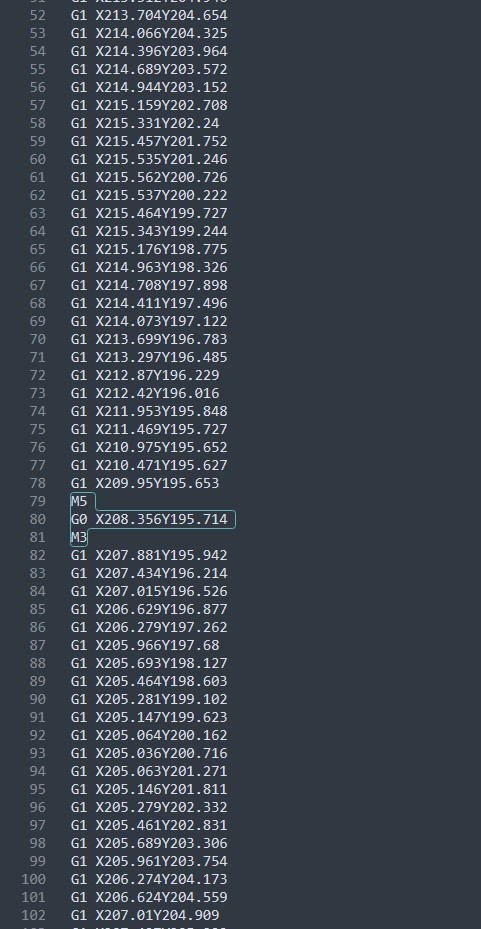

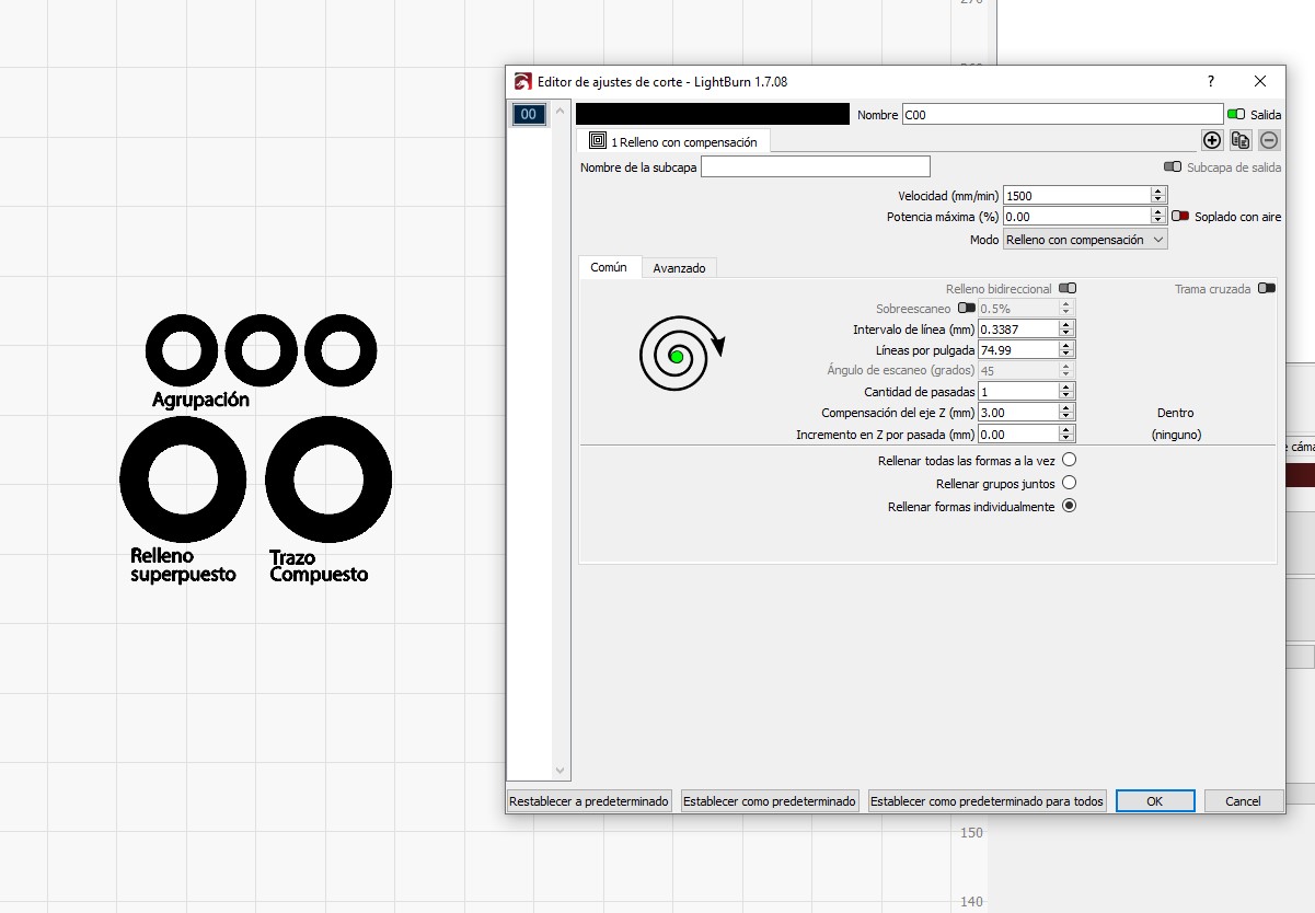

**I found the exact root cause of this behavior in LightBurn v1.7.08.**
The issue isn’t just a general optimization choice; it is a **path-planning bug when processing complex compound vectors with internal negative space (voids, cutouts, or white space) using Offset Fill**.
When LightBurn generates the Offset Fill pattern for a complex shape containing hollow areas or internal voids, it needs to move the tool across those blank zones to continue filling another section of the vector.
However, because LightBurn treats the entire compound path as “one single shape”, **it fails to recognize that the `G0` travel move is crossing over an area that must remain completely blank**.
As a result:
1. It turns off the tool (`M5`), moves directly across the internal white space with `G0`, and turns it back on (`M3`).
2. It **omits the physical `G0 Z...` lift commands** because it assumes it is still operating within the boundaries of the same object.
3. Because the Z-axis is never raised, a physical tool (like a pen or drag knife) gets dragged right through the blank/negative space, leaving unwanted lines and ruining the drawing.

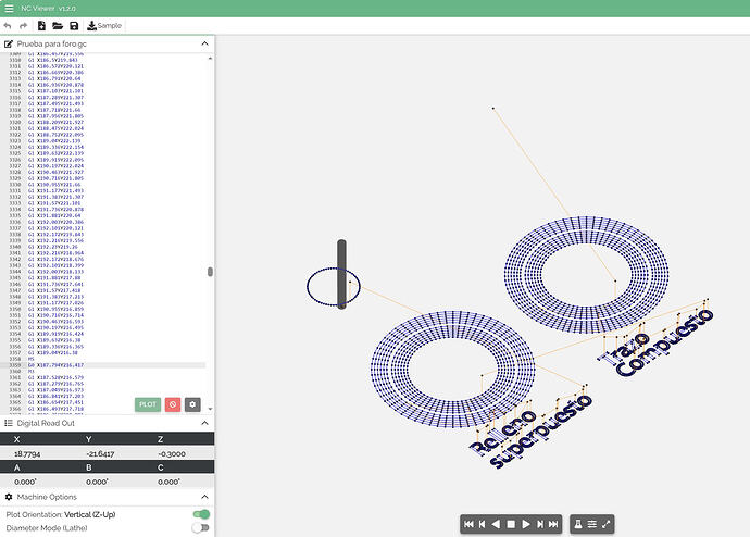

Here is the exact snippet generated over a blank area inside a compound shape:
G-Code
```auto
Line 79: M5
Line 80: G0 X208.356 Y195.714 ; Moves across blank space, but Z stays DOWN!
Line 81: M3
Manually injecting Z-up and Z-down sequences (`G91 / G0 Z3 / G90`) around these `M5 -> G0 -> M3` travel moves completely fixes the issue, proving the physical hardware and Z-axis setup are 100% correct.

 ![Captura de pantalla 2026-07-31 083834](https://forum.lightburnsoftware.com/uploads/default/original/3X/9/f/9f8414c028460b1371048dad0817aeb30368acd6.jpeg)
 ![Captura de pantalla 2026-07-31 084145](https://forum.lightburnsoftware.com/uploads/default/original/3X/f/3/f3b07cb5a3491c5bf0d3d4bf2b4de94d75a04284.jpeg)
> **[Watch video\_2026-07-31\_08-46-14 | Streamable](https://streamable.com/6ryzm5)**
> Watch "video\_2026-07-31\_08-46-14" on Streamable.
As shown in the screenshot, simple geometry is handled perfectly by LightBurn out of the box without any issues.
The core problem lies in how **Offset Fill** calculates toolpaths in a concentric pattern. When processing complex **compound paths** , these concentric loops force travel moves across blank/negative space. Because LightBurn treats the compound path as a single object, when it jumps across these empty zones, it executes a `G0` travel move without issuing a Z-axis lift command—causing the physical pen to drag directly across areas that should remain completely clean.
 ![photo_2026-07-31_08-46-34](https://forum.lightburnsoftware.com/uploads/default/original/3X/8/b/8bd7176eed8fb503730541a53b78d60a2ee1380b.jpeg)
Technically speaking, `M3` and `M5` commands are completely redundant throughout a pen plotter job. Since there is no laser beam or spindle to toggle, `M3` only needs to be called once at the very start of the file, and pen engagement is controlled 100% by physical Z-axis motion. However, having LightBurn continuously output `M5` (tool disable) and `M3` (tool enable) before and after travel moves actually works in our favor.
These redundant M-codes act as clear structural delimiters in the raw text file. Because LightBurn inserts `M5` right before a `G0` travel move and `M3` right before resuming drawing, it makes it extremely easy to target those exact points using a Regex search-and-replace in a text editor (like Sublime Text) to inject the missing relative Z-lift commands (`G91 / G0 Z3 / G90`).

 ![Captura de pantalla 2026-07-31 083748](https://forum.lightburnsoftware.com/uploads/default/original/3X/0/7/07c21488e4b1bd09264f701ecfca9dcce3e691fe.jpeg)

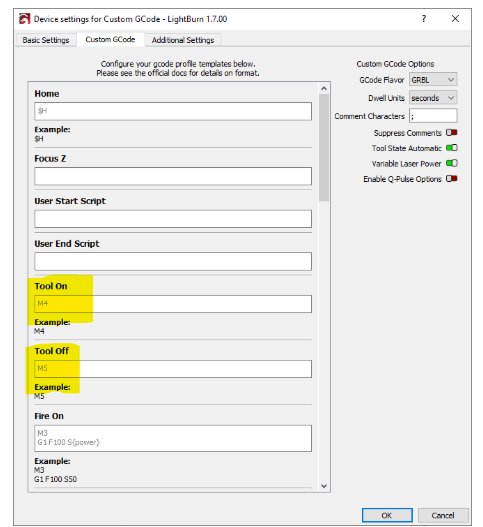

 ![image](https://forum.lightburnsoftware.com/uploads/default/original/3X/5/0/505d6be79f1da43f80207e525ddc790e3b972580.png)
and test.
Also post the plotter Device and the .lbrn2 file of this pic:
 ![image](https://forum.lightburnsoftware.com/uploads/default/original/3X/d/1/d1e1ebc2faeae9accea2e6661cf0b2dd38f939e3.jpeg)
> **[Device Settings: Custom GCode - LightBurn User Guide](https://docs.lightburnsoftware.com/1.7/Reference/DeviceSettings/CustomGCode/)**
> The Custom GCode tab of LightBurn's Device Settings allows for advanced GCode customization when using the Custom GCode device type.
<div class="post-metadata">
**Author:** ![Tadeus](https://forum.lightburnsoftware.com/user_avatar/forum.lightburnsoftware.com/tadeus/32/70089_2.png) [@Tadeus](https://forum.lightburnsoftware.com/u/Tadeus)\
**Post date:** [July 31, 2026, 4:26pm UTC](https://forum.lightburnsoftware.com/t/z-axis-lift-missing-on-complex-offset-fill-shapes-g-code-import-issue-with-pen-plotter-setup/191539/10 "2026-07-31T16:26:03Z")
</div>
**That did the trick! Thank you so much for pointing me back to this.**
I tested your suggestion by adding the relative Z-lift commands directly into the **Custom GCode** device settings in LightBurn, and it completely solved the issue.
Here is the exact setup I entered into the Device Settings (as shown in the image below):
**Tool On :**
G-Code
```auto
G91
G0 Z-3
G90
M3
**Tool Off :**
G-Code
```auto
G91
M5
G0 Z3
G90
**Why this makes a huge difference:** This is **so much more convenient** than exporting the raw file and running regex search-and-replace scripts in Sublime Text every single time. Now I can just click “Start” directly in LightBurn and the pen lifts automatically.

I´m glad this worked for you.
Lightburn is a very solid piece of software in which most of the features, especially the most basic ones ( like offset-fill), are already quite mature.
What is happening with your file:
Checking the preview with **Show traversal moves** enabled
 ![image](https://forum.lightburnsoftware.com/uploads/default/original/3X/f/5/f541a7b5e19669c36cc92b0e7571c00eb0358267.jpeg). ![image](https://forum.lightburnsoftware.com/uploads/default/original/3X/7/9/7947a04d61361d899540bcc6e89fe393471ece69.jpeg)
If you were using a laser this will be the cause:
> [@Tadeus](#):
> $32=0
> **[Laser Keeps Firing During Travel Moves - LightBurn User Guide](https://docs.lightburnsoftware.com/latest/Troubleshooting/JobQuality/MovesAreBurned/)**
> Troubleshooting output that doesn't look like you expected.
As the pen is “always on” the only option is to “turn it on-off” at request, which has already been done with a Custom GCode,
Keep the working Plotter device as is and do a duplicate if you want /need to test something more:
> **[Devices Context Menu - Devices - LightBurn User Guide](https://docs.lightburnsoftware.com/1.7/Reference/Devices/#devices-context-menu)**
> The Devices window shows all the devices you've added to LightBurn. Use this window to add new devices, Import and Export devices, and manage existing devices.
